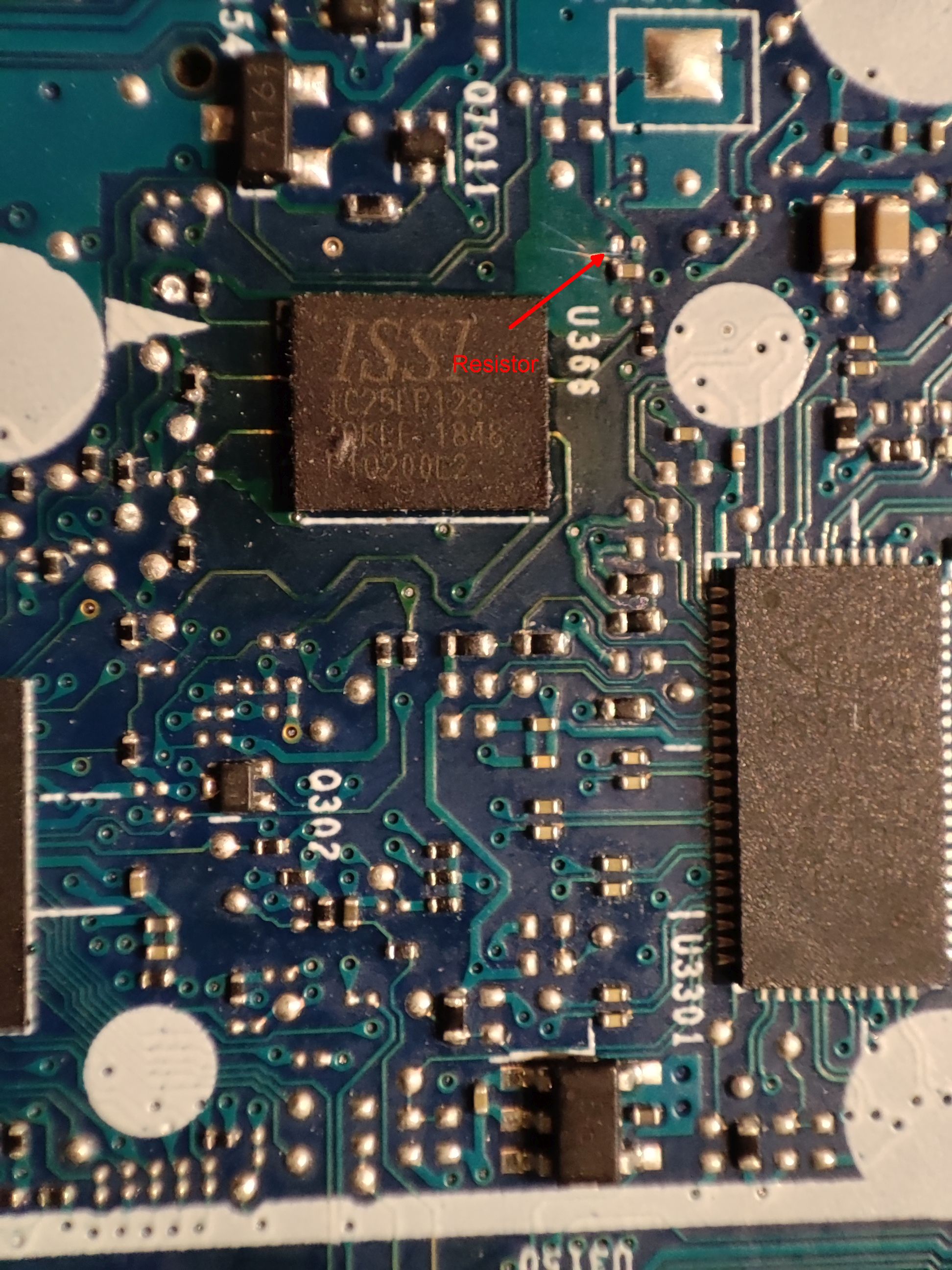

    Elitebook 850 G6 (6050A3022501-MB-A01(A1);SN:5CG941023G)U365 Soldering Error
    Helló!
    I lost a resistor next to U365 due to a soldering error. Does anyone know what value of resistance was there?
    Thx!

    Check the schematic https://www.badcaps.net/forum/showthread.php?t=108193 U366

      Re: Elitebook 850 G6 (6050A3022501-MB-A01(A1);SN:5CG941023G)U365 Soldering Error
      Thank you very much. This was fast.
