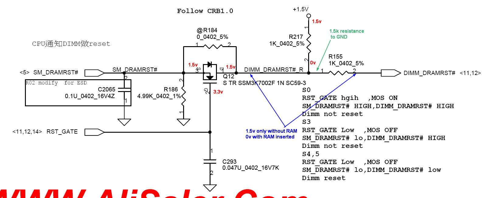

    Hi
    I openet new topic becouse now diferent problem to this board
    Board power On , and without Ram module has CPU_CORE 1.2V on both phases
    But when insert Ram memory in slot then board has power On with cpu_core and restart and once again core is 1.20v and then drop and no more cpu_core present.
    At this point I can see also on RAM that DIMM_DRAMRST# is missing (but think this should not affect cpu_core missing)
    All voltage is OK on RAM except [pin-30]
    Like something other couse problem,but this happend only when insert memory
    Any help?

    Re: La-7912p second board
    The mb tries to go higher up in sequence(S0 rails) with ram inserted but when ram is not inserted this sequence is interrupted-so it wont reboot and stay on.
    Problem is very likely related to SIO.
