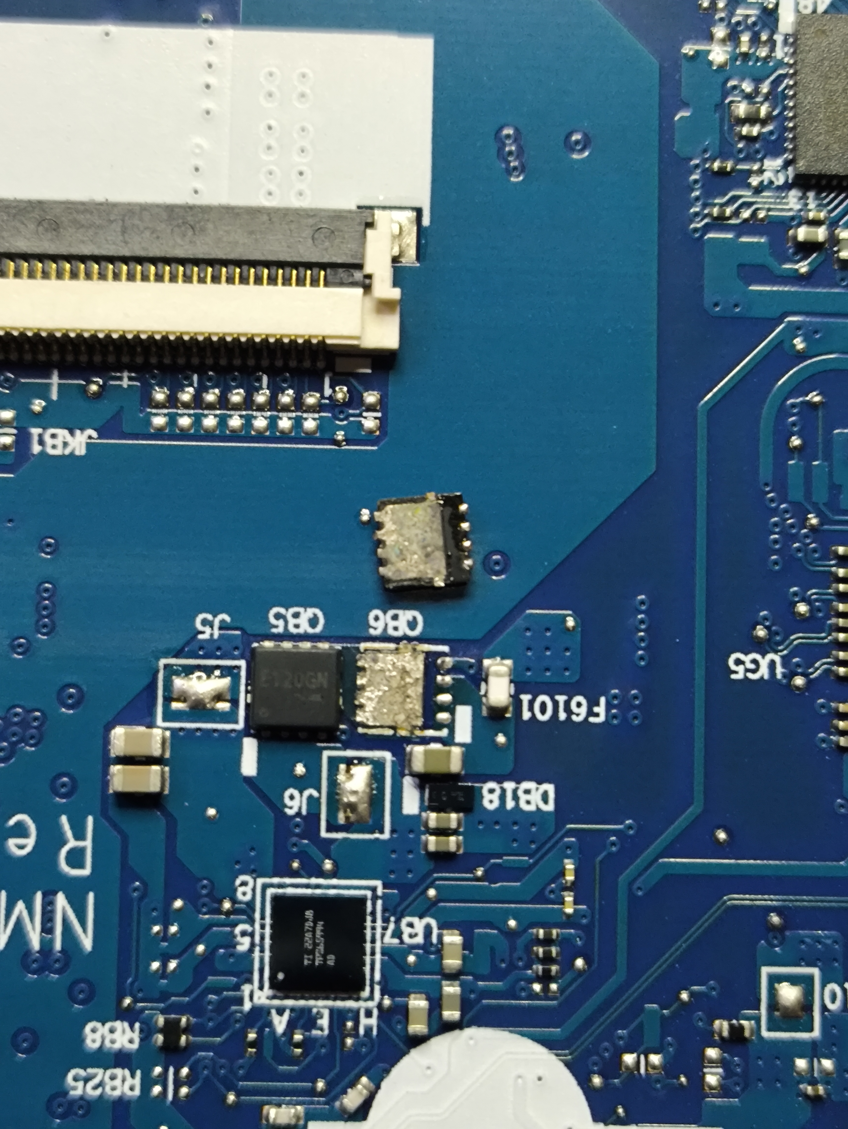

    I am currently working on the Lenovo ThinkPad E14 Gen 2 with a GE4B0 motherboard.
    Issue: The laptop runs on battery power, but it fails to recognize the charger. The LED1 indicator does not illuminate in white or orange when the charger is connected.
    My investigation:
    1. LB4709 and LB4708 both register 20V.
    2. UE1:
    Pin 34 ACIN_LED measures 0V at R31.
    Pin 11 VCC_LPC_ESPI registers 0.27V.
    3. +3VL_EC at R42532 and various other locations, following the schematics, measures 1.7V.
    Charging IC: BQ25710
    Measurements without battery connected only charger.
    The Boardview and Schematics are attached. But from very similar boards.

    What voltage do you have PU3 pin 15 ? PJ3/PJ4 ?

        • Techtiger

          didn't ask you to test RE135 signal. This is an input signal for the last stage of the power sequence. PJ3 is a test pad to check if your +3VALW is working or not, and PJ4 is a test pad to check if your +5VALW is working or not

            if PU3 TPS5139RJER is not producing LDO voltage on pin 15 (0V), then test the supply for the IC on any of pins 2, 3, 4, or 5

              What voltage do you get on PL4, PQ4, any pin 2, 3, 4, or 10? let us know

                Faulty Motherboard PJ3 1.8V and PJ4 0v
                On Working Motherboard: PJ3 3.36v and PJ4 5v

                  Faulty Motherboard:
                  1 - 1.58v
                  2 to 5 - 1.5v
                  1 - 8v
                  2 to 5 - 9.24v
                  • Ado02
                    • Jul 2021
                    • 100
                    • United Kingdom
                    Re: Lenovo ThinkPad E14 Gen 2 / GE4B0 / Not Charging
                    Faulty Motherboard
                    PQ4 2 to 4 - 1.50v
                    PL4 - 0v
                    PQ4 2 to 4 - 9.24v
                    PL4 - 9.28v
                      I think the VINT20_IN is missing.
                      F6101 1.5V is going up and down a little. If I am correct this should be 20V
                      • mon2
                        • Dec 2019
                        • 14984
                        Check the voltage to ground on each side of the fuse F6101. Is it stable on one side?

                            It is too low. Remove all power. Meter in resistance mode.
                            Measure the resistance to ground on each side of this fuse. Post each measurement.

                                Follow simple basics:
                                01.Check resistance between
                                Source-Gate
                                Source-Drain
                                Gate-Drain
                                of both N-fets PB5/6

                                  QB6
                                  1-2-3 & 5-6-7-8 / 3.67 Mohms
                                  1-2-4 & 4 / 4.00 Mohms
                                  4 & 5-6-7-8 / At this point I noticed that the MOSFET started to lift away from the motherboard. So, I can only think it's shorted, and the solder has given way.
                                  It's an E120GN Mosfet - I have a few other Lenovo motherboards around like 17812-1 - but I can't seem to find the same one. Any suggestions?

                                    Solved:
                                    Replaced QB6 AON7466 - found the same mosfet on another Lenovo motherboard and the charging is restored.
                                    Thank you for your help...
