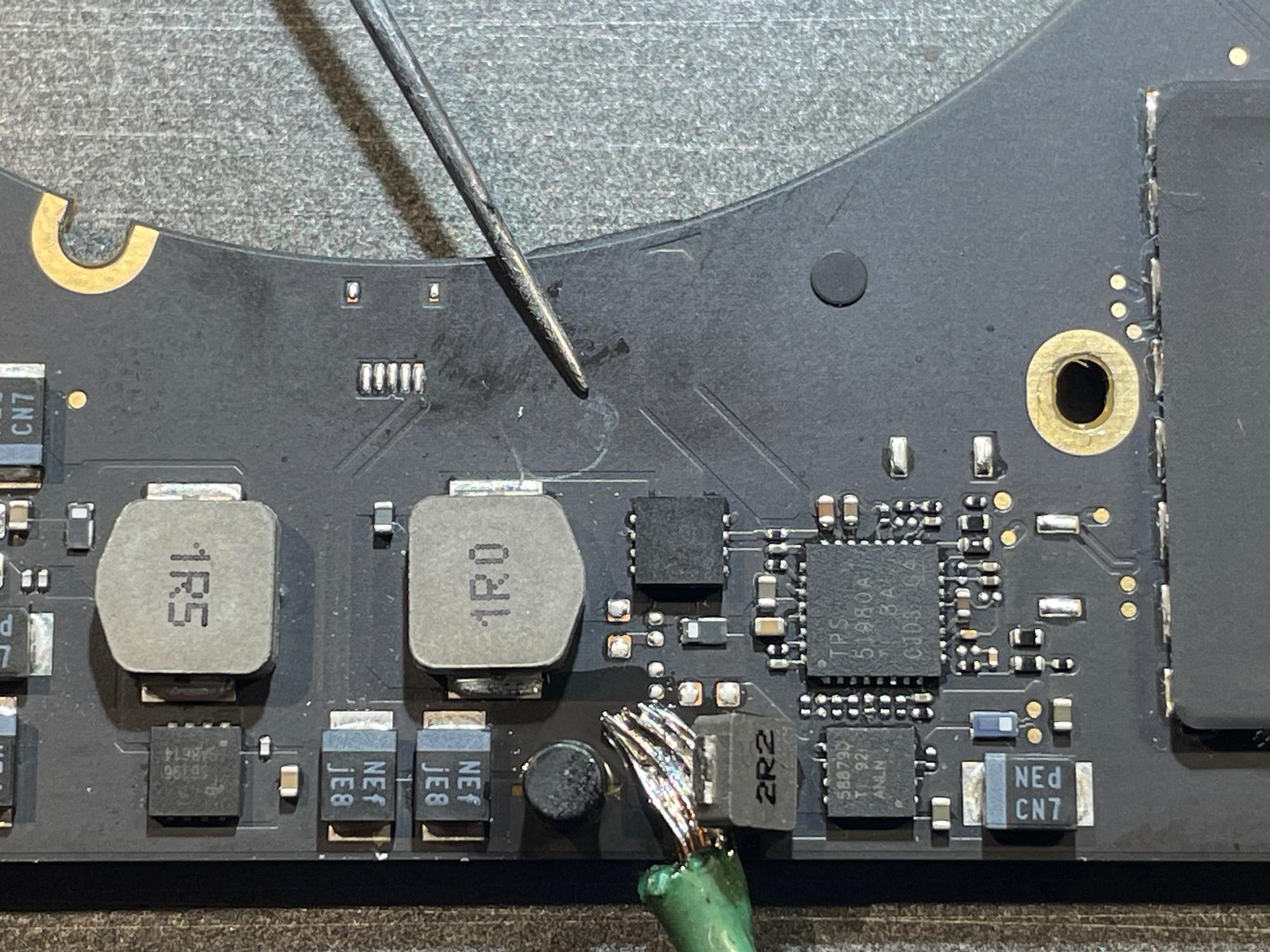

                Lifted L7600 load side. Load side was shorted to ground.
                Injected 1V on load side and set current limit to 4.9Amps. Read about 0.6V at injection point and drew about 2.3 amps.
                After about 10 minutes the only place that got to 135 degrees F was an empty spot midway between L7660 and U7660 about 1/4" toward fan cutout. No components at that location on either side of board.
                However, L7660 itself got burning hot to the touch although the infra red temperature gauge only showed it to be about 96 degrees. Voltage to ground at both side of L7660 was 0 volts. Neither side of L7660 was shorted to ground or to L7600.
                Could there be an internal short to ground in the vicinity of L7660 and U7660?
                There is a path for PP5V_G3S to the no-stuff fan connector near that location that could reasonably be assumed to run under that empty location on the board. Measured all of the unused fan connector pads and they were at 0 volts to ground.
                The PPBUS_G3H capacitors got very slightly warm. Not sure why they drew power, the board was naked on the bench with no power connected.
                Any suggestions?

                  The attached photo shows the warm spot at the tip of the probe. L7660 and the no-stuff fan connector (I presume that is what the pad is for) are also shown.
                  • mon2
                    • Dec 2019
                    • 14256
                    Re: 820-01814 Won't power on, PP5V_G3S shorted
                    To confirm, the injection is on the other side of the inductor L7660 so the inductor is in the path of the short? If yes, inject on the other side. The inductor is a large length of wire so it will heat up due to the hard short.
                    Test again and see who heats up (without L7660 in the path).

                      Closer examination of the traces to the fan connector pin 1 shows PP5V_G3S not going under the warm/un-occuppied area of the board. It passes to the left of L7660 so I'm not sure why that spot got warm. That leaves the question as to why did L7660 get so hot?
                      • barry101
                        • Aug 2019
                        • 61
                        The injection point was at the output of L7600, not the input to L7660. That's why I don't understand why L7660 go hot. Please the photo I attached to the previous post.

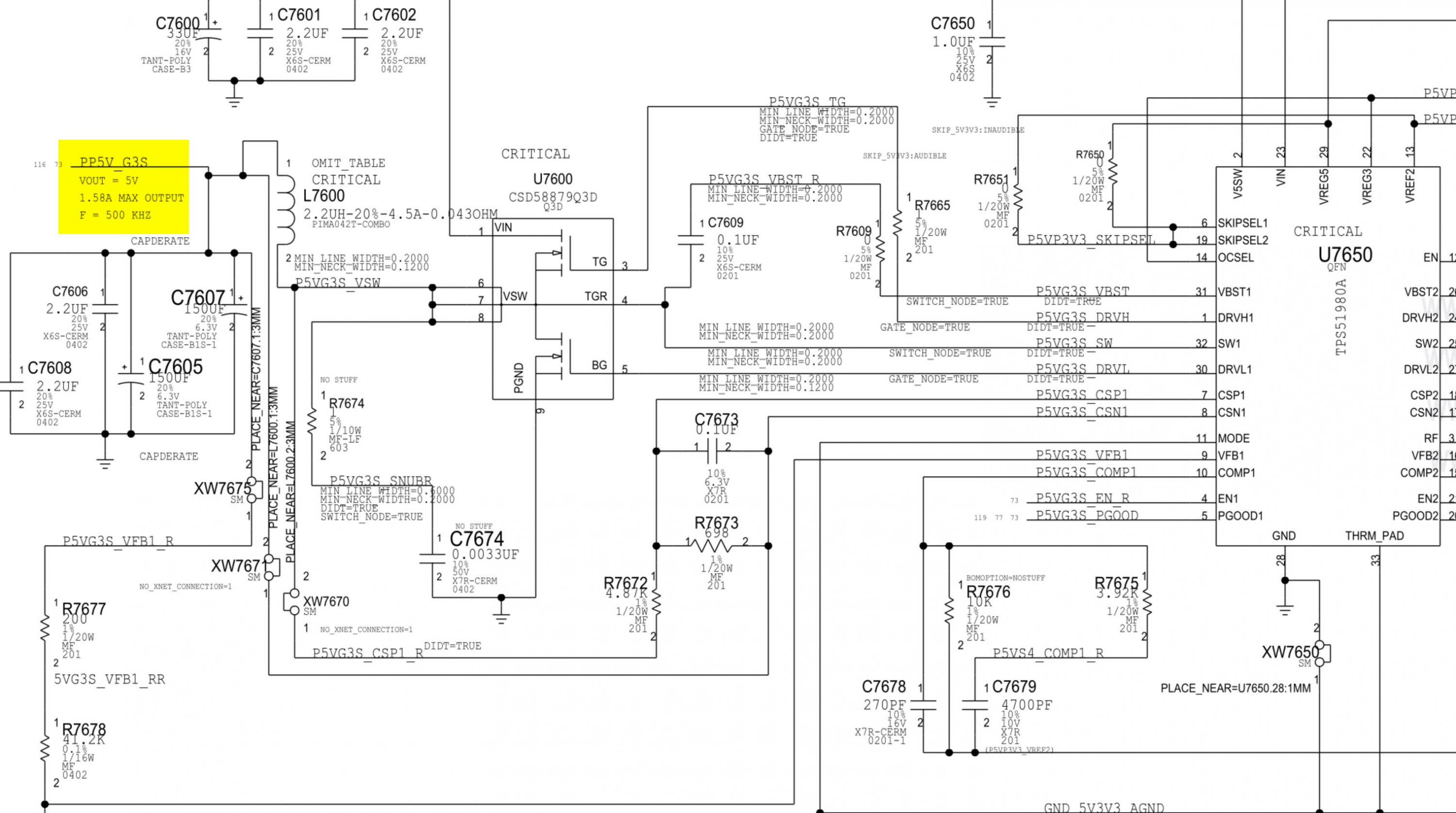

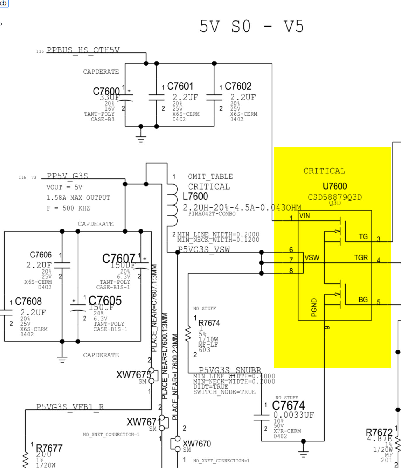

                              See attached. Remove all power / no battery. Meter in resistance mode.
                              Measure the resistance of the dual mosfet @ U7600.
                              Measure:
                              source & drain
                              source & gate
                              gate & drain
                              Check both mosfets inside U7600. Post the measurements.
                              • barry101
                                • Aug 2019
                                • 61
                                Here are the requested resistance readings with L7600 load side lifted:
                                UPPER MOSFET:
                                SOURCE TO DRAIN (PIN 4 TO PIN 1): 6.5K RISING TO ABOUT 10K AND STILL GOING UP
                                SOURCE TO GATE (PIN 4 TO PIN 3): 90K
                                GATE TO DRAIN (PIN 3 TO PIN 1): 100K
                                LOWER MOSFET:
                                SOURCE TO DRAIN (PIN 4 TO PIN 9): 5.6K
                                SOURCE TO GATE (PIN 4 TO PIN 5): 93K
                                GATE TO DRAIN (PIN 5 TO PIN 9): 88K
                                Does U7600 matter since the short is on the load side of L7600?
                                  To me, the resistance checks on this mosfet look to be too low.
                                  reference:
                                  https://electronicsbeliever.com/how-...-is-defective/
                                  Perform the same resistance check @ U7660 (dual mosfet).
                                  Concern is why voltage injection @ L7600 is causing inductor L7660 to heat up.
                                  Be sure that you are injecting the voltage @ L7600, pin #1 (downstream / consumer) side of the inductor.
                                  Confirm again the resistance to ground @ L7660.
                                        U7650 = TPS part is notorius for failures. Louis mentions this in a few of his videos. If you have the tools, consider to carefully flux and remove this component to test the theory of the short. Keep the air flow as low as possible or protect the nearby SMD parts so they do not go flying.
                                        Take a pic of the topside of this part for the pin #1 orientation.
                                        Before proceeding, remove all power, measure the resistance between L7600, pin #1 = PP5V_G3S to PPBUS_HS_OTH5V.
                                        Also test,
                                        L7600 (pin #1) to PP3V3_G3H_T.
