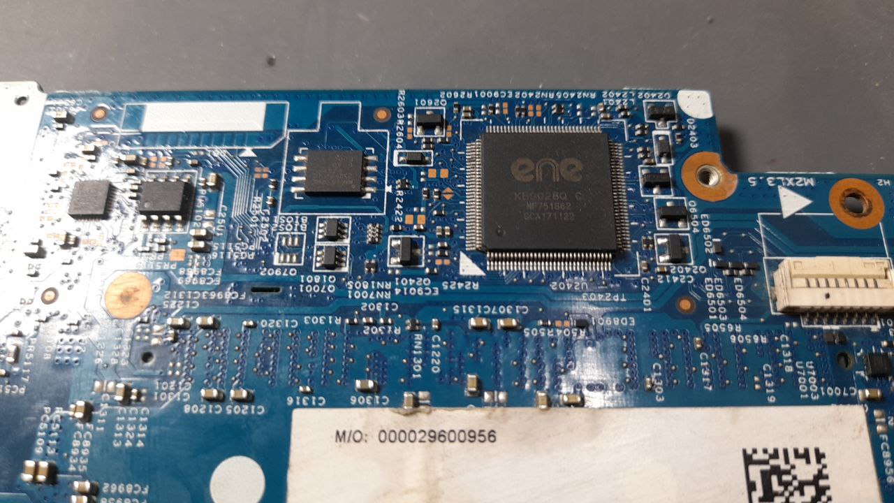

How to program like bios ic ?

    If you mean the ene KB9028 chip with a dedicated programmer: Vertyanov SUCCESSOR,RT809H,SVOD4. You might even be able to flash it with a CH341A, its been mentioned before on the forum.
