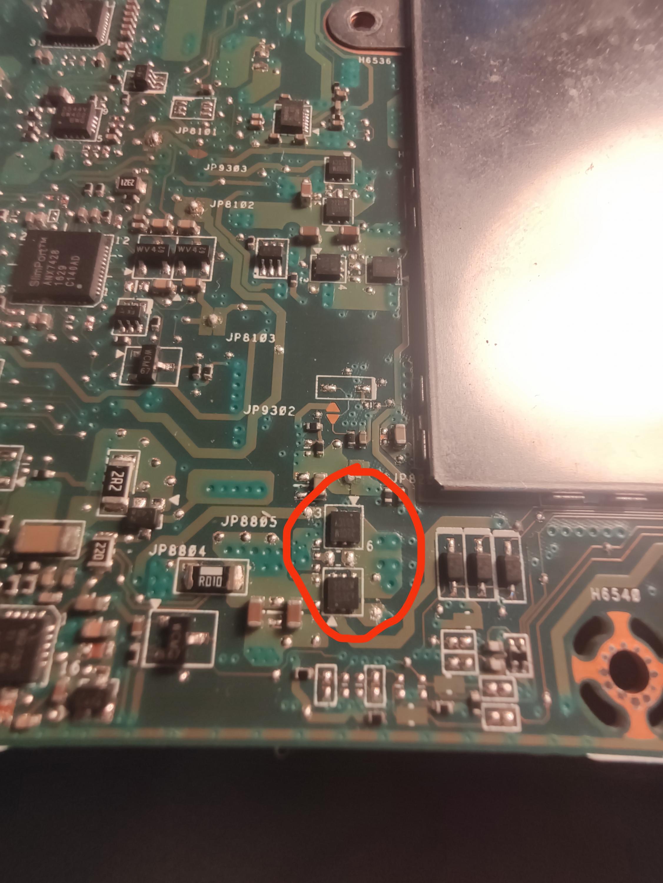

    YES.That R010 is very likely the CLR(Current sensing resistor). You should have stable 19V here. If your 3v/5V PWM is soldered properly and the chip is ok, then you have problem in charging section.
    Take the following steps:
    01.Identify the 2 dc-in mosfets and measure voltage on them.
    02.Check in resistance mode(both fets) between
    A=Source -Drain
    B=Source - Gate
    C=Gate -Drain
    03.Locate the charging IC and check these pins
    A=VCC
    B=REGN
    C=ACOK
    D=ACDET
    E=CMSRC
    Link the schematic so that i can answer better.
    vcc=18.9
    B=6.2
    C=0
    D=2.6
    E=0
    for the 2 mosf i think they are those on the right of the current sensor resistor. I have all Kohm mesure but the one connected to the same pad.
    and now i have no more vin at the 1225c

      Remove the CLR and then connect the adapter. Do you get 25V at the gate of both dc-in fets?
        #43
        Re: Acer Swift sf314-51-55 doesn't start
        They are no "normale mosfs" with one gate. But no, i dont have the 25V. But i have some 19V around the Board.

              It comes from CLR and not dc jack directly. If you dont have 19V on CLR, you wont get it at stepdown controller. Whether voltage will reach CLR or not, depends on the functioning of charging circuit.

                  At this point i think the problem is the bq. AM i correct?
                  Do you confirm the 2 input mosfets are the nearby of the clr?
                  other thing. Why i have not the 19V At the first mosfet?

                      That expectation will meet on the board when charging circuit works. Why not give us measurement of charging IC instead of what you expect or think? That'll perhaps help you. Without measurements our guess is as good as yours.

                                      I solder and resoldered manu Times. I get 2.8-3.8v in the current sensor. I have the same tension on the gate of the Second mosfet (i think the Second) and 0 at the first. I dont understand why i have no 19V in the input of the first mosfet. In add, i am not sure of the bq soldering couse of the problem i described 2some message ago.
