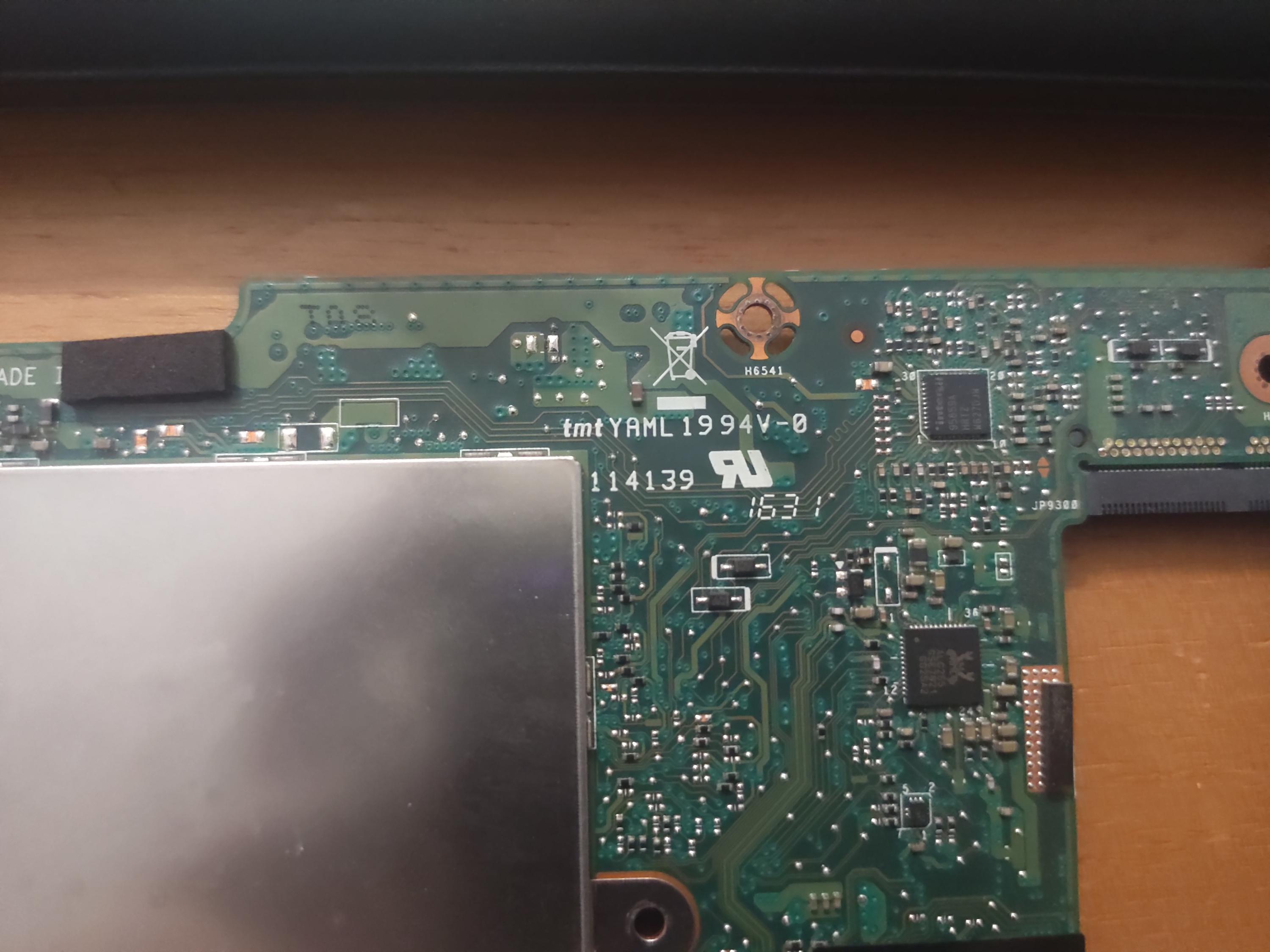

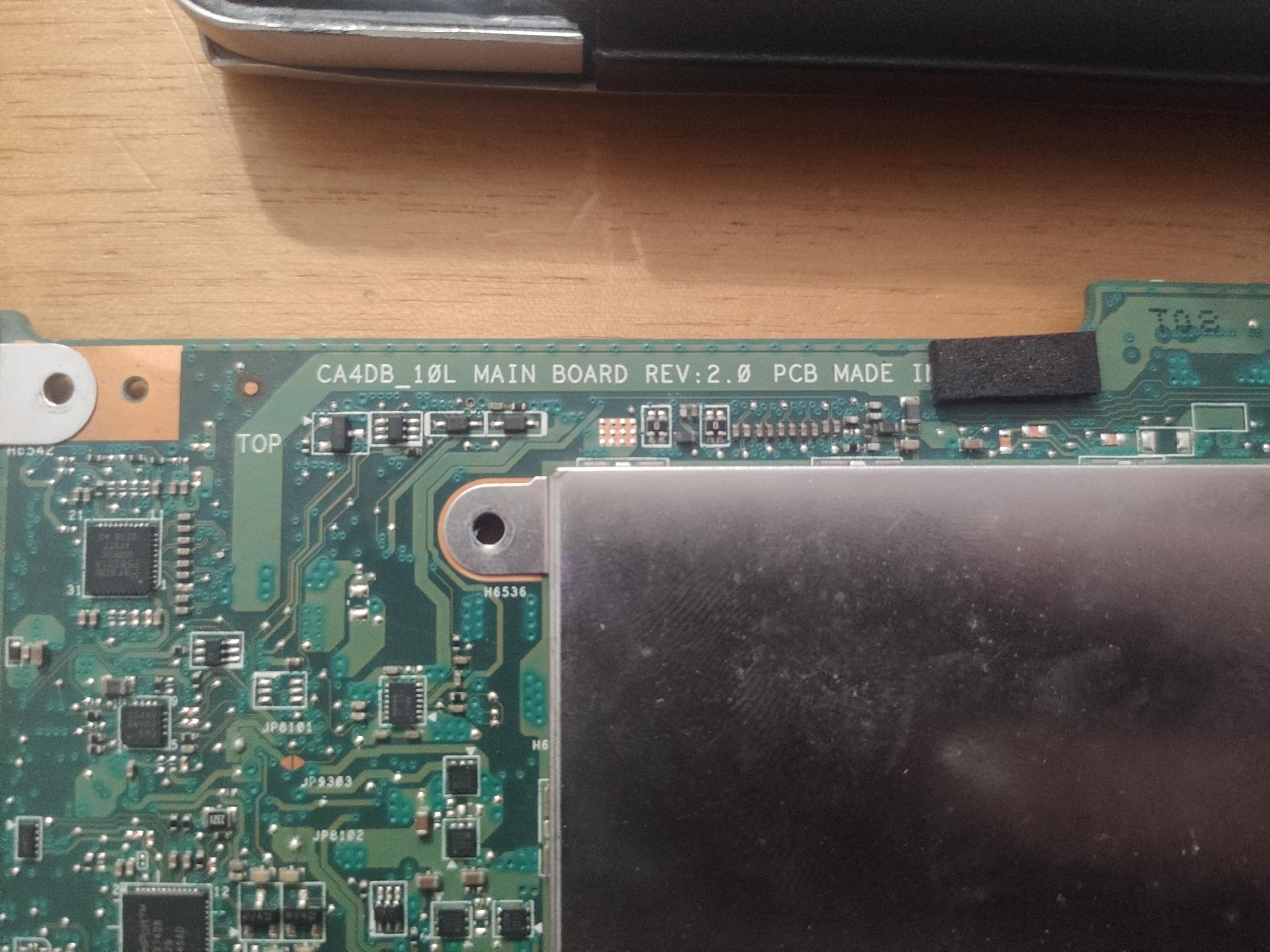

          Hello!
          Please, specify the motherboard marking code.
          • giulio93
            • Aug 2021
            • 258
            • Italy

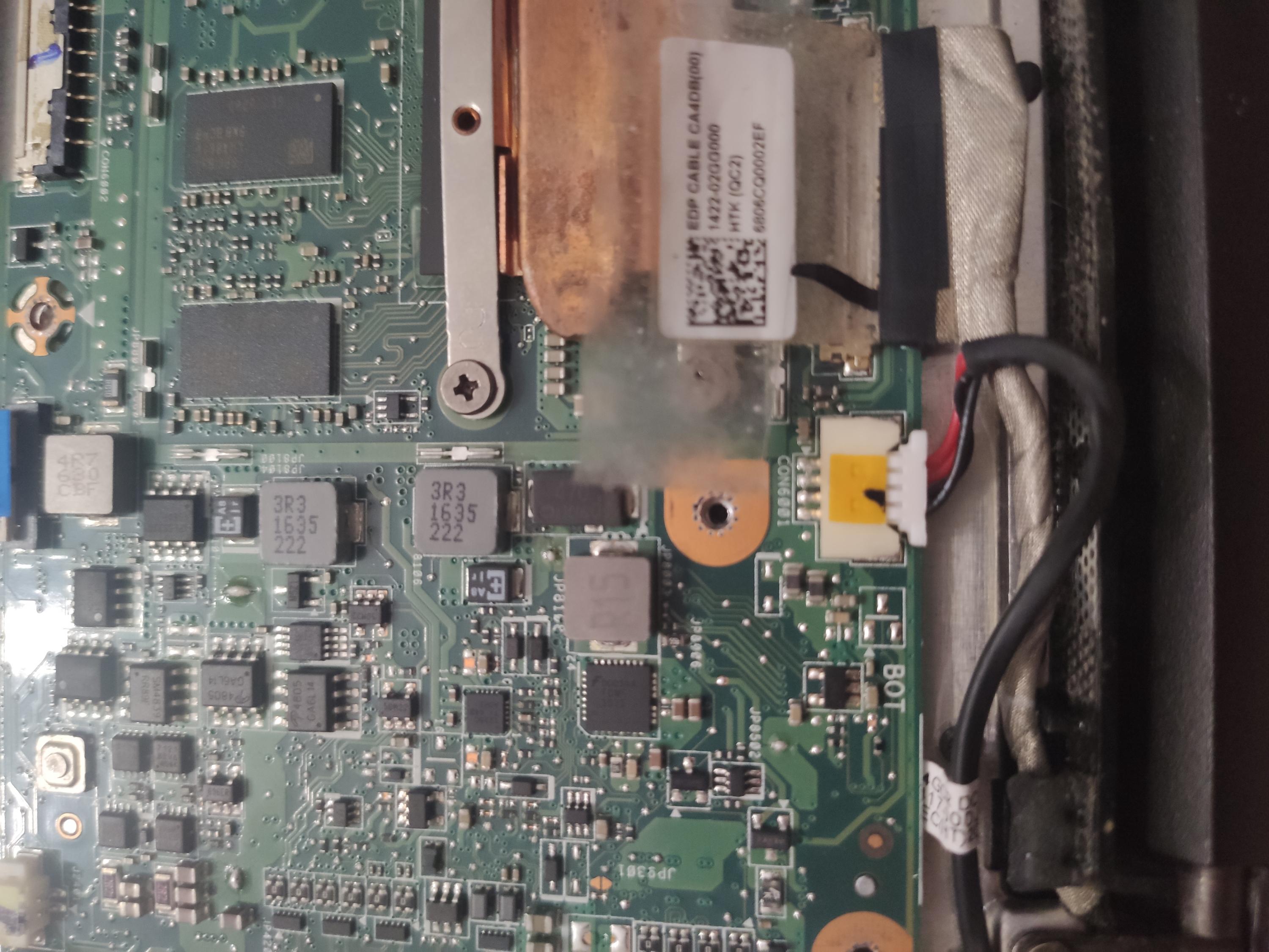

            Re: Acer Swift sf314-51-55 doesn't start
            Originally posted by natic
            Hello!
            I attached the pics.

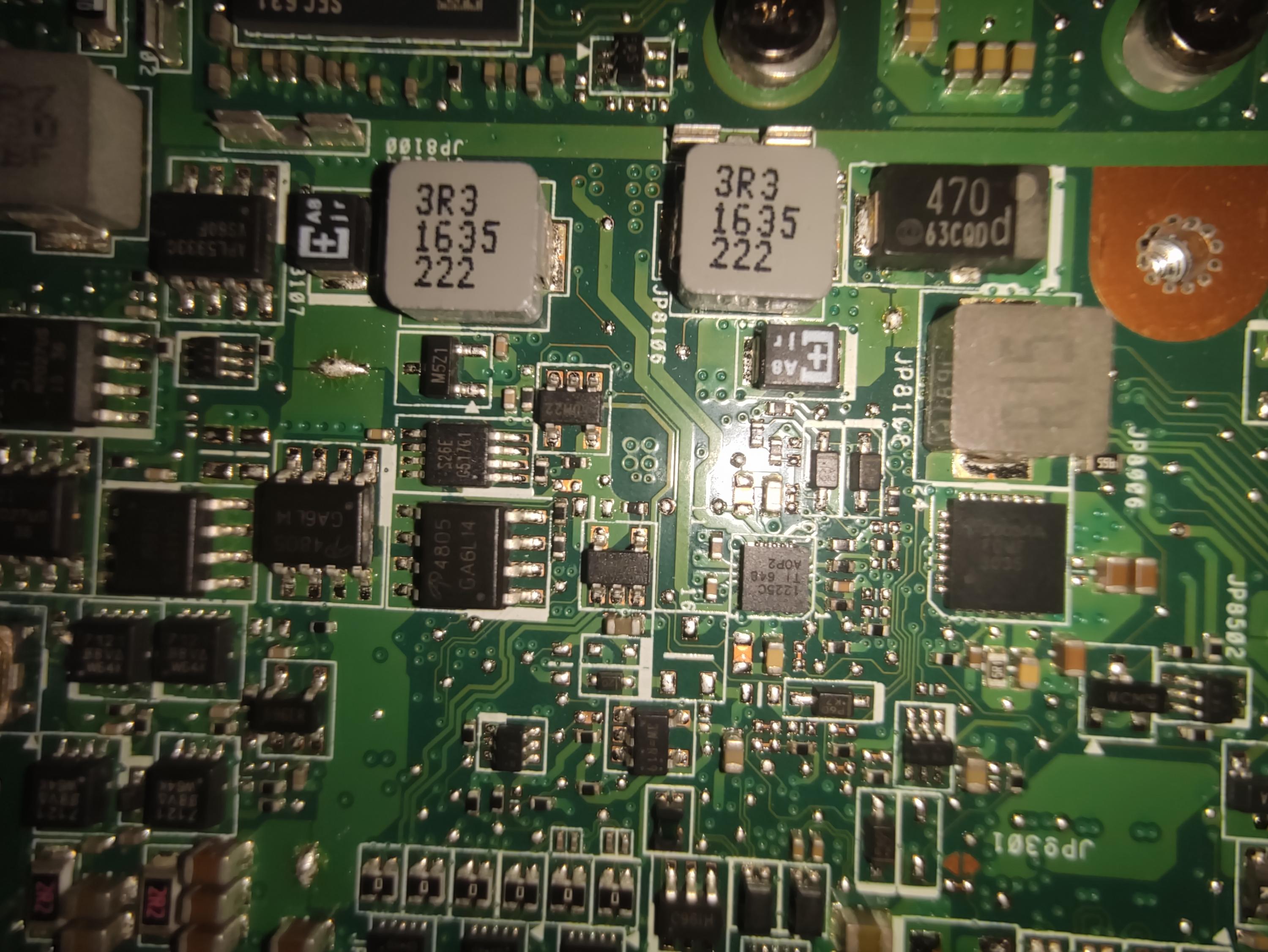

            New observation: when the battery is plugged the chip I post the pic goes to 43 degree. If I disconnect the battery it doesn't happen. Charger plugged in or nor no differences
            • giulio93
              • Aug 2021
              • 258
              • Italy
              Errata corrige, when both the battery and the charger are connected the temp reach 46. On the caos near to it i have 5v and 3.3V.
              other thing, when just The charger is plug in (battery disconnected) The Board emitt a "click" every Second ish. And in this situation a Little spot goes hot around 35 Deg. Tomorrov i'll send The pic

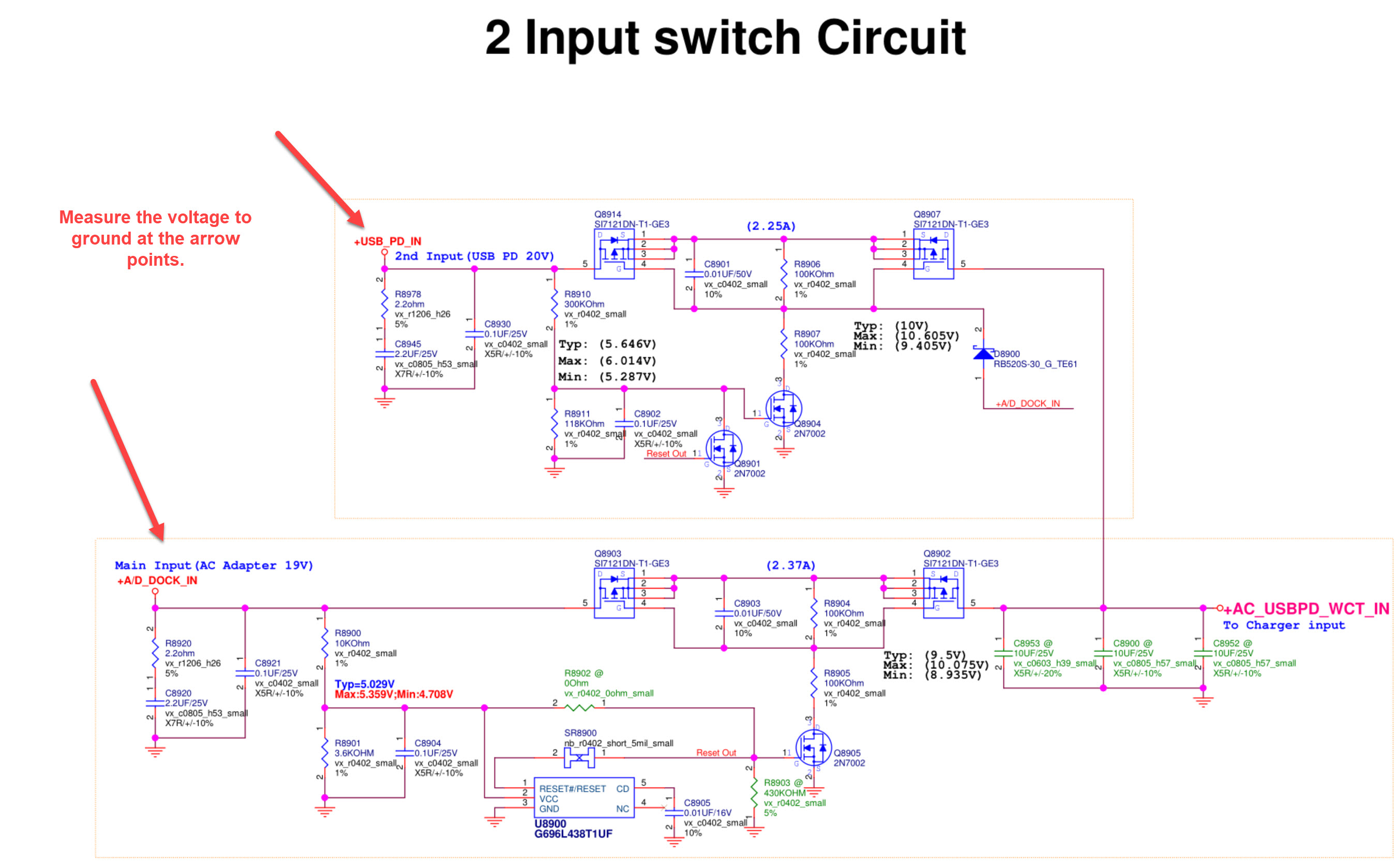

                      Remove all power. Meter in resistance mode. Measure the resistance to ground at the DC-in power adapter connector pin.
                      What is the resistance to ground?
                      See attached - are these arrow points pulsing?
                      • giulio93

                        Without The Board view it's hard for me understand where the arrows are in the logic Board. Can you Point me the mesure Point in the pics I share?

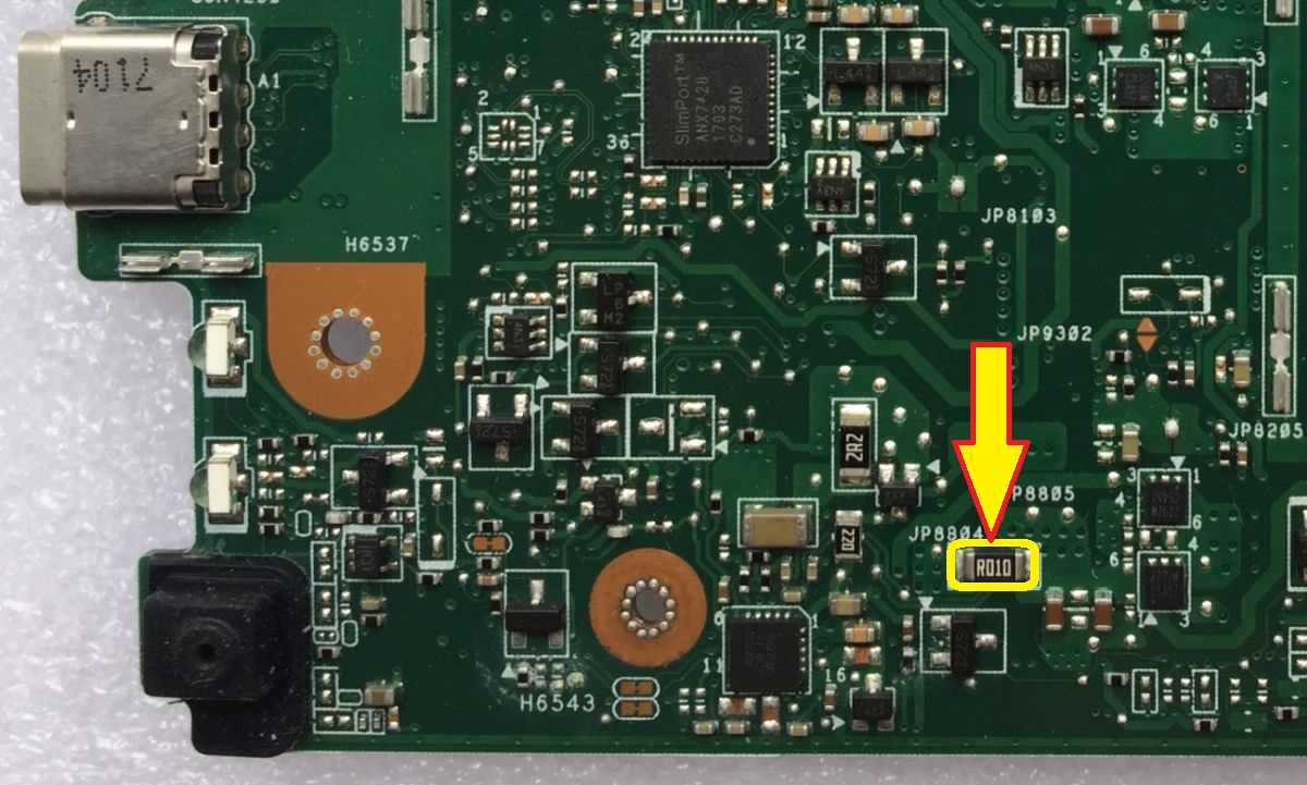

                        • mon2
                          • Dec 2019
                          • 14662
                          Remove all power -> measure the resistance to ground of where you have seen the Vin rail pulsing. What is the resistance?
                          • natic
                            • Sep 2018
                            • 34
                            • EU
                            Measure the resistance to ground on any pin of marked resistor.

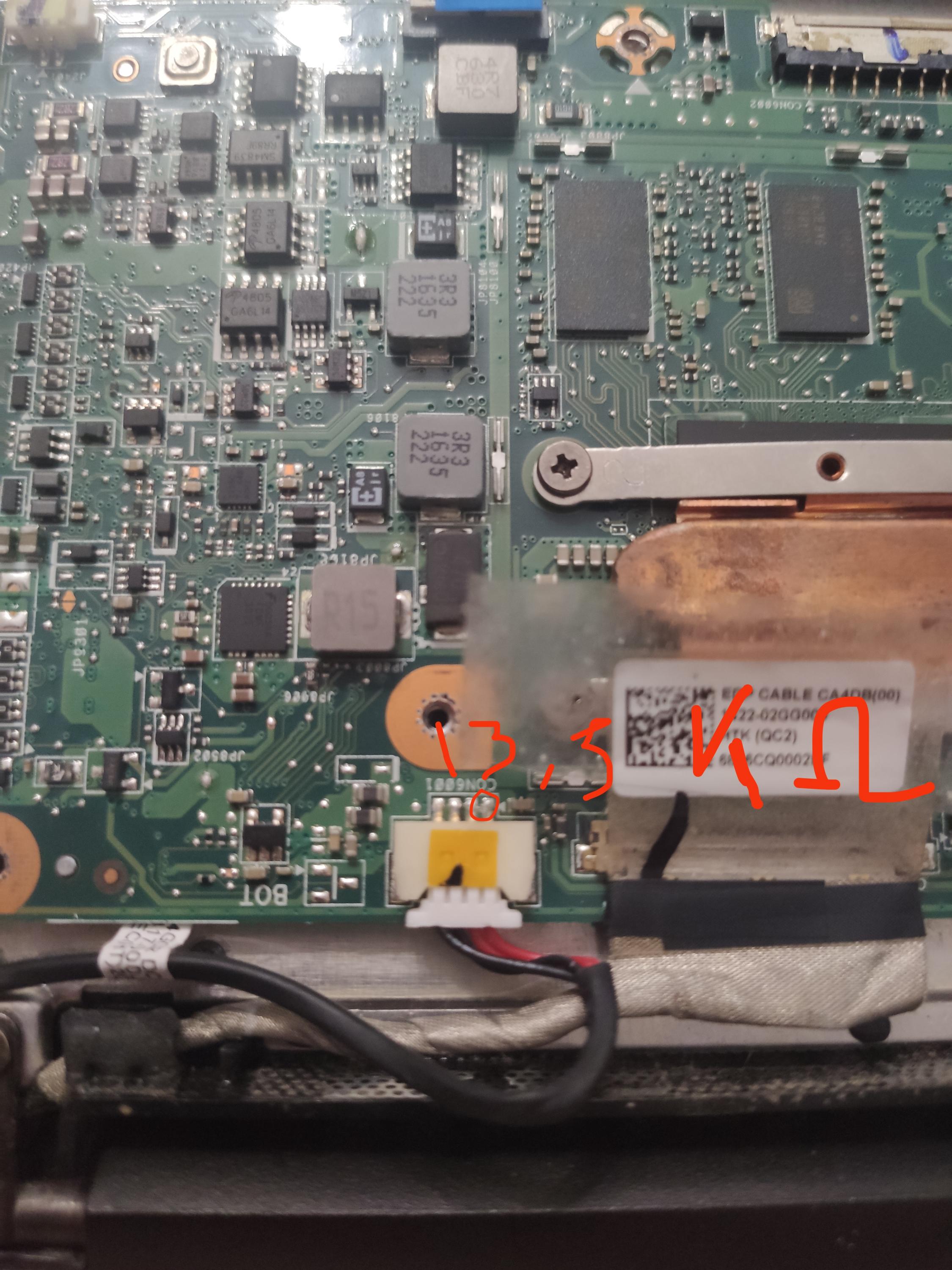

                              Tell me if i missunderstand. I check on schematic of the 1225c and the pin 12 should be this one.
                              • giulio93
                                • Aug 2021
                                • 258
                                • Italy
                                2.48 Mohm
                                  To confirm, the adapter voltage of 19v is pulsing at the connector where there are the 2 x red wires?
                                  Is the power adapter the original and the one recommended for use with this laptop? If the adapter is underrated, the power rail will dip.

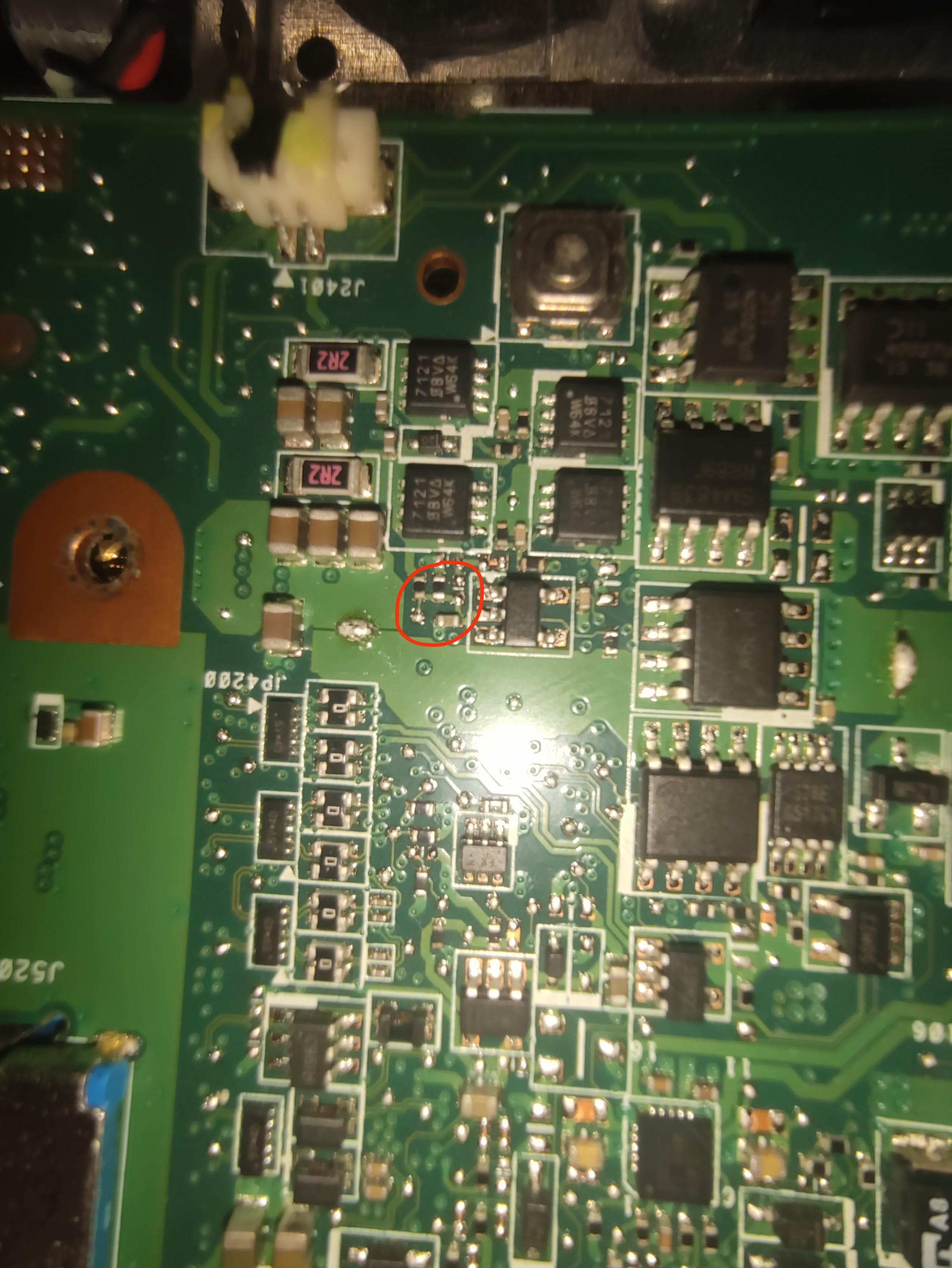

                                  • natic
                                    • Sep 2018
                                    • 34
                                    • EU
                                    True.
                                    Please, post a picture of the hot spot.
                                      No is not pulsing At The connector. The adapter is a compatibile one with 2.37A
                                      • giulio93
                                        • Aug 2021
                                        • 258
                                        • Italy
                                        True.
                                        Here
