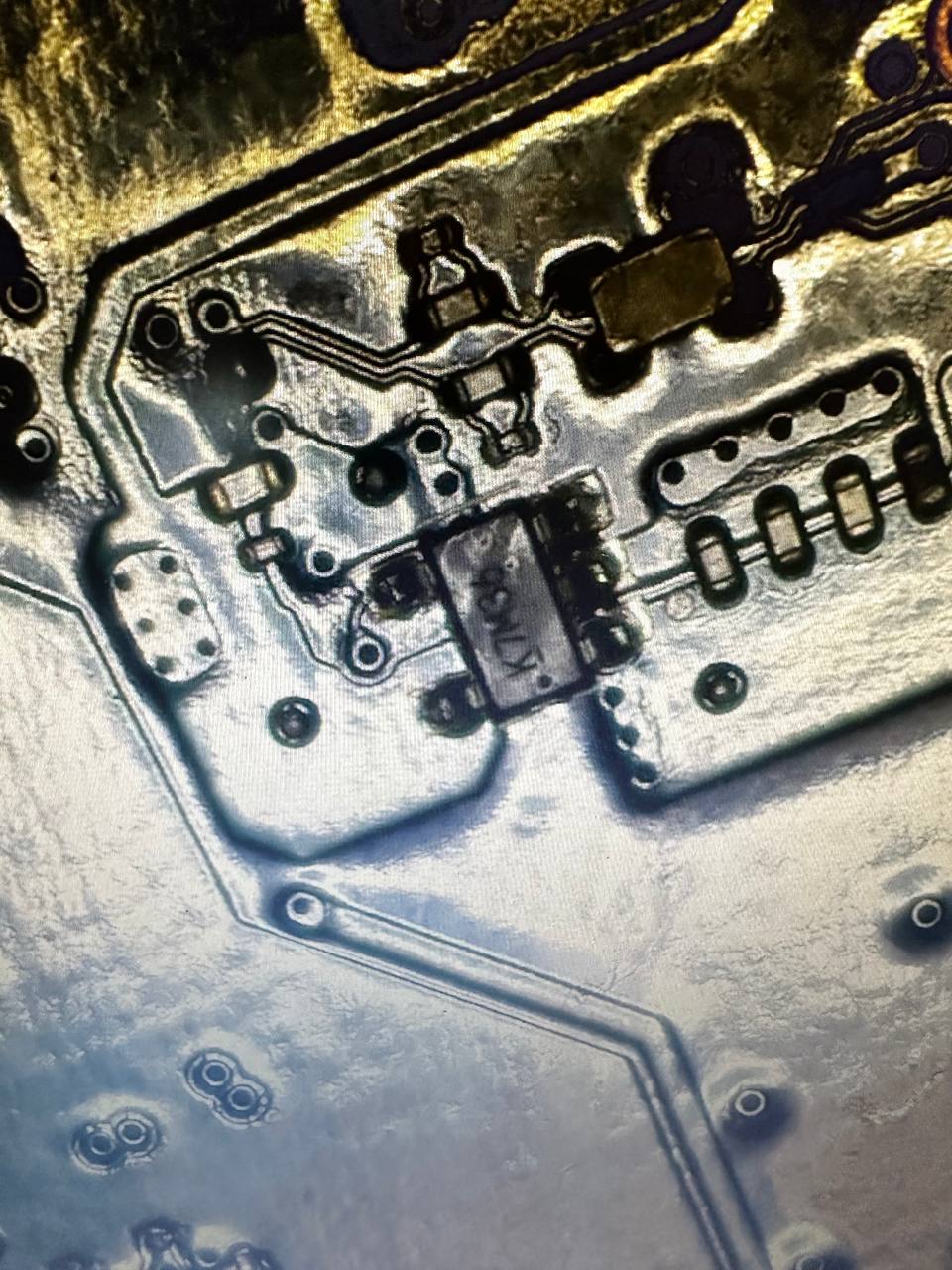

    Two laptops arrived with broken DC PowerJack.
    With thermalcamera i saw a heating EC controller, switcher? around usb port, and diode near ec controller.

      Re: HP Pavillion 15-ec2253ng (DAG3HIMB8C0 REV.C)
      Hello!
      This chip is a "Power distribution switch" for the USB port. It's very likely damaged. Remove it from the board.
      Measure the resistance to ground on the cathode (-) pin of this diode.

        Thanks for response. I replace usb switch, but no changes.
        All resistance kOms (including resistance on cathode, caps around ec). Its heating resister, not diode. It going to 67 pin ITE8987E (AD_TYPE). 5.5V on 67pin, I think its too high.
        In this circuit 3 resisters - 100 Om, 8kOm, 2kOm. Heating last resister 2kOm.
        Forgot. Voltage in a power button also 5V. It's good? Usually 3.3V.
          Does this chip still heats up?
          By the way, you can test the board without this chip. It should work normally, except the USB port.
          - Measure the resistance to ground on pin 67 of KBC chip.
          - Measure the resistance between the central pin of the DC socket and pin 67 of KBC chip.
          - True, this voltage is too high. Measure the voltage to ground on central pin of the DC socket.

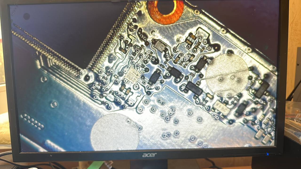

                                      Hi guys, anyone can help me with resistor value?
                                      Board: dag3himb8c0
                                      Got this board in this condition, one BIOS chip leg broken. I accidentally lost resistor in red circle. No schematic or BV available...
                                        Board: dag3himb8c0
                                        it is 15 ohm
