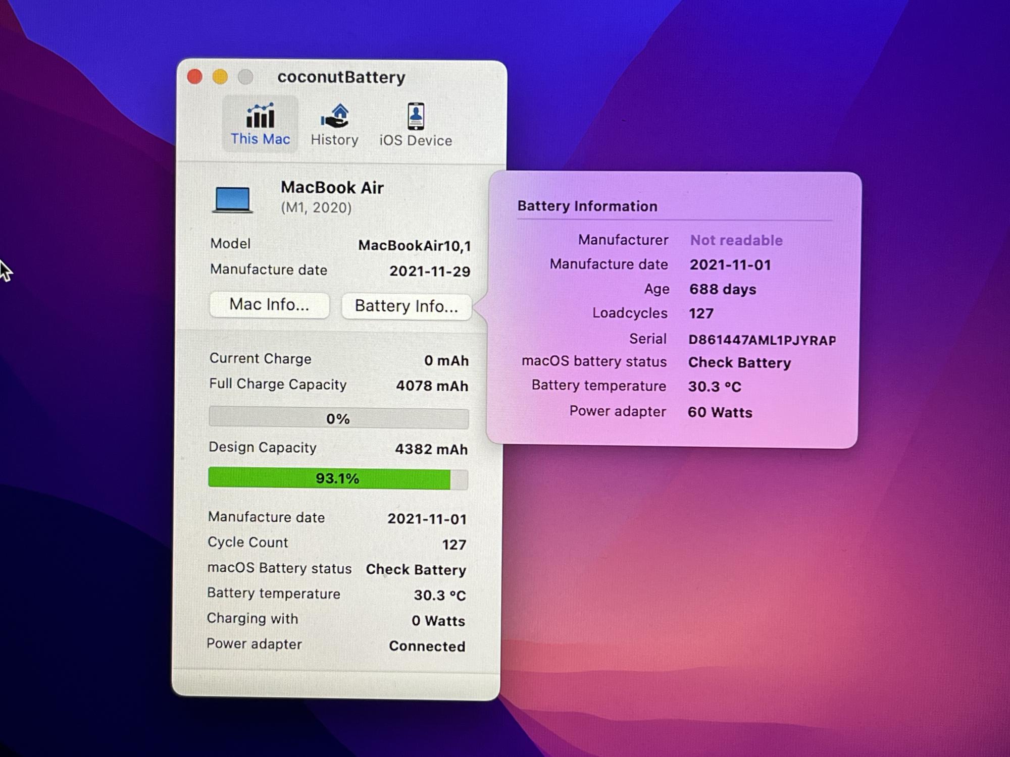

      I managed to repair the board. It was a 4 hour job, I found the shorts inside the PCB and removed them, and repaired the traces for one of the chip that was above. Laptop now turns on and comes up to the login screen.
      But there are still problems:
      - Trackpad and keyboard aren't working. Found the corroded trackpad and its cable. Trackpad itself might be salvageable, but one resistor fell off during cleaning. There is probably no schematics for the trackpad...?
      - Keyboard not working, I guess it is the same matter as on Intel MacBooks, where it needs to see the internal trackpad for the keyboard to work?
      - I can't reset the laptop as the user login password is lost (but Find My is turned off), as it will ignore USB-C keyboard keystrokes. Any other way to do it?
      - Battery will not charge. Everything looks nice, the battery isn't liquid damaged, the SMBUS lines look fine. Battery voltage (on the battery PCB) is 11V. Anything particular to look for?

                  Re: M1 MacBook Air 820-02016 possible to swap ROMs to unlock a locked board?
                  Oh ok, didnt know about this, despite having a 16 inch M1 MacBook for a year now.
                  I managed to restore it now. The battery says “Service now”. So I guess battery is itself bad..?
                    maybe it's just so discharged that is locked .... check video of Electronic repair school : Fixing/Unlocking laptop batteries without any software
                    shortly maybe if possible just charge it little bit with power supply and it will work again

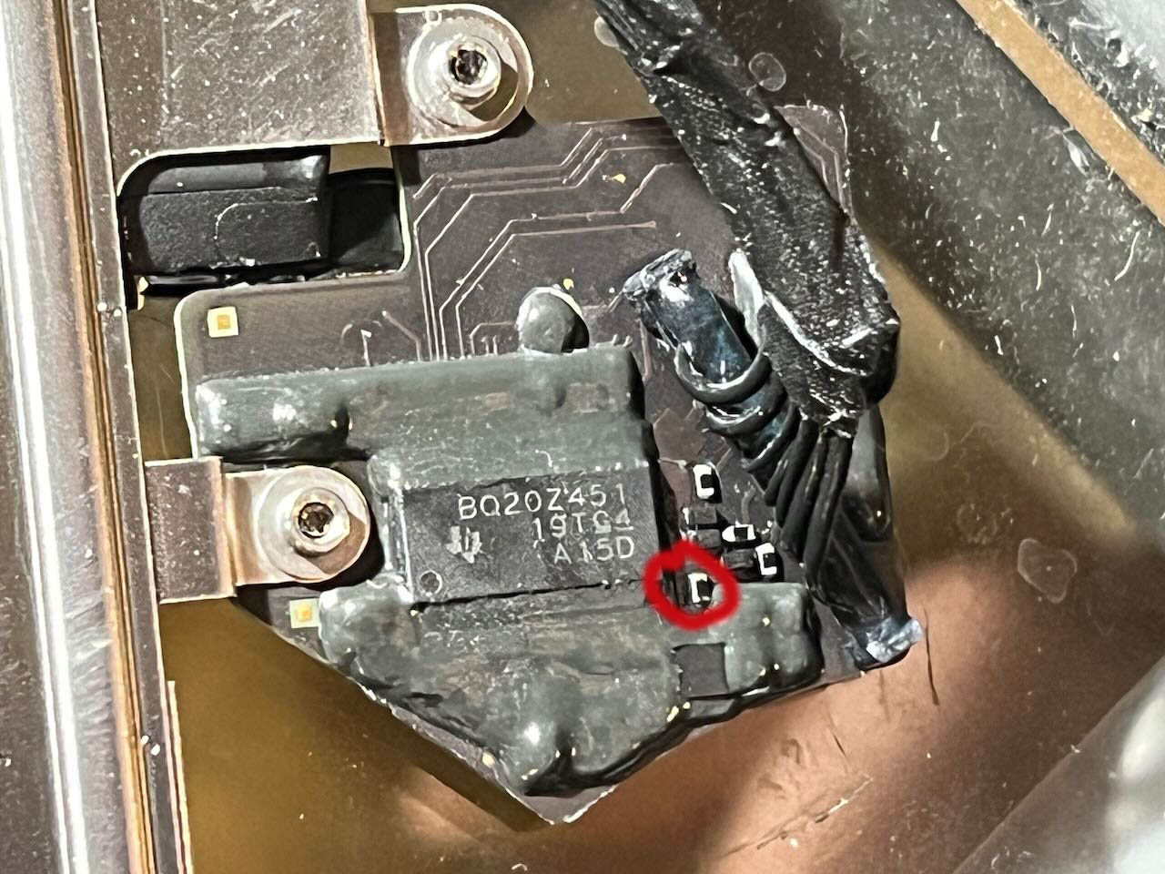

                      I took the battery out and on the bottom side of the battery PCB there was some corrosion.
                      One resistor was particularly corroded, and it later fell of when I tried to measure it. It read OL even after off the board.
                      I guess there isn't much to save with this battery. Or if someone has the value of the resistor and I can resolder it back...
