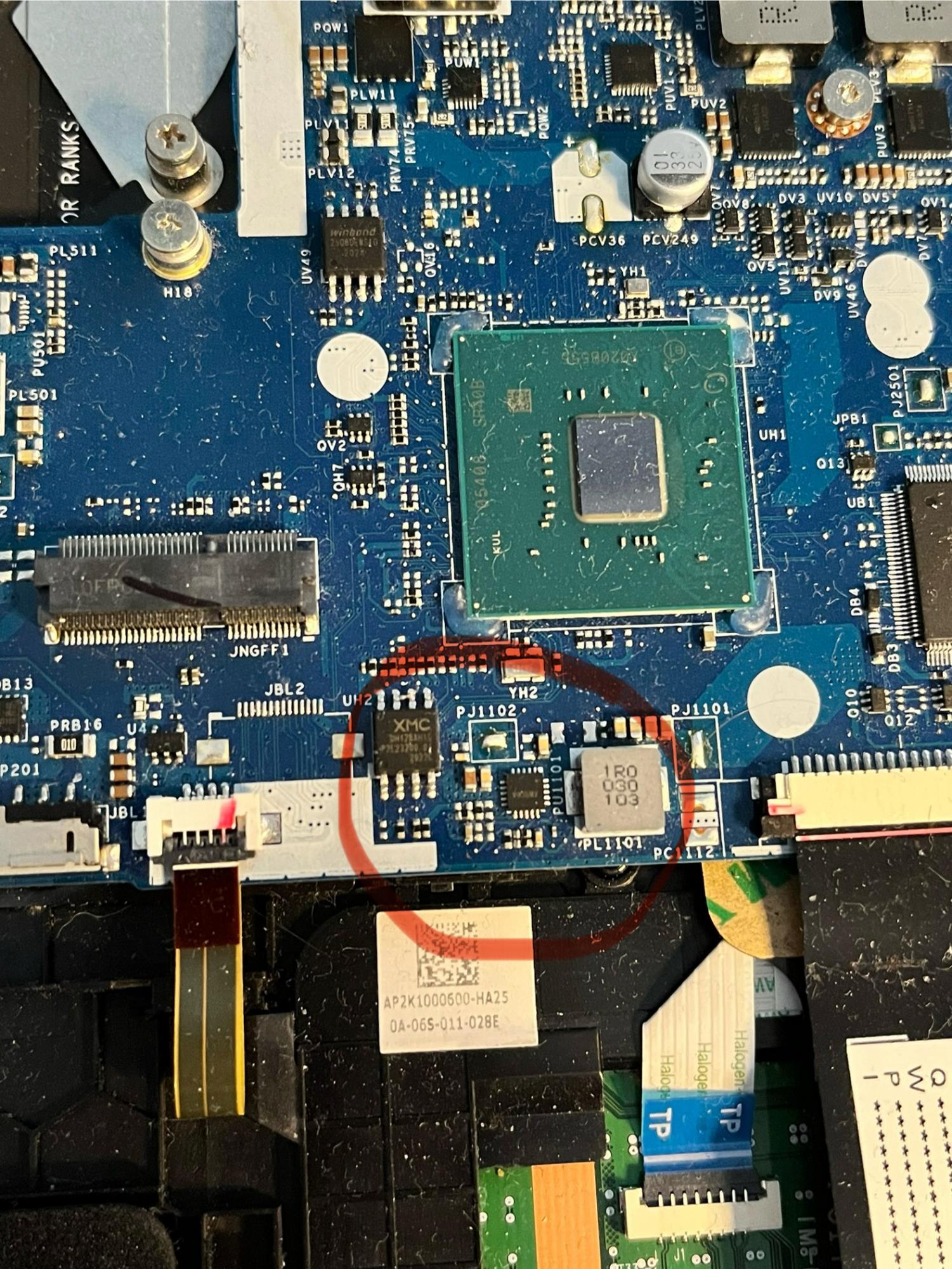

                            • mon2
                              • Dec 2019
                              • 14250
                              Re: Acer Nitro 5 Dead
                              Post a picture of the LDO. I think I have the schematic of this unit in my paid sub.

                                  • jasonr2000
                                    Advance Tech
                                    • Nov 2013
                                    • 209
                                    sorry for the slow reply guys ive had a busy few days.
                                    I believe this is the LDO

                                      • mcplslg123
                                        • Jun 2015
                                        • 7262
                                        • india
                                        You can look in schematic or datasheet for +3V LP pin of PWM. Its been days and you still cant confirm whether its present or not and its resistance to GND. All suggestions have been given.Where are your follow ups?
