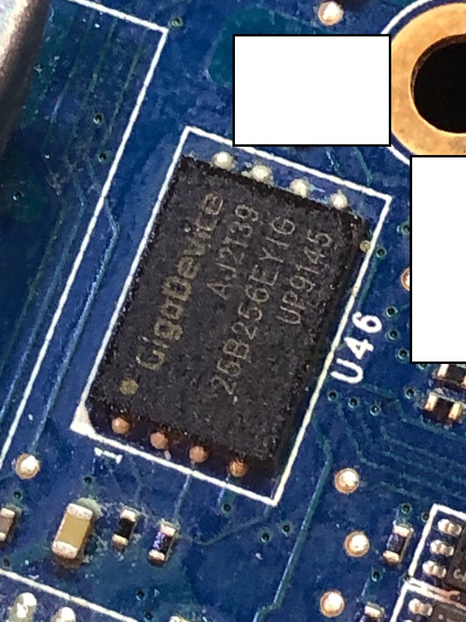

Can you help me find an adapter for this ic bios attached in the picture size 32 MB
  • mohammed mohan
    • Nov 2017
    • 207
    • F12
    There is another type, smaller than it, that I am looking for as well, 16 mica
    Please, I want to link to a site that sells this adapter

    Re: Can you help me find an adapter for this ic bios attached in the picture size 32
    Greetings to the admin and everyone
    The attached picture was pulled from the internet
    Gigadevice product selection guide - https://cdn.badcaps-static.com/pdfs/...1d265cd845.pdf
    GD25B256E 256Mb 2.7V-3.6V 4KB / 32KB / 64KB Single / Dual / Quad 133MHz(x1, x2, x4) SOP16 300mil WSON8 6x5mm WSON8 8x6mm TFBGA24 8x6mm (5x5 ball array)
    Its one of the WSON8 chips 6x5mm or 8x6mm .Measure with a ruler or vernier calipers.
    Just do a google search for WSON adapter, you`ll find some on aliexpress,amazon,ebay.These types of adapters have been mentioned many times on the forum
    https://www.aliexpress.com/item/1005003319895312.html
    https://www.aliexpress.com/item/1005004045901323.html
    https://www.aliexpress.com/item/1005001830846980.html Pogo test probes are unreliable. YMMV
