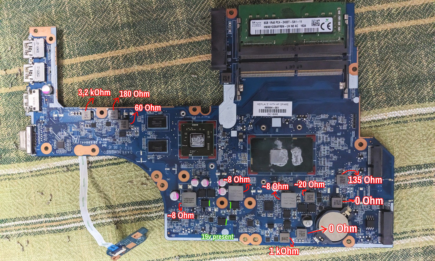

    Laptop: HP 450 G3
    Motherboard: DAX63CMB6C0 REV: C
    History: Stopped working after a power surge (supposedly through the RJ45 port)
    Issue: Does not respond to power button (power LED is on though)
    What I've done/checked so far:
    -Visual inspection: Board looks fine, even under scope
    -Charging port and cable ok. Charging port is also ok
    -Removed battery and reset CMOS
    -Measured 19v rail - passes the first two mosfets only.
    -Measured all the coils: only 5V present.
    Fixing it is not top priority, learning is (would be nice if I could find the fault). I have the boardview file and schematics. Help appreciated.

      Main power rail and LDOs are working. Do you have a unexpected low ohms reading at one the big inductors?

          Re: HP 450 G3 - No power
          Sorry about that.
          Yep, 7-8 ohms on the big ones.
            Originally posted by krayz
            Sorry about that.
            This doesnt makes sense as you have not mentioned the coil numbers along with readings for resistance to GND.
              Here is a picture of the board with more details on the resistances.

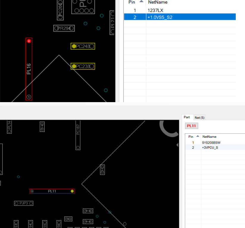

                This smells pretty much like a shorted PCH. I don't have access to the schematics and boardview right now, but if someone can confirm the "0 Ohms" coils belong to 3.3V and 1.05V then it is very likely a dead end here.
                  Well that sucks. Any way to confirm it for certain?
