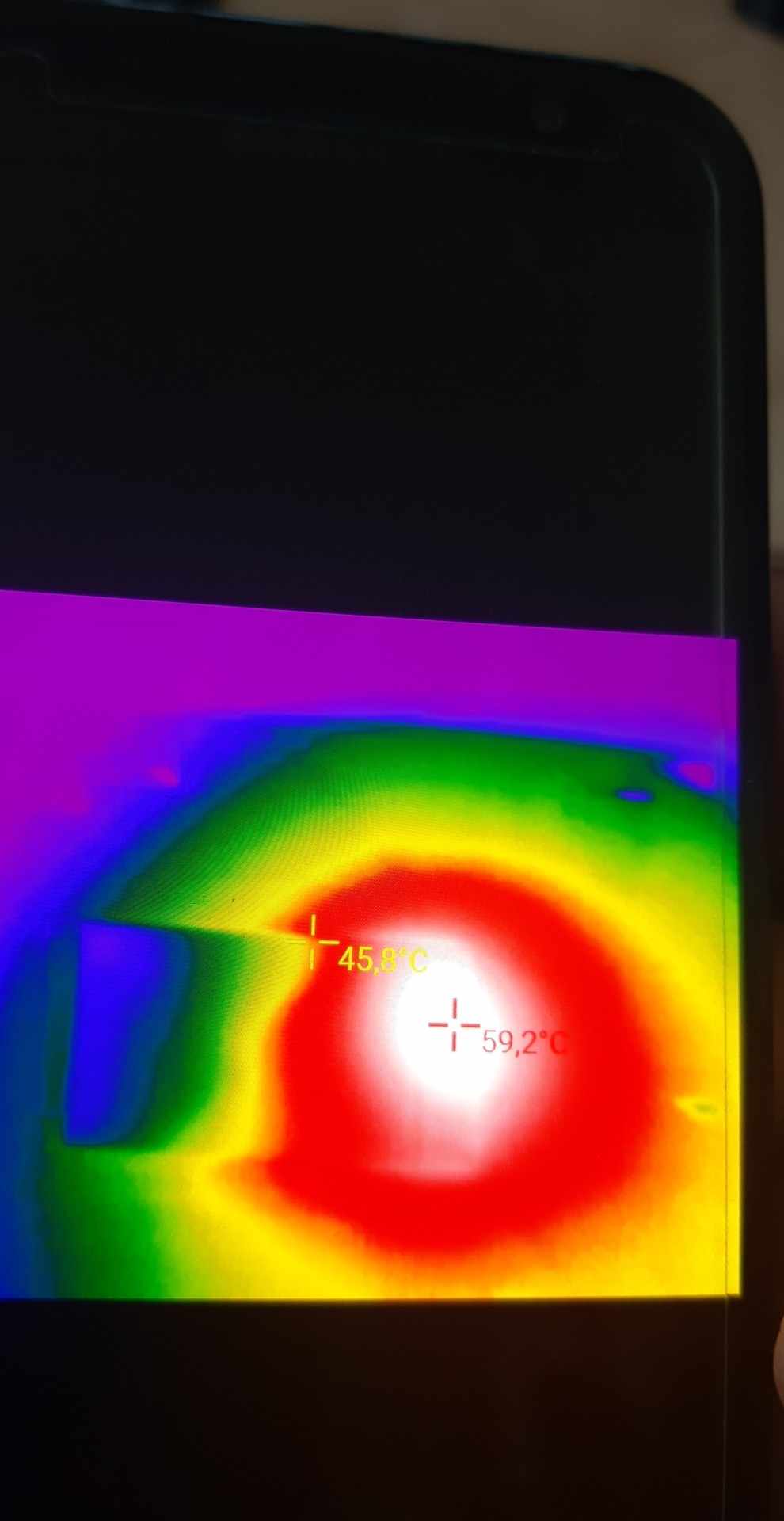

    I'm not too much experienced man, so I would like to have some confirm about my board..
    On the board is burned SY8286RAC, which provide +1.05VALW mainly for the chipset. After changing IC, on the output is 1.05V, laptop is power on, it takes 20V 0.6A stable. Nothing on the screen. The corner on the CPU gerenerate more heat (about 60C), the rest of the CPU is almost cold. Chipset is not burning hot, about 45C. The only way, how to this chip should burn CPU is via G2898KD1U, which is (with chipset itself) the only one which take +1.05VALW from SY8286RAC. G2898KD1U provide VCCST and VCCSTG voltage for the CPU.
    So, is my brainflow correct? The shortage of the SY8286RAC put some shit voltage to CPU via VCCST and G2898KD1U?

    Normally the PCH should be stone dead, but who knows. Resistance to GND measurement of +3.3VALW and +1.05VALW?
    Which corner is getting hotter (picture)?

      Re: NM-C221 - PU2101 (+1.05VALW) burned
      72 OHM for 1.05VALW
      15 kOh for 3VALW
      No caps on the PCH is lower than 72 OHM..
        This looks indeed absolutely fine.
        There are multiple SY8286RAC present on your board. Are you sure you're working on PU2101 and not on PU901 for +VCCIO ?
        I mean this could be in my opinion the only reason why the CPU is getting hot...
          Yes, i know, there are two. But burned was PU2101, PU901 had nice 0.95V. Is normal that the corner of the CPU is hotter? The only way, how to this chip should burn CPU is via G2898KD1U, which take +1.05VALW from SY8286RAC. G2898KD1U provide VCCST and VCCSTG voltage for the CPU. But chipset doesn't looks burned..
            The load switch, yes. Could be. Did you measured it for internal short by any chance? But indeed if the device was full on while the incident happened then the main power rail could have passed this switch.
            I also can't share a better explanation for the fault. A uneven generated heat in the CPU is in any case a bad sign, unfortunately.
              What is the lowest resistance value allowed for this generation of CPU?
