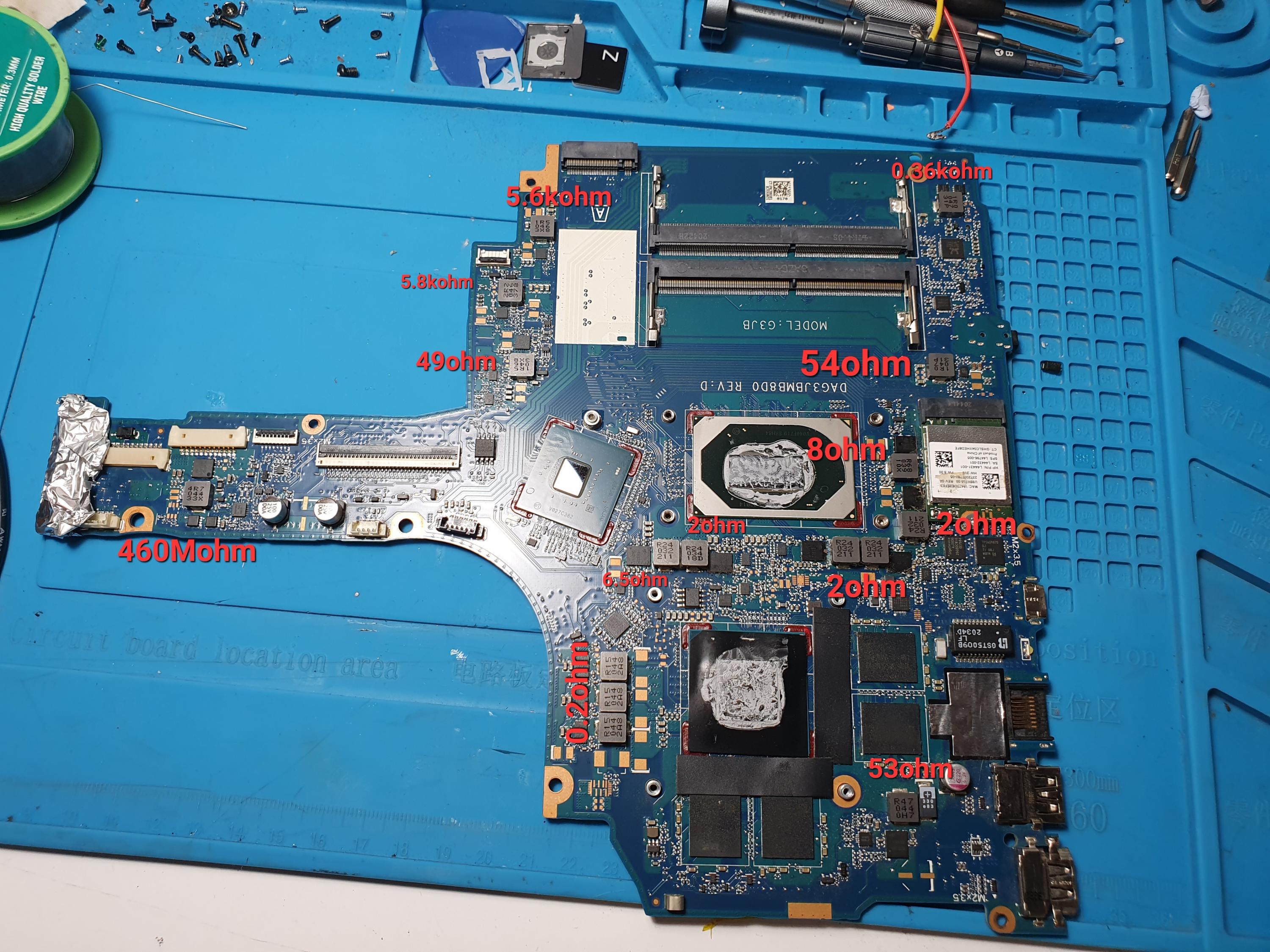

hello, i have a laptop that is dead. When connecting the power supply, its voltage drops from 19.9v to 100mV. I changed the power supply and the charging port, but that didn't help. I measured the output keys and diode drops of about 0.540V.
I have attached a photo of the coil resistance which is very small.
Where to look for the problem?
Nothing is hot on the motherboard.
Motherboard: dag3dbmb8d0 g3jb
