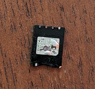

    I bought the chip Windbond 25Q256JVEN, because the one that I had desoldered from the laptop is broken (top of the Motherboard of laptop 840 G8)

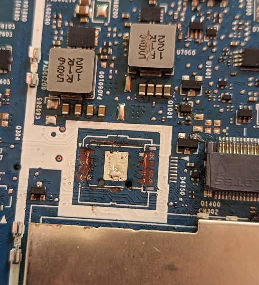

    Re: Import BIOS code/dump 840 G8 to new chip W25Q256JVEN
    Attached chip and MB
      OMG
      Pads of the board are damaged and without a boardview, might be difficult to locate where to run jumpers to. I'm sorry, but this is likely beyond your skill set to fix.
