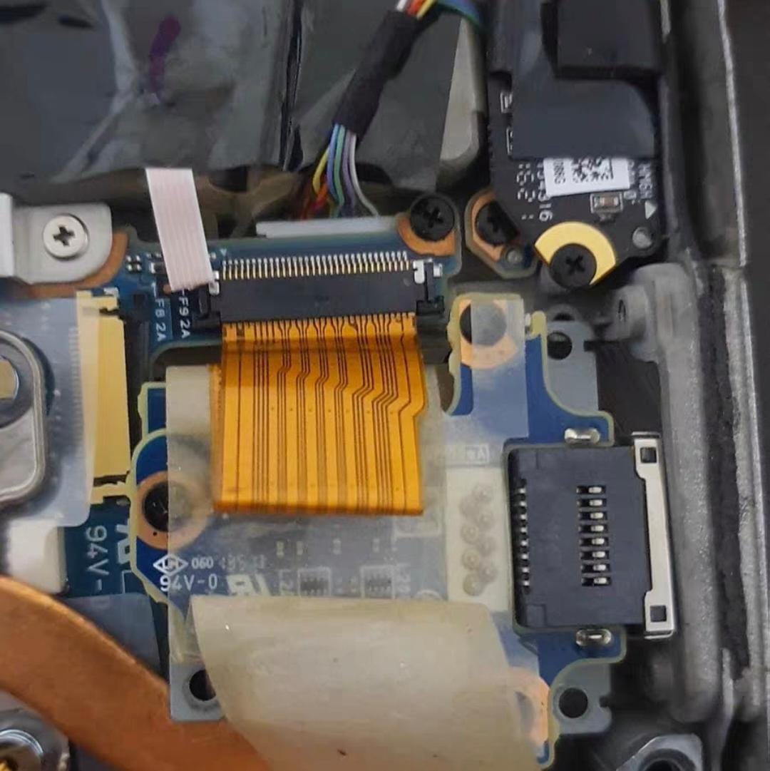

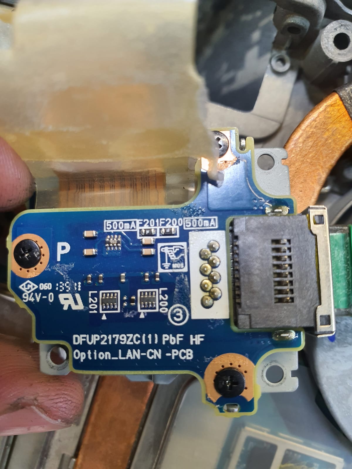

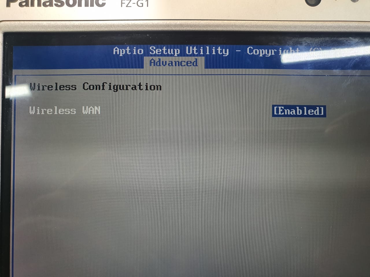

    Hi all !
    FZ-G1R3000VJ
    DHLB1030ZD/X1
    I have a laptop, it initially did not have a network lan card rj45, I ordered a card, inserted it, it did not appear in the device manager.
    I thought maybe the problem is in the BIOS, I found similar ones on the site, wrote it down, tried five pieces already, nothing has changed.
    Network card not showing up in bios settings
    maybe the card is not suitable for my laptop at all or I'm using the wrong bios?

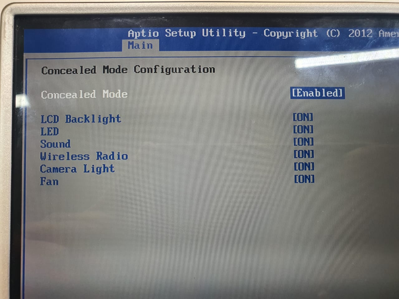

    Do you have the manual? if you do, check page 65~71 Switching the Concealed Mode
    Starting the Setup Utility, Advanced menu, LAN enable/disable
    It might have the LAN disabled

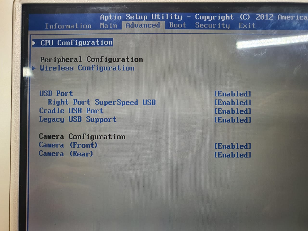

      thanks for the answer, I read it, but I have such settings

        Re: FZ-G1R add lan card, problem
        What is listed under Peripheral Configuration? That is where the LAN can be enabled/disabled I don't have one of these to try myself, I am only going by what is in the manual.
        It may also be in some hidden menu somewhere like Optional Kit Configuration

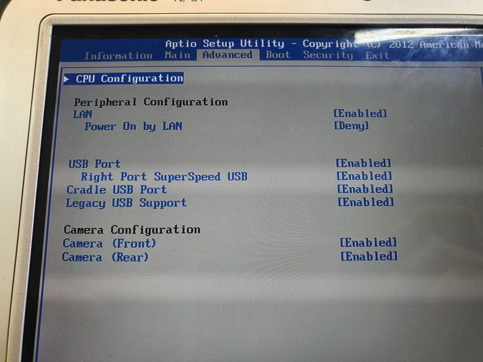

          I think need the right bios, where initially there is a lan card, but so far I can’t find one ...

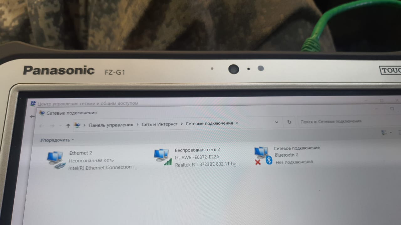

            all the same, it was in the BIOS, I found it, corrected it, another small problem in the drivers, but it all worked

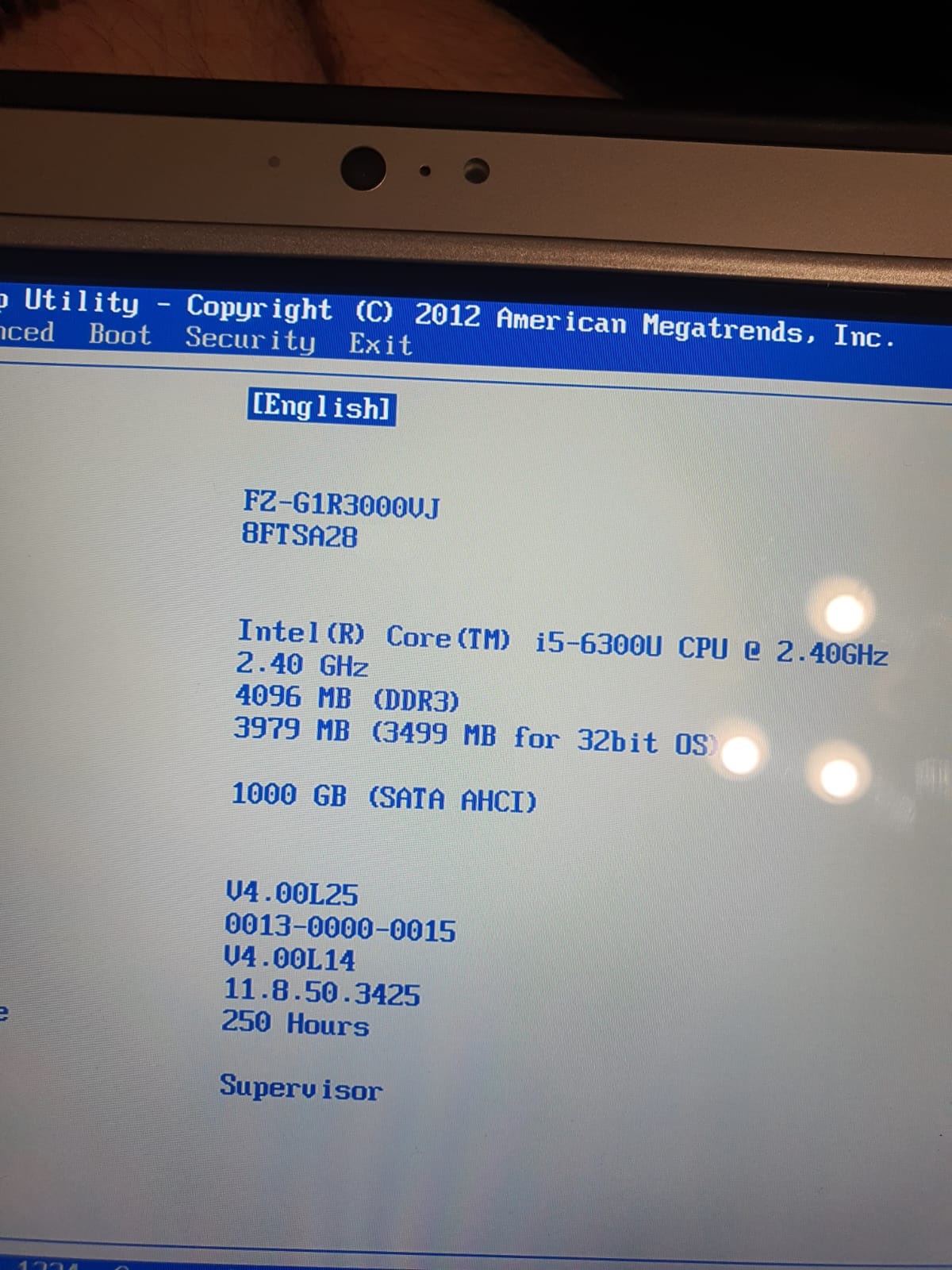

              Hello Rumper,
              I’m facing a similar problem, I bought a FZ-G1 with a LAN port but I doesn’t get recognized.
              I had the BIOS V4.00L15 that had the option to enable LAN but the setting would not stay saved.
              I upgraded to V4.00L25 thinking that it would allow me to enable LAN but I have even less options.
              What version of BIOS are you using ? V4.00L13 ?
