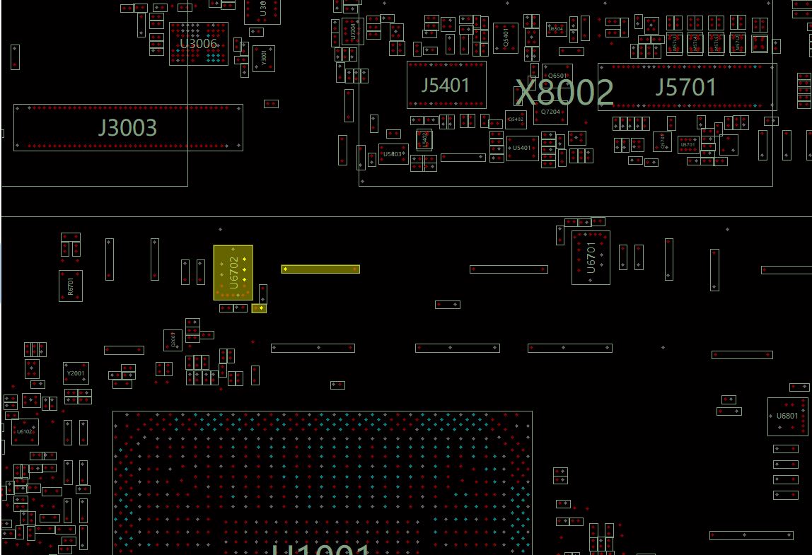

    hello everyone. please help i have a surface laptop 3 AMD model 1873 that randomly restart. i don't think it has bad CPU, because when tried to stress test by CPU-z it not restart or has anything wrong, it just randomly restart when normal use ( browser, or watch video....). i tried to replace U6701 and U6702 but don't see any thing change.
    I'm tried to fine any glue on internet but no luck. I'm looking for any advice from you guy please.

    Boot in safe mode. Is it stable?
    Is the ram in a socket? Try removing a stick.

      I'm not yet tried to boot in safe mode. this model are used on board RAM
