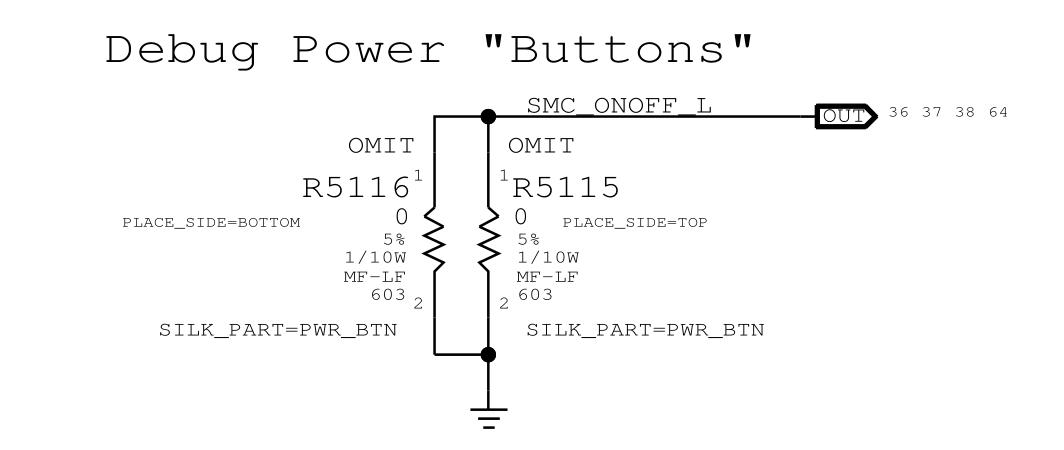

            Use adapter only (for now). Green light should be on. If it is flaky on the light, use IPA and clean the magnetic contacts of the magsafe connector that powers the logic board. Often the contacts get dirty.
            Press the ON/OFF button. If this fails to turn on the board, the fault could be with the keyboard button itself.
            Locate the shorting pads on the logic board that you can use with tweezers to emulator the ON/OFF keyboard button. There will be a shorting pad on each side of the PCB.
            See attached. These will be empty PCB pads on the logic board.
            Use tweezers and short them to check if the logic board is able to turn ON/OFF.

              Now light turns orange from green. (adapter only).
              No Fan Spin.
              Wont Turn on from the On/Off Key.
              Tried shorting R5116. No Activty
