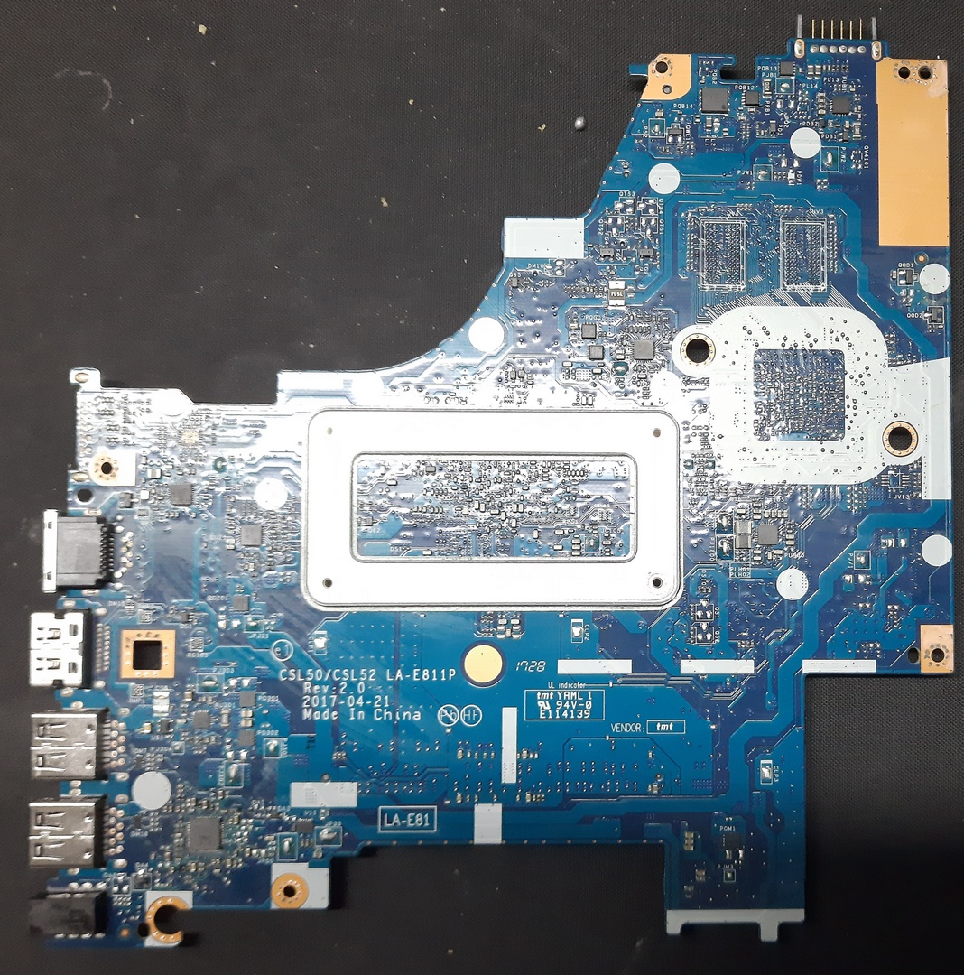

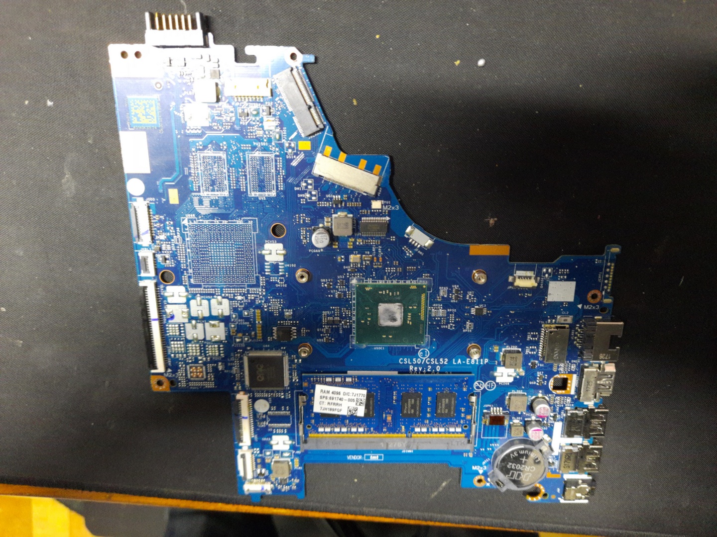

    Good afternoon.
    I am at my wits end with a HP 15-bs001ni laptop I am working on. It power on but shows no error codes on the caps lock or num lock and no image on screen or backlight on screen.
    Motherboard model is C5L50/C5L52 LA-E811P Rev 2.0
    Measuring voltages on the incoming mosfets are good. 19v on source and drain and 25v on gate for both the high side on low side mosfets.
    Memory voltage of 1.3v is present.
    Cpu/chipset power supplies has 1v
    EC chip has 3.3v and starts up the other power supplies.
    Bios chip has 1.8v
    usb ports have 5v
    Monitor has 19v but strangely I cannot find the 3.3v on the screen connector.
    The board draws 10MA when powered off for the 3.3v LDO and 230MA when powered on. The board also does not display to an external monitor.
    I initially thought it was a bios issue. A forum member was kind and provided me with a bios but still the same issue.
    I cannot feel anything get hot on the board that is out of place. Sadly I do not have a thermal camera.
    Would anyone perhaps have any idea what issue I might be having?

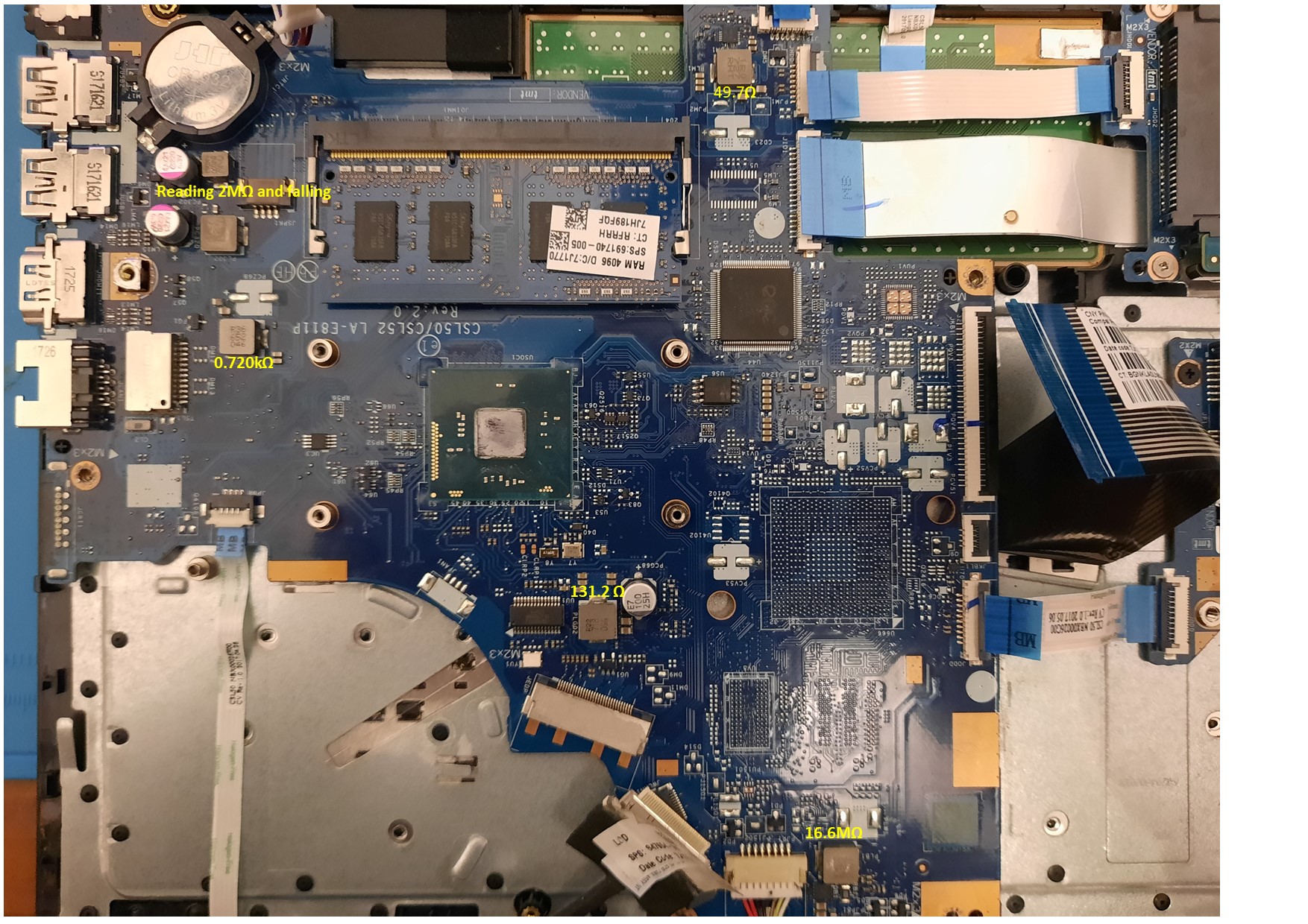

          • Sephir0th
            • Oct 2020
            • 1289
            Re: HP 15-bs001ni No image
            Share resistance to GND measurements of the secondary power supplied please and also take a look whether you can get a VR_RDY from the VRM Controller.

                I am fairly new to component level board repair in still learning. Where would the vrm controller be? I would assume near the cpu? I have attached an image so long with the resistance values as requested. Thank you all for your time.
                  mcplslg123, regarding your question I do believe it is. I do believe it should be in the aria encircled on the picture attached if I am correct? I get 1.35v there. Forgive me I doon't have a schematic or board view for this board so I am unsure.
                  • ebyte64
                    • Jun 2023
                    • 51
                    • South Africa
                    My apologies I seem to have been an idiot and way overcomplicated it for myself. It was just faulty ram. Thank you everyone for your suggestions and time.
