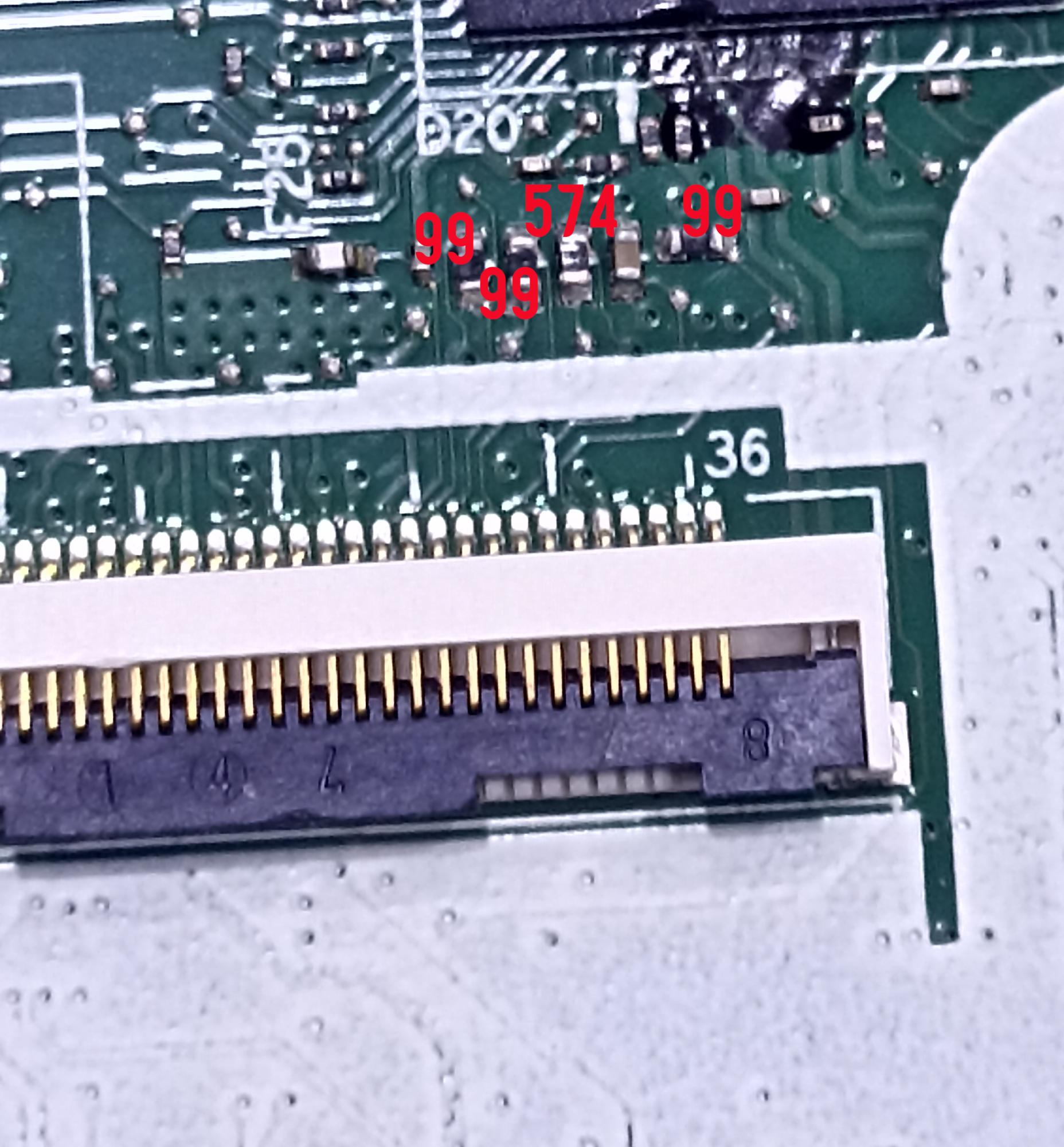

    Hi again.
    i got another weird Lenovo problem today
    the keys " R T F G V B 4 5" not working
    Replaced the keyboard with two different new kbs
    test on diode mode. red on ground and black on pins
    10 pin oL
    12 ol
    19 OL
    20 OL
    22 OL
    23 OL
    24 OL
    the 7th to the right is buzzing on diode mode with 0.000
    all other pins are 0.600 - 0.900 on diode mode
    so what to do now?
    Do you think it is an EC problem?

    inspect the traces to EC chip and also diode mode you must use plus to ground and black probe to the connector.

      and yeah that what i did. red to GND and black to pins (writing mistake up there. corrected)
      how to keep tracing them? with diode mode? and what about the buzzing pin and ol pins that's not normal right?

        traced the resistances. 3 got 99 ohm and this one next to the cap is 574ohm

          was bad caps near the connector that's it

            Good work sorry I was busy. Congratulations
