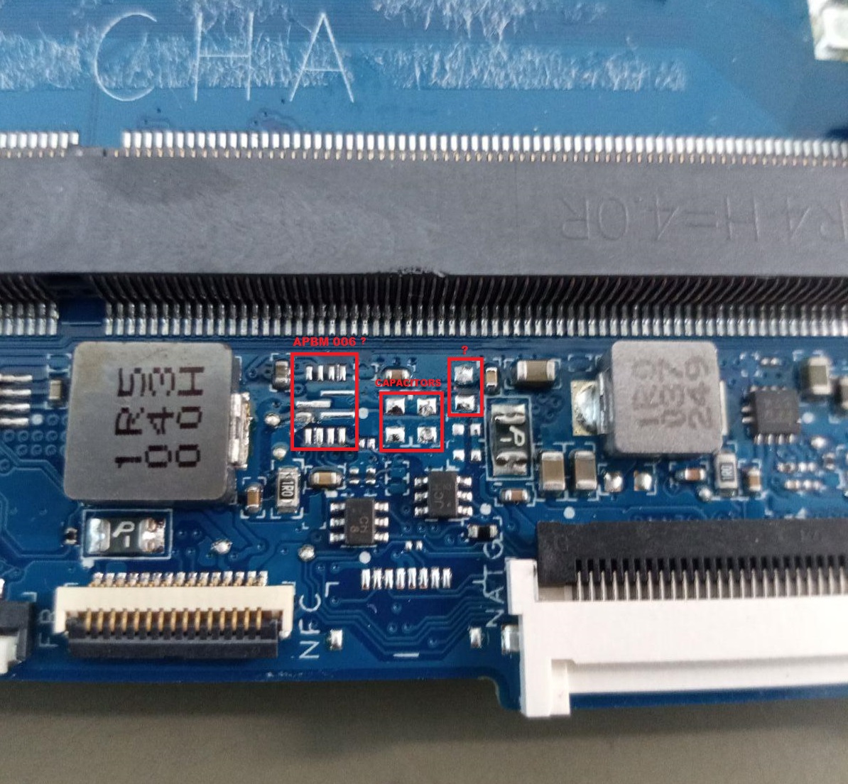

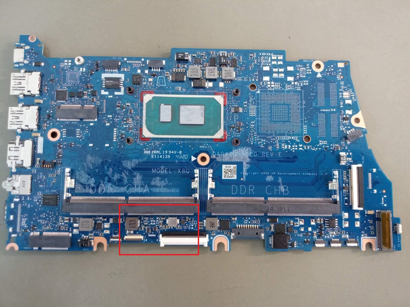

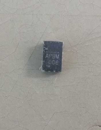

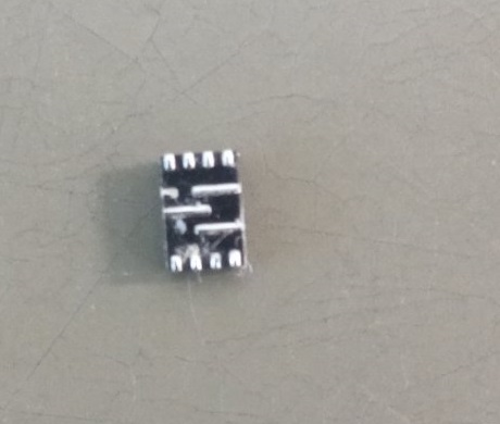

    Hello friends,
    I have a problem in the board da0x8qmb8e0 rev e.
    The ic "APBM 006" has problem and I can't find what part is that!
    I attached photos.
    In photo "da0x8qmb8e0 rev e" I have and one part with "?". Can anyone help with that?
    Thank you in advance.
    The schematic and board view are not available.
  • mon2
    • Dec 2019
    • 14035
    Re: Hp probook 640 - g8
    MPS # NB680AGD
    Datasheet is attached.
