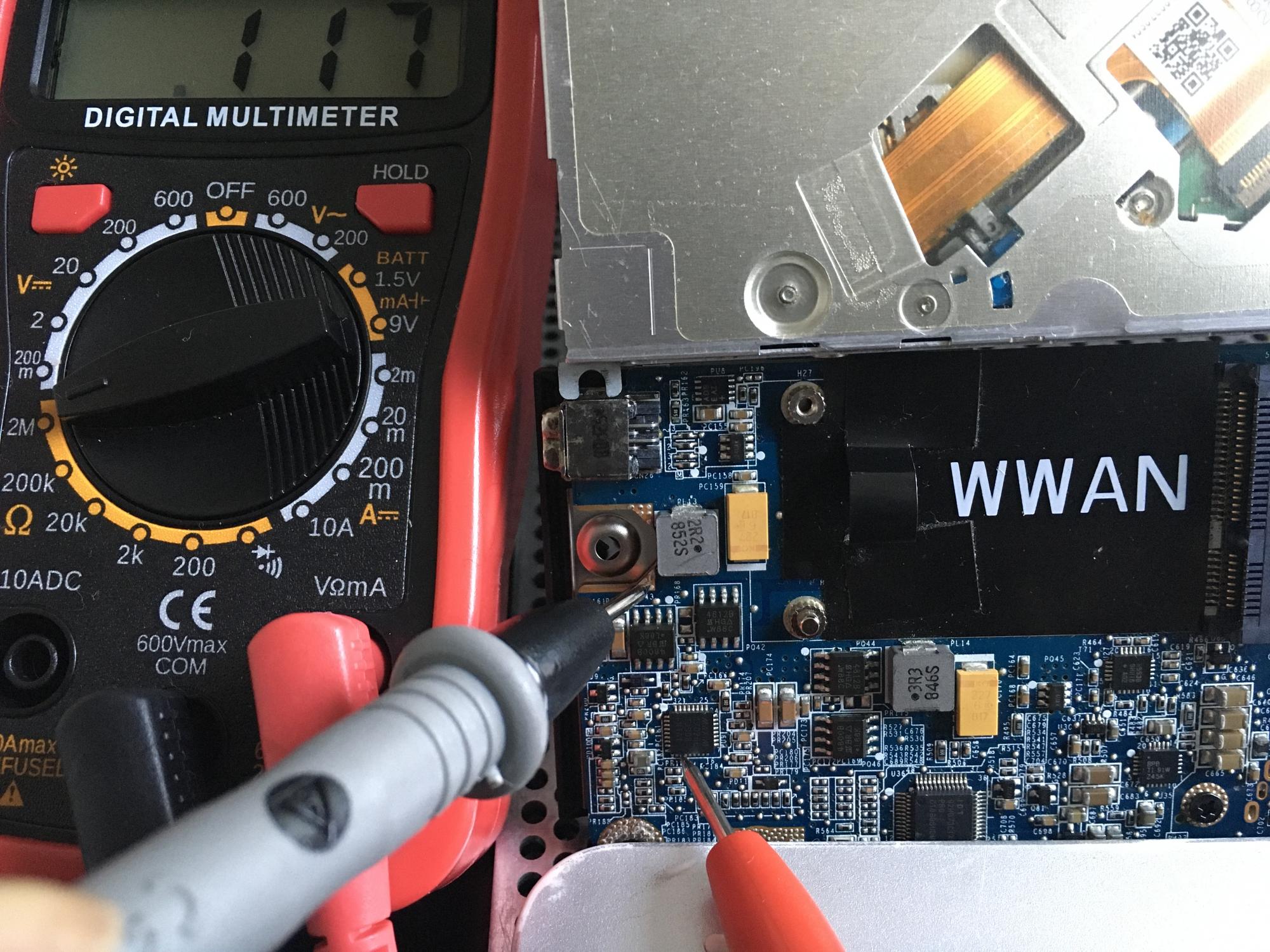

      I checked the resistance on the 5v/3v chip and got nothing on my multimeter. So the chip is shorted?

        Re: Dell studio xps 1340 (DA0IM3MBAG0) hot System 5v/3v chip
        What is the exact measurement on your multimeter? Can you share a pic of the measurement from the front face of the meter?
        Is your meter auto-ranging for the resistance scales or is a manual select version?
        If manual select, if the range is too low to measure, the meter face will show '1' or 'OL' for over limit. At that stage, select a higher resistance scale till the meter can offer a valid measurement.

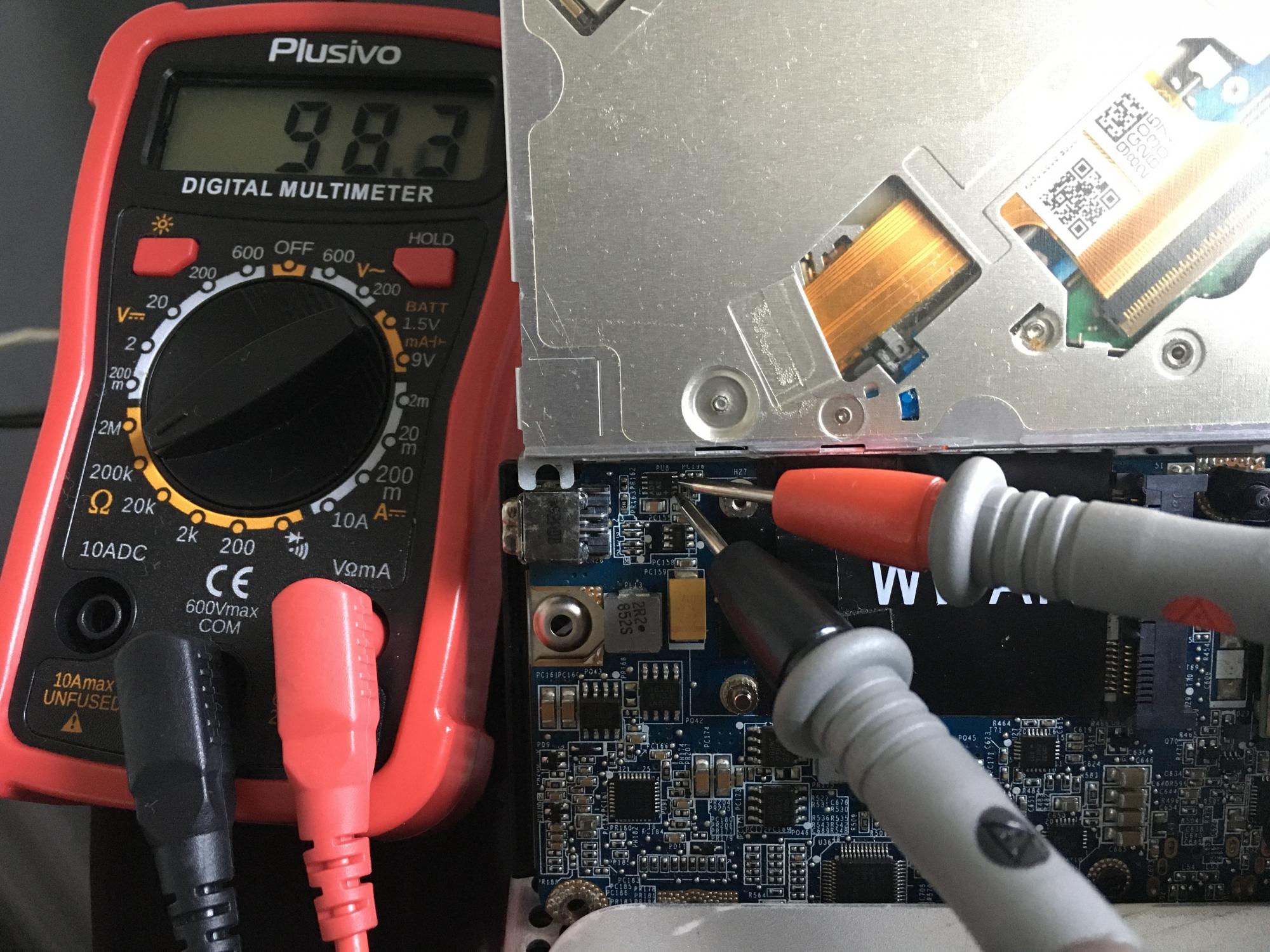

            The angle is awkward but this is the resistance shows 98.3

              This resistance of the 5v/3v chip is .117. This resistance kept increasing. I took a a picture when the reading slowed down.
                Based on the pic in post #6, the measurement is ~98k ohms.
                Switch to the next lower scale of 20k. The meter should show '1' or 'OL' for over limit. This confirms that the measurement is > 20k ohms. No fault here.
                  Measure in 200 Ohms range. Everything else is simply useless and confusing at this point.
                    My multimeter doesn't give a reading when set to 20k or below for pin 7.

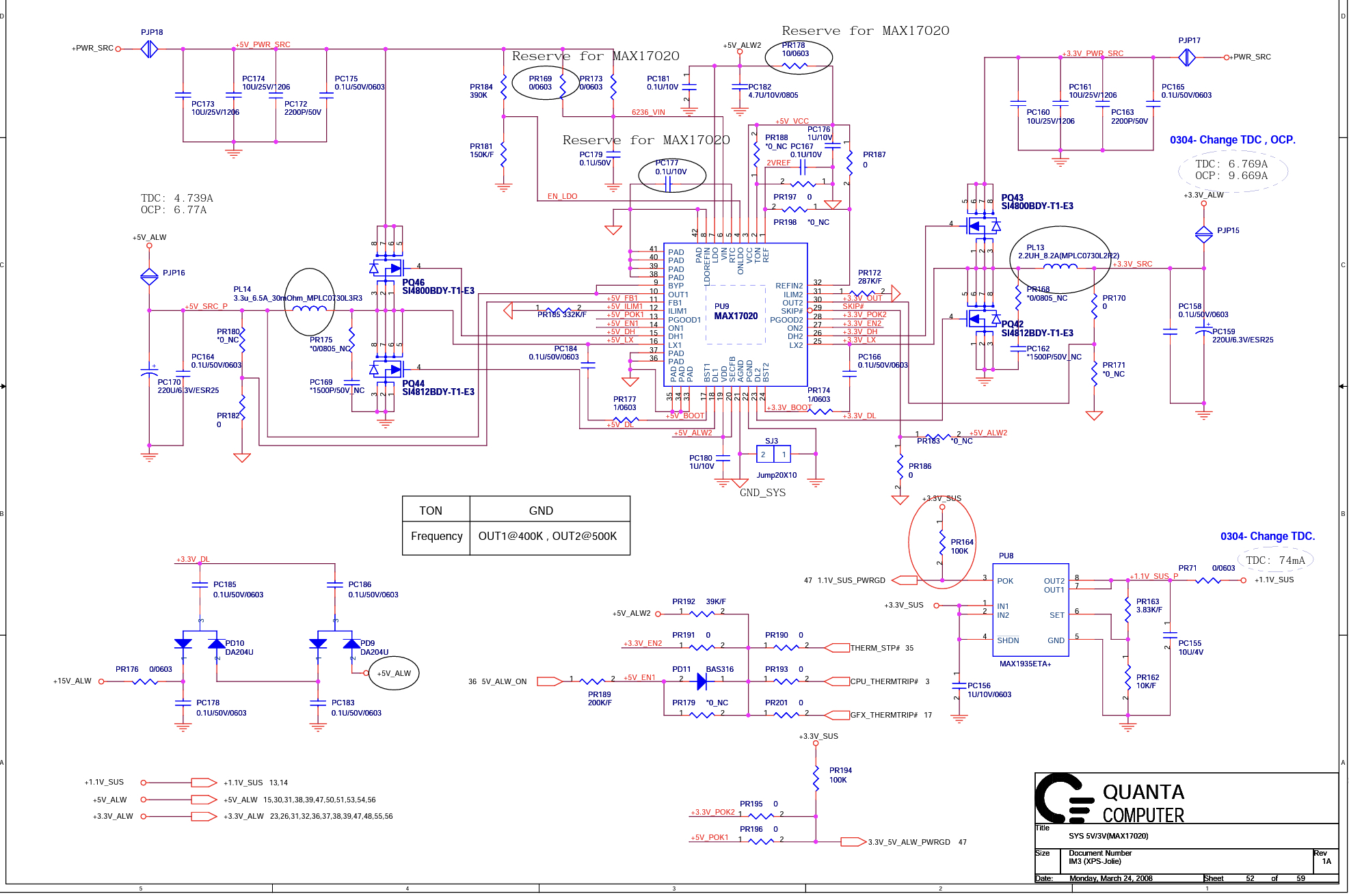

                      The pic in post#6 doesnt correspond to 3v/5v PWM. I think i have different schematic. Please link your schematic to avaoid confusion. I used Quanta im3(jolie) rev 3A

                        The schematic I was linked to on the forum was rev 1B. I have access to 3A and 1B and can use either moving forward.
                        https://www.badcaps.net/forum/showthread.php?t=118930
                          Both the version show 3v/5v regulator as PU9 and its MAX17020. Look for this chip and measure resistance on pin7. the chip may be with other name like TPS51427/PM6686/ISL6237
