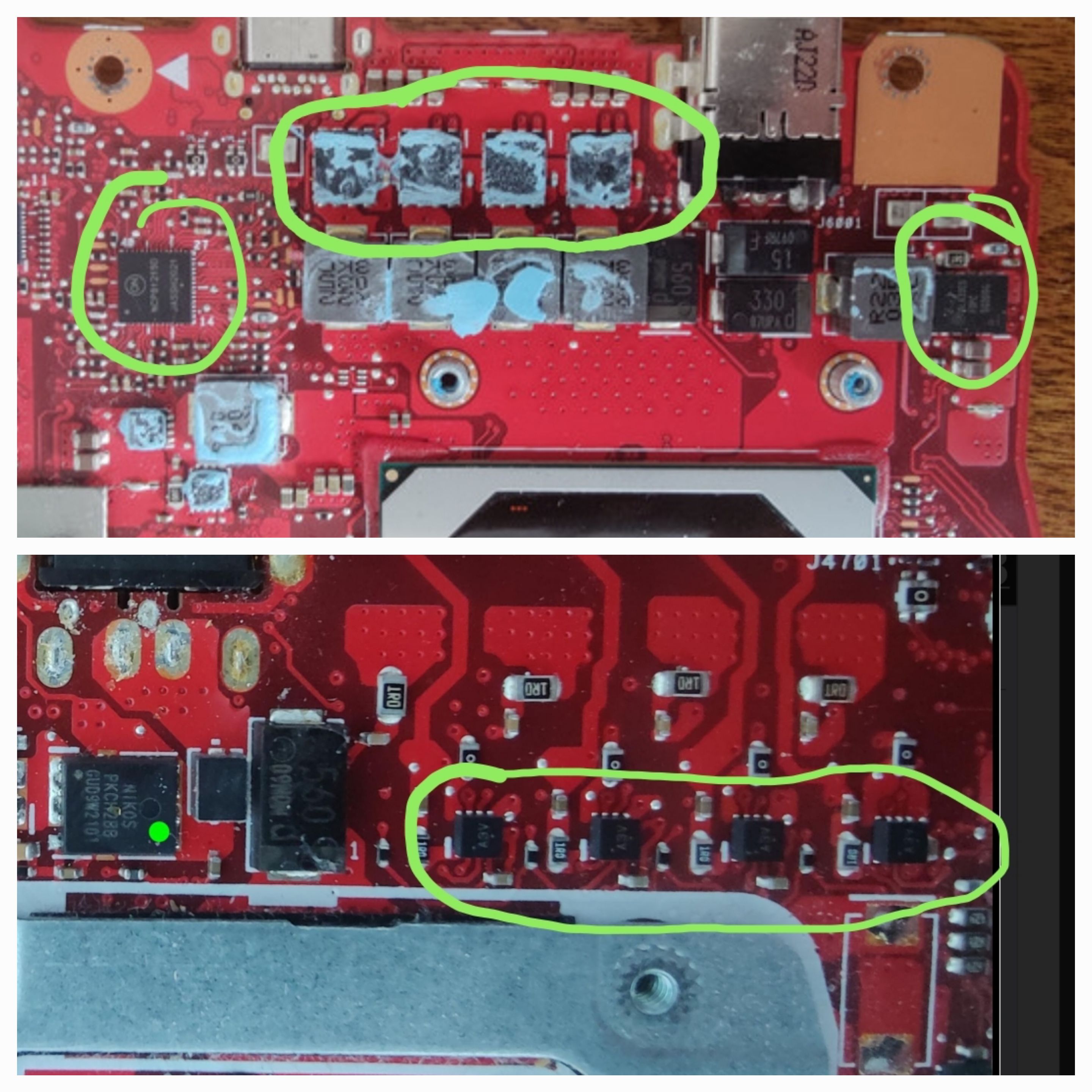

                  I replaced the two MOSFETs as well as PR8904, PR8905, PC8905, PR9024, and PD9002. I was still getting about 1.7 V at ACDET (with battery IC removed) I proceeded to desolder pin 2 of PD9002 to isolate the circuit from AC_BAT_SYS and got a nice 3.2 V at ACDET (the 20KOhm from the voltage divider was replaced with 24.3 KOhm so that makes sense). It appears the issues is coming from the AC_BAT_SYS line.
                  There is continuity with ground on the AC_BAT_SYS line. I removed PQ8903, PC8901, PC8902, and PC8903 but the short is still there. What should I do next?

                    I also visually checked the rest of the AC_BAT_SYS line and didn't see anything odd. There are so many capacitors and resistors connected to this line... Is this the kind of scenario where I would inject 1 V then 2 V and so on and check what gets hot?

                      AC_BAT_SYS is the main source line for powering almost every rail-so problem could be with one of those rails. It's difficult to find which rail is pulling AC_BAT_SYS line to GND. Best option is to inject 1V(not more then this)/5A on this shorted line and see which area heats a bit. Perhaps you wont feel any burning component but very slightly warm area of the board will give you an idea of possible shorted component. You may leave 1V/5A injected for 10-15 mins if you dont find anything hot.

                        I tried this. First, I noticed that at 1 V, the amp draw is 0.87 A. My understanding is that it's not fully shorted to ground or it would draw up to the limit I set on my bench PSU which was set to 2 A. I found that U0301 was getting warm (>30 C). This is the Intel Cometlake-H processor. Same with all the capacitors on the other side of the board where U0301 is. Is this normal?
                        In case this helps, the resistance to ground on the AC_BAT_SYS line is 2.6 Ohms.

                          That's a typical so called high-side short, means for this case, the Mosfet of the buck converter between the Main power rail and the CPU Core supply is internal shorted and has probably send 19V into the CPU already. Usually That's a dead-end.
                          However, in some rare cases the CPU survives that might work again if you replace the whole buck converter (all semiconductors) related to the CPU Core supply.
                          Since we (also myself) were confused with ACDET line in addition, we actually missed to do a simple resistance measurement of the main power rail. Otherwise the issue would have been clear from the beginning.

                            Thanks! I might as well try that. I'm not sure how to find the buck converter for the CPU core supply. Can you tell me where it is on the schematic or what the abbreviation is?

                              Re: No power on G512LI
                              If you want to stay safe, everything which is circled here. However, I suggest to confirm the diagnose by lifting either each coil or each of the dual-mosfets, till the short of the Main power rail (AC_BAT_SYS) is gone
