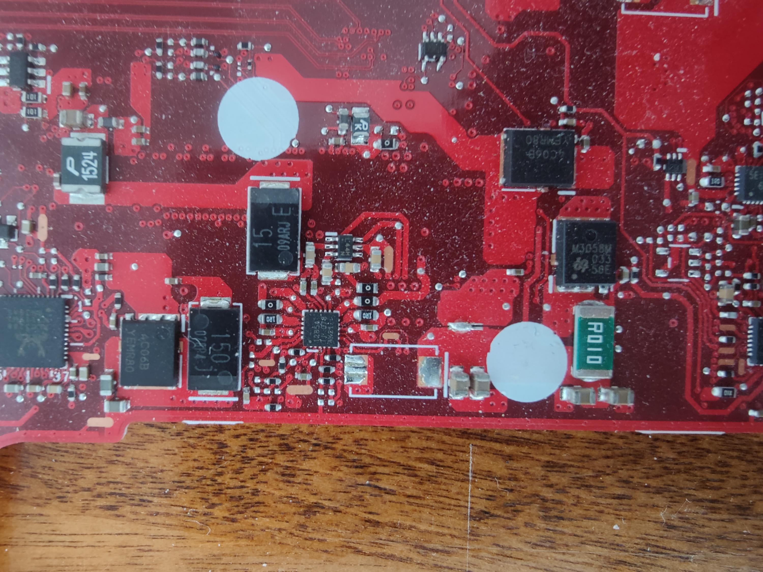

    I received an asus laptop G512LI that doesn't power on. Apparently it suddenly turned off. There was no spill or anything like that.
    I have some/little experience fixing boards. I have not been able to find a schematic and boardview for this board. Are there other motherboards that are similar for which there are available?
    So far I've determined that the adapter is providing 20.2V at J6001 and there is 0.12V on pins 6-8 and 0v on pins 4-5 of PJ6001 (the battery). The badcaps guide says to "check the voltage after the 2nd DC-in MOSFET and after the current sensing resistor for AC adapter power input.". I m not sure how to find these without a proper schematic and boardview.
    How can I easily determine whether it's the battery or something on the board?

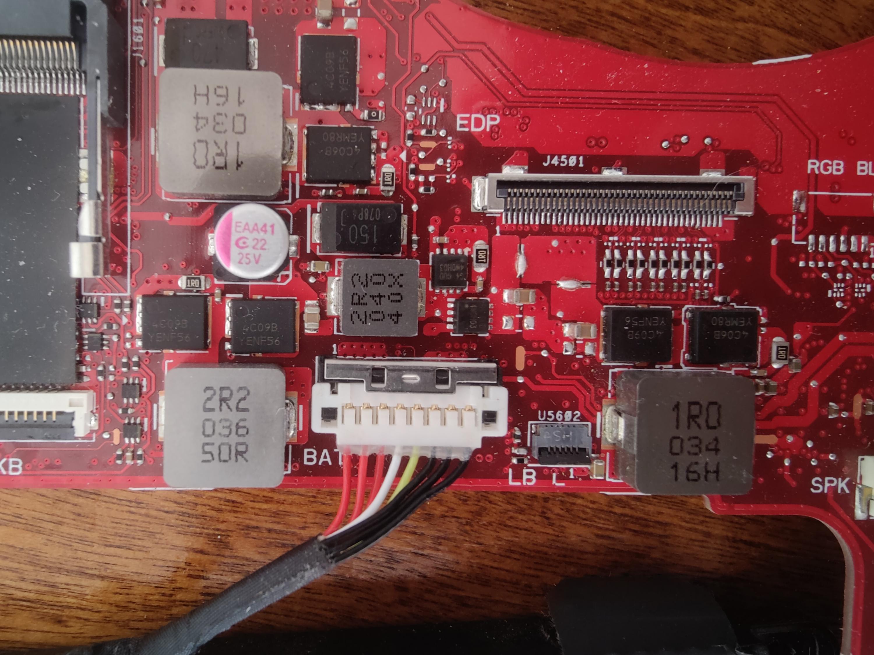

      Here are the front and back pictures of the DC jack and battery connectors. I put green dots where I think the MOSFETs are for the DC_JACK. Is that correct?

        Yes. Download the datasheet for each mosfet to review the pinout. Then without power to the board, measure the resistance across the pins.
        Source & drain
        Source & gate
        Gate & drain
        Post each measurement.

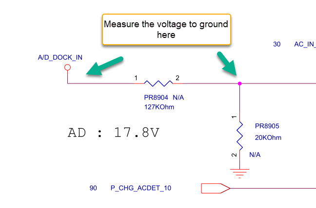

                  ACDET should not be 0 volts when the power adapter is plugged in.
                  Locate pr8904 that is use for the ACDET circuit.
                  Measure the voltage to ground on each side of this resistor.
                  Remove all power and with meter in resistance mode, measure the resistance across pr8904.

                      ACDET is still too low of a voltage for a good adapter voltage.
                      This pin should be 2v4 or higher and only then the charger IC will consider the adapter voltage to be suitable to power the logic board and charge the battery.
                      See here:
                      https://ohmslawcalculator.com/voltag...der-calculator
                      Input:
                      18volts. ; Minimum expected adapter voltage is 17v8
                      127000 ohms ; r1 = pr8904
                      20000 ohms ; r2 = pr8905
                      And then press calculate. Your true voltage on the logic board should match or exceed this calculator voltage.
                      Proceed to review the resistors pr8904 and pr8905 and check each resistor value. Something is wrong here.

                        I got 75.5 Kilohms for r1 and 18.8 Kilohms for r2. Based on the calculator, that should give me about 4 V. Does that mean the charger IC is shot?

                          Re: No power on G512LI
                          See attached.
                          1) measure the voltage to ground on each side of PR8904.
                          Post the measurements.
                          2) Remove all power -> meter in resistance mode.
                          Measure the resistance to ground at the common junction of PR8904 & PR8905.
                          3) Yes, the voltage to ground at the common junction should be ~3v5 based on your measured resistor values but it is not so someone is pulling down this line or the resistors are defective.

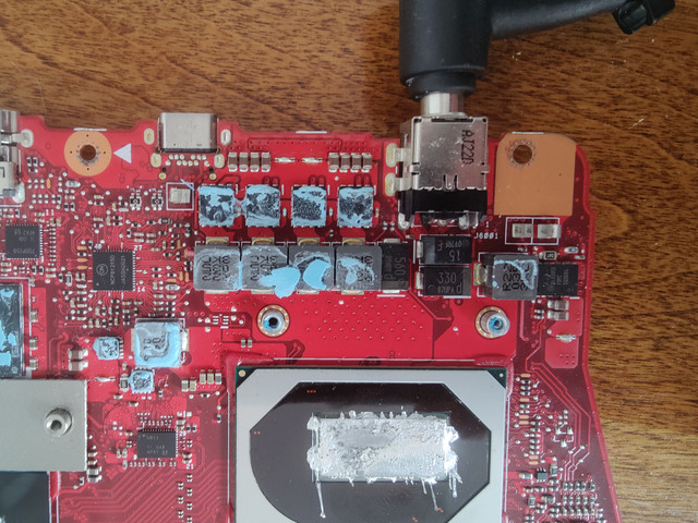

                            A picture of the ACDET curcuit location would be nice and resistors have to be checked out of circuit. Don't miss there is also a Short protection circuit connected, consisting of PR9024 and PD9002. ACDET voltage is supposed to be 2.6 Volts here

                              I got
                              20.2 V on pin 1 of PR8904
                              1.69 V on pin 2 of PR8904
                              Resistance to ground at the common junction of PR8904 & PR8905 is 18.8 Kilohms
                              • vrasp
                                • Nov 2019
                                • 194
                                On PD9002 I got
                                Pin 1: 1.09 V
                                Pin 2: 0 V
                                Pin 3: 0.6 V
                                PR9024 resistance to ground
                                Pin 1: 78 KiloOhms
                                Pin 2: 91 KiloOhms
                                PR9024 voltage
                                Pin 1: 20.2 V
                                Pin 2: 0.6 V

                                  Resistance of pr8905 is matching the schematic values.
                                  Pr8904 resistance is not.
                                  Carefully flux and remove pr8904 resistor. Do not lose this part. After it is removed, measure the resistance of pr8904 while it is on your work table.
                                  Suspecting that pr8904 will not match the schematic value.
