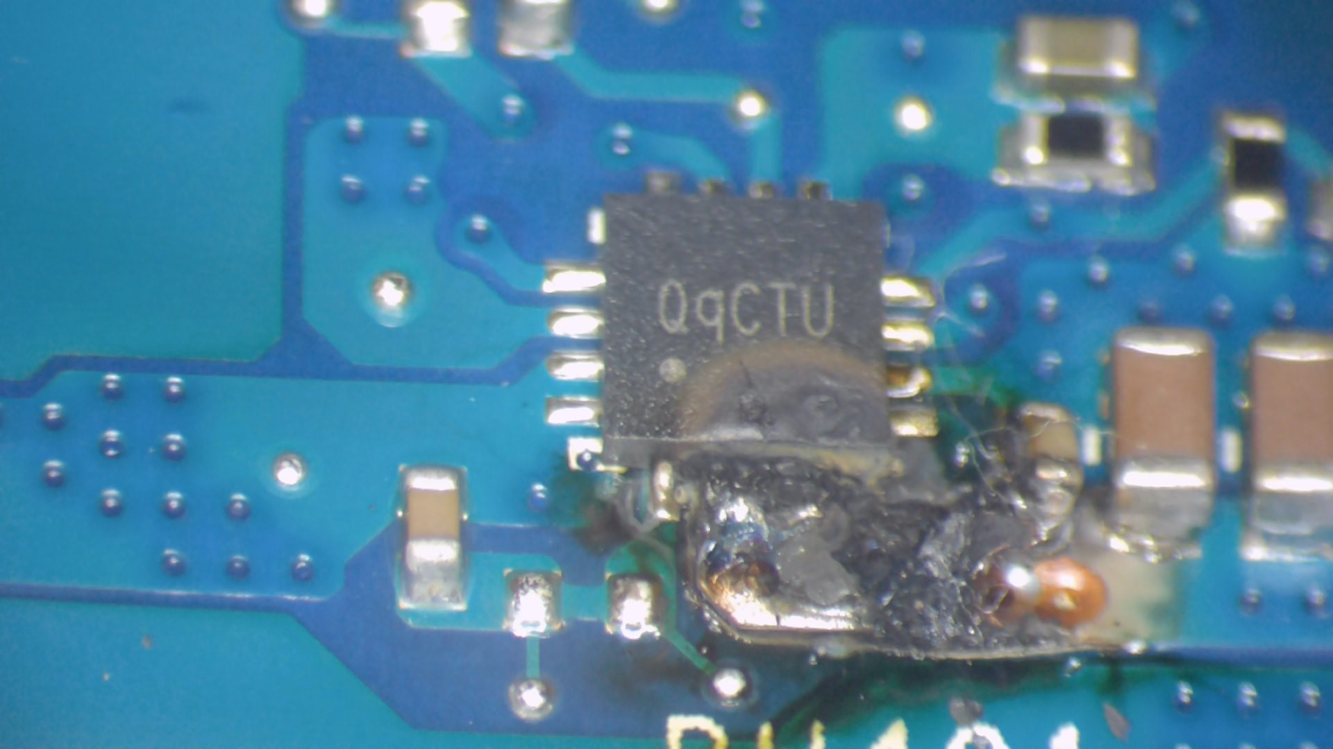

    IC code QqCTU, what is it?
    Hi, I have a motherboard with this component burned, there is no schematic. Does anyone know what it is? The MB is LA-H103P

    Re: IC code QqCTU, what is it?
    Sy8386brhc
        https://www.badcaps.net/forum/showpost.php?p=1046381
        Qq*** SY8386BRHC - N/D (EL432 EL532 LA-H131P)
