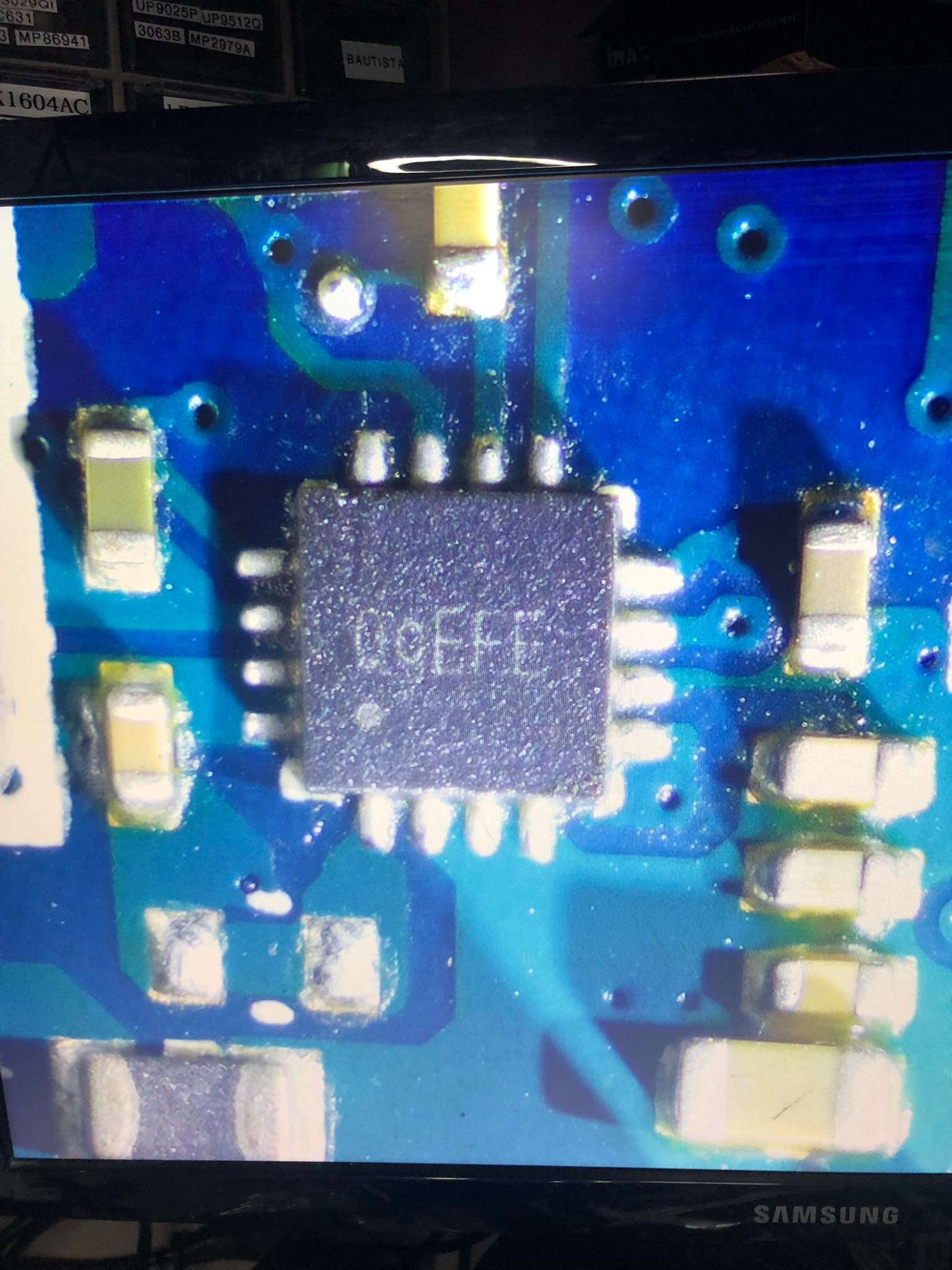

    Hello, first time I encountered this chip. No schematics or boardview available for this model so need help.

    Re: Dell Inspiron 15 3515 - LA-L245P Component identification
    Look like SY8057QDC for me
      Thanks. Anyone have other idea?
        You have a better view of the first two letters. From picture it is hard to understand.
        Manufacturer is silergy for sure.
          Hi, what voltage do you have on pins 2, 3 and 4. If you have 19 volts then it's a SY8386BRHC.
            Thanks. Looks liek this is the right candidate. Markings are really hard to see as its probably affected by the ic heating up.
