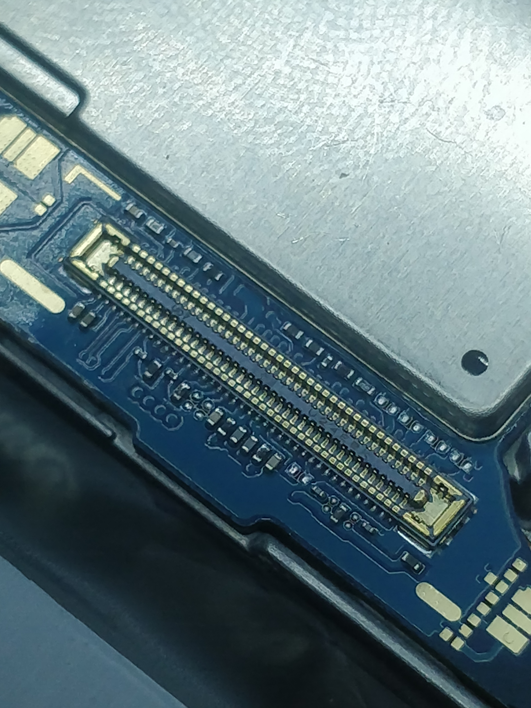

    Now I opened up the phone and I measured the voltage drop on the mb connector and I found everything in place.
    Next i checked the flex cable and the connectors itself, all looks good.

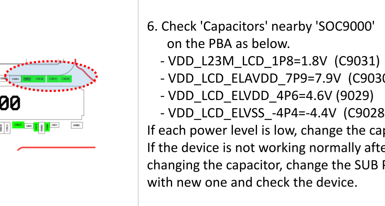

    After some searching, I found the service manual for the phone and after checking the touch - troubleshooting part I found this.
    I don't have those caps on the board where it's mentions I should measure them. The board model number is the same with the service manual's.

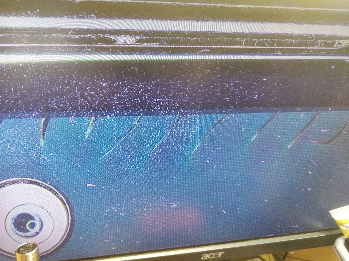

    Also, this is the photo I took of the original display:
    What are those? They are under the glass, looks like burn marks.
    The customer says the phone fall from a TV bench.

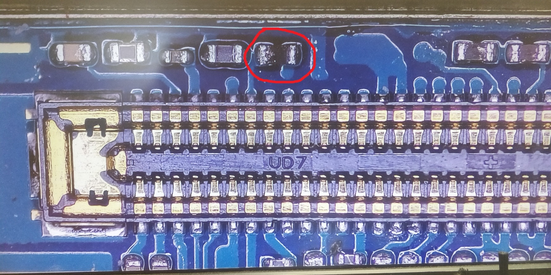

              After measuring every single pin and component around the connector, I found this resistor with a very low resistance across its ends: 30ohm
              Is this normal? No other resistor has this value around the connector.

                I have a functional board and i mesure 30ohms on this resistor.
                You can measure in diode mode each pin on FPC and post back results.

                              Top row pin 22 value is not correct, this pin is directly connected to a resitor.
                              resistor value : 93.3kohms.
                              Check this
                              • unimatrix93
                                • Oct 2021
                                • 339
                                • Magyarország
                                Re: Samsung A53 5G No touch
                                Check this
                                I measure 102kohm on the resistor connected to it.
