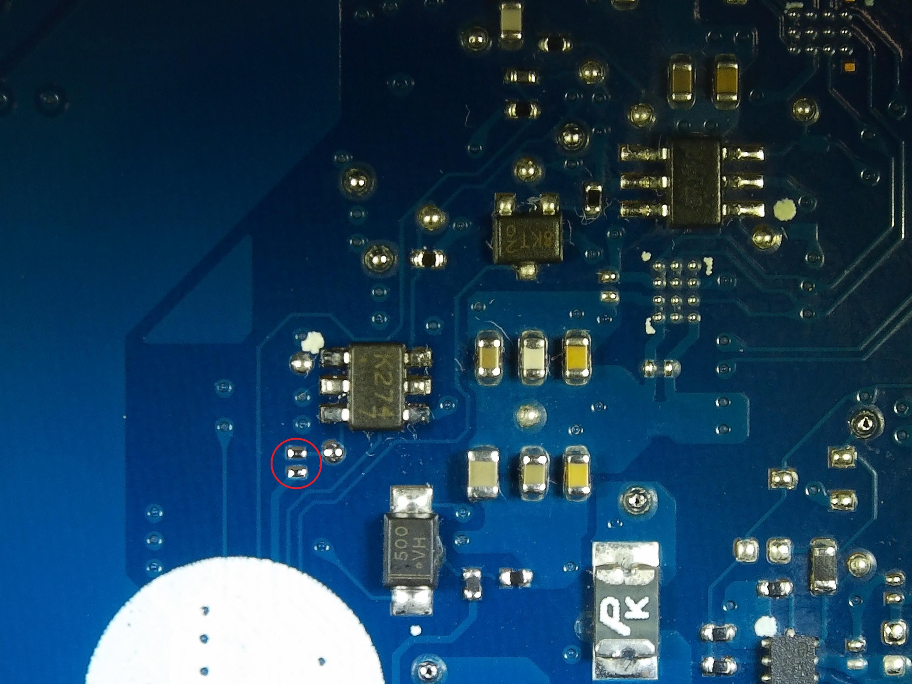

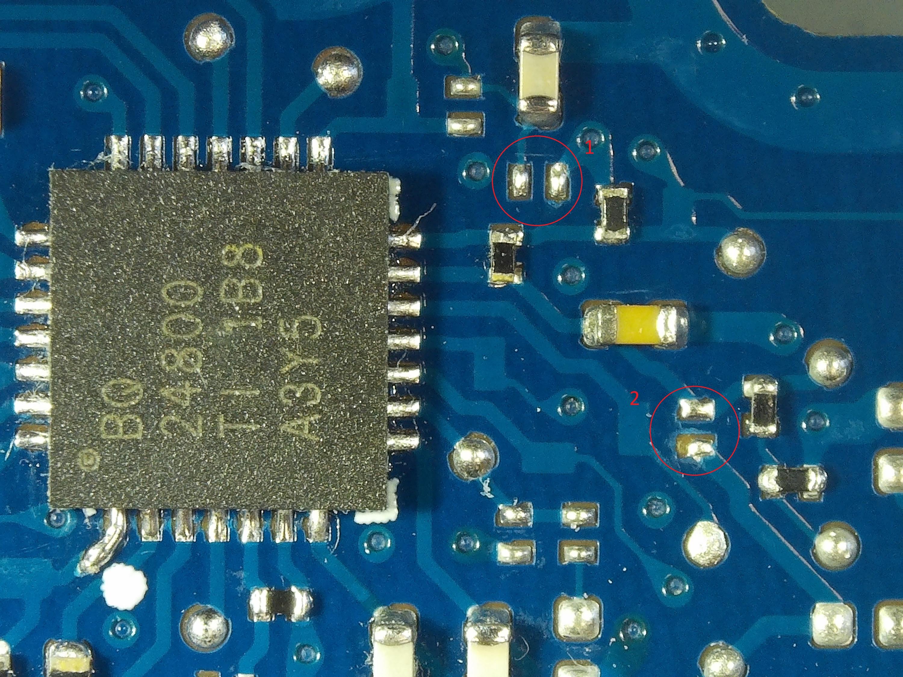

    HP ProBook 445 G8 water damage
    Board: DA0X9QMB8E0
    Board was water damaged un 3 resistors are dead.
    Does anyone know the values of the resistors? (see photo)
  • mon2
    • Dec 2019
    • 14662
    Re: HP ProBook 445 G8 water damage
    Suggestion is to download a datasheet for the charger IC. Then review what you do have on the board and respectively to determine what is missing for the charger area.
    • 7ak7
      • Mar 2011
      • 21
      Datasheet not available
      • mon2
        • Dec 2019
        • 14662
        Well noted. Study the evb schematic.
