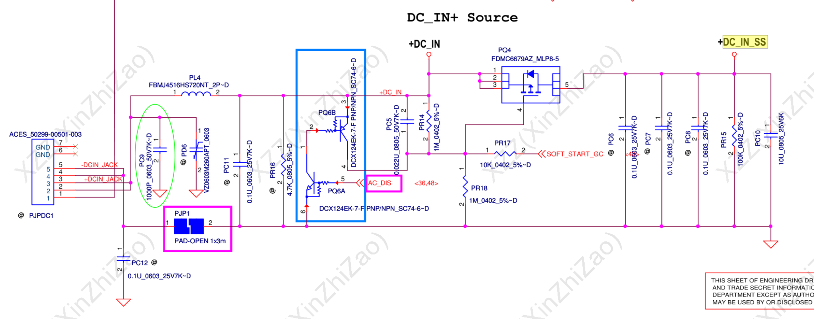

                                      Review the DCin mosfets. Connect the power adapter that is recommended for this box.
                                      Measure the voltage to ground of the mosfet @ PQ4. Measure the voltage @ source (1-2-3); gate (4) and also the drain pins (5-6-7-8). Post each measurement.
                                        PQ4 S= 19.4v , D = 19.4v ,, G = 9.3v
