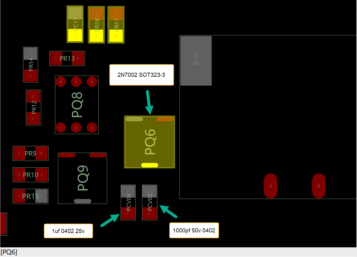

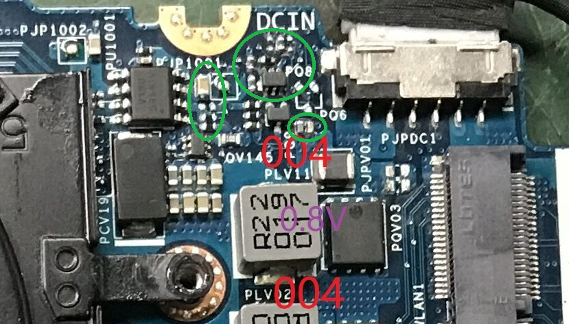

    Hey guys, can anyone please help identifying components circled in green and their respective values/reference .
    Board came in from another "Pro shop" and is missing components. Unable to find them in schematics (using the following as reference: https://www.badcaps.net/forum/showth...light=LA-J091P)
    Motherboard: FDI45 LA-J091P rev 1.0

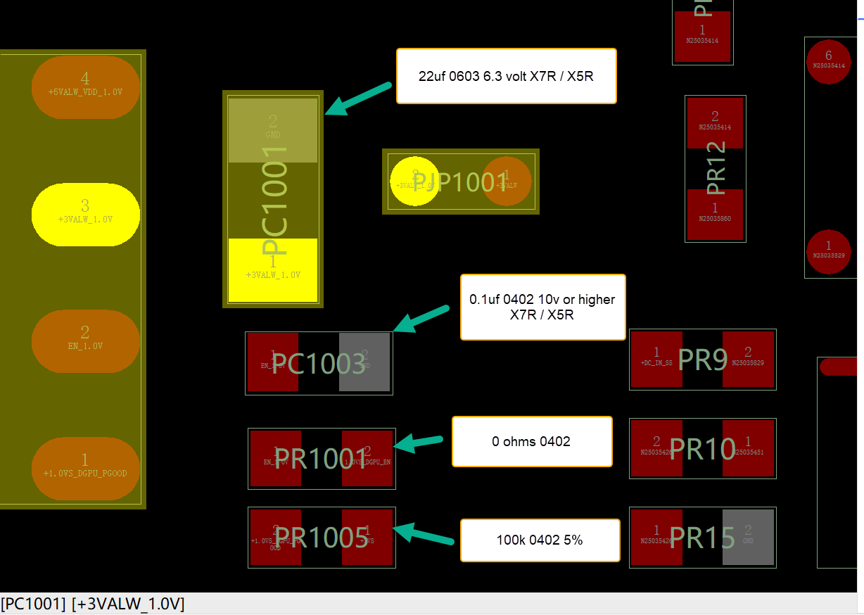

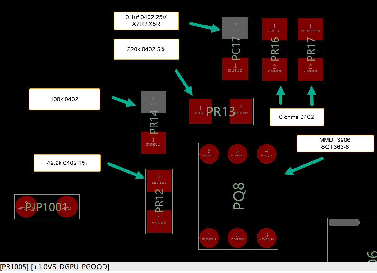

    Re: Help with component ID!!!(LA-J091P motherboard)
    See attached.
    Ok - should be complete now. Got these values from the BV file from my paid sub. As I select the component, the pop-up shows the posted values and package details. Hope they work for you.
    Just updated the last section of the logic board.
      Originally posted by mon2
      See attached.
      Hey mon2, thanks a lot! Can you also please share the components of the other 2 green circles?
