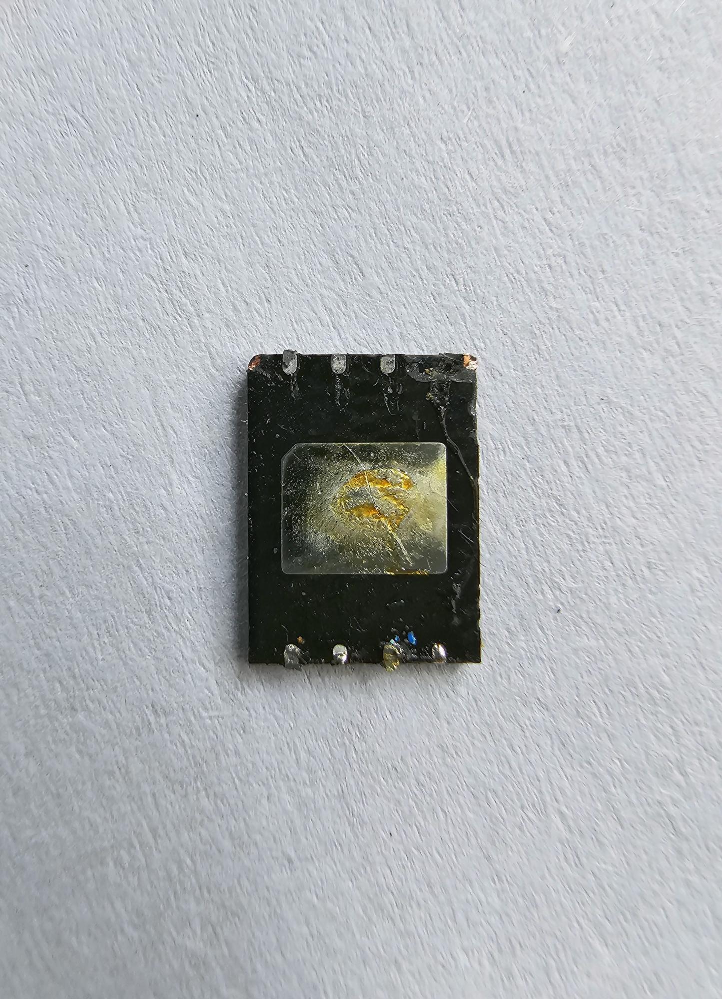

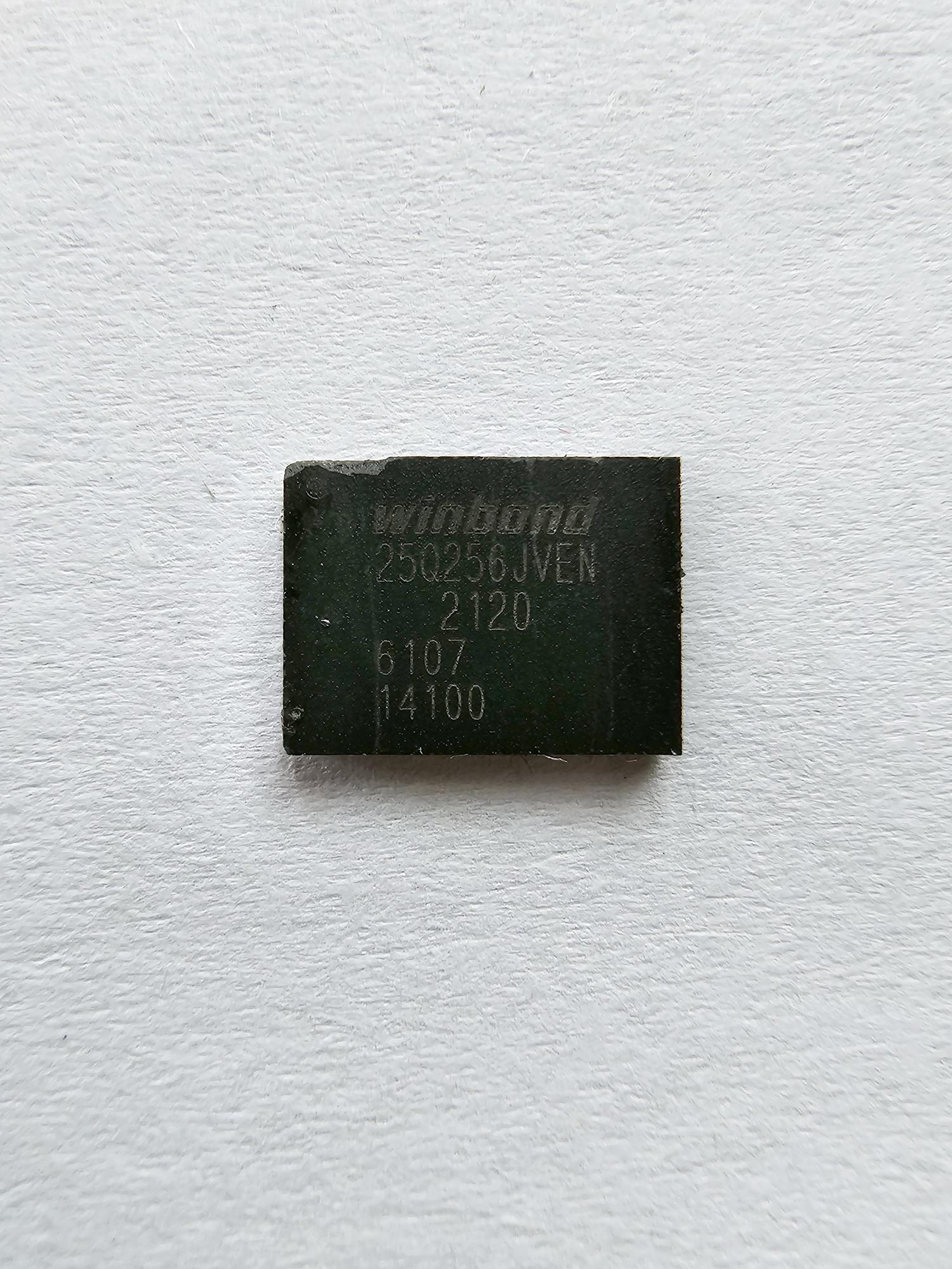

    Hi, I wanted to try to remove the pass on the bios from HP Elitebook 845 G7, but when I unsoldered the "Winbond 25Q256JVEN" chip, a "GND" pin broke, so the chip no longer works (I tried to insert it in the programmer anyway, but it reads another chip). What should I do? Should I buy the same chip, like on aliexpress, and solder it back into the board? Thank you for your suggestion

    Post a picture of the ic with the broken pin.

      I have attached the photo. thanks

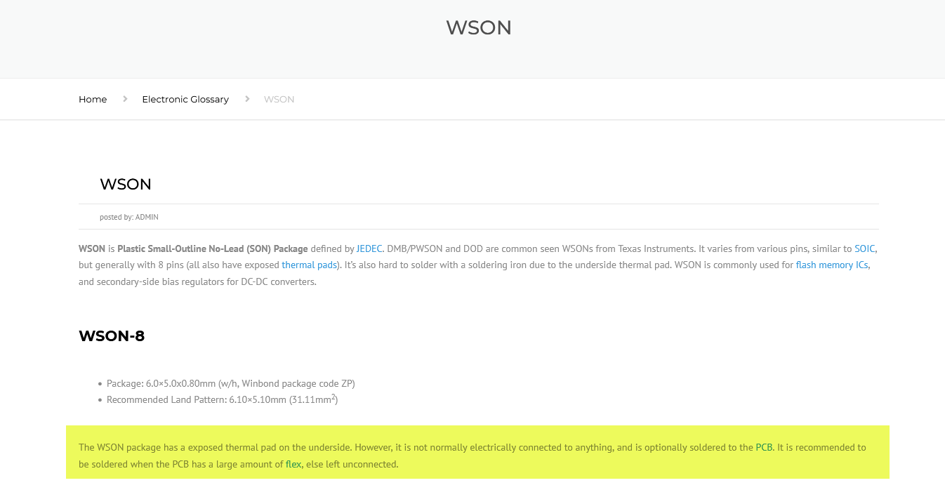

        Attach a wire to the MIDDLE large pad under the chip - fairly confident (but not 100%) that this metal belly is also ground.
        So in your reader, apply the soldered wire to your programmer tool's ground and test if it still works or not.
        Update:
        It is worth testing but also note the attached common footprint details for this WSON package.

          being is a thermal pad and not being electrically connected to anything, it won't work anyway

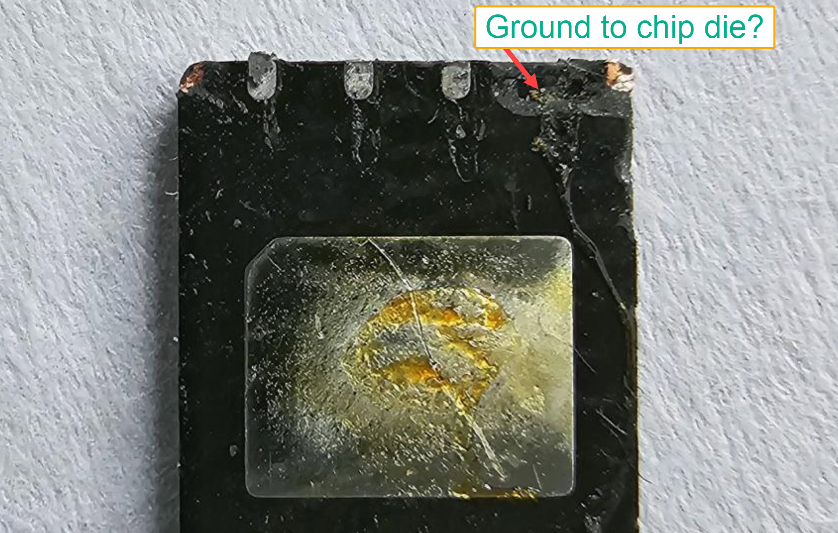

                Yes, it is a bit of a pickle.
                1) you can post the request in the BIOS forum and hope that someone may have a bios image to offer.
                2) see attached - is that a metal dot that could be the missing ground connection? If yes, with extreme care, you could try to drill away some of the plastic housing to allow enough space to solder back a wire for his connection.

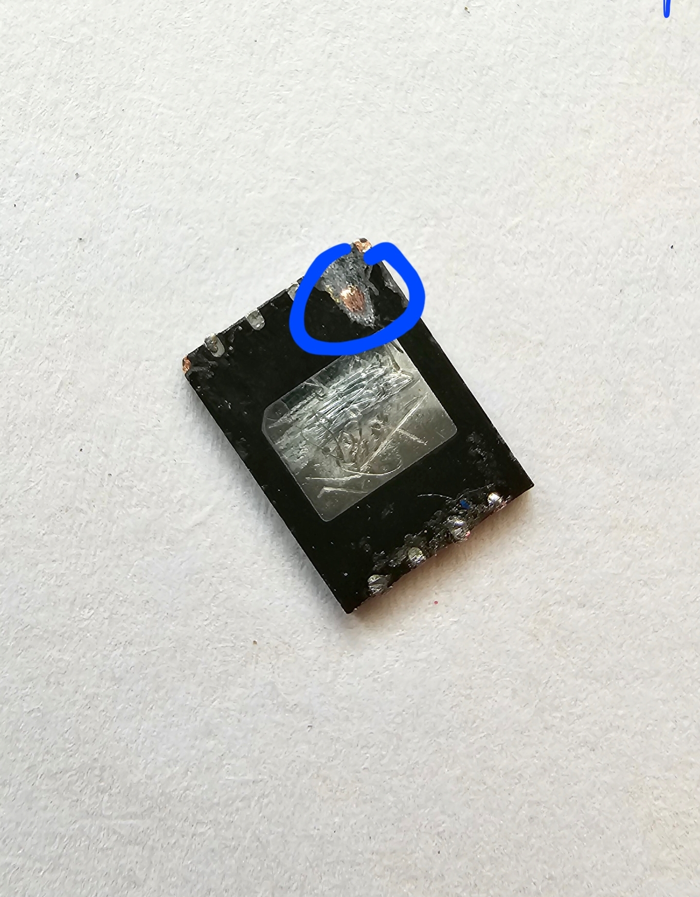

                  i found this. could it be it?

                    It is worth a try
