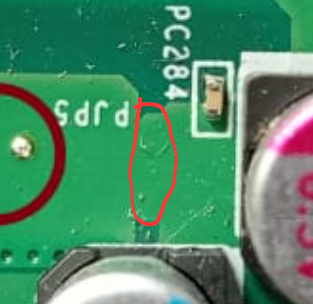

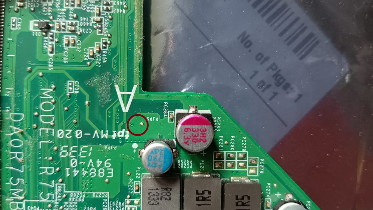

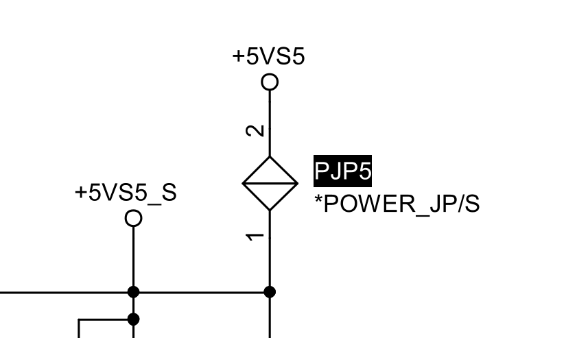

    I have a laptop motherboard in which the S5 power line is shorted to ground. The output generated is going through a power jumper pad. How do I isolate the generation point and the rest of the circuit? Do I need to cut the line or is there any other way?

    With PJP5 is probably this area meant. And as you notice it is physically not present on your board. The "*" in the description also indicates it is not present. The test point has likely nothing to do with the +5VS. You have to lift the related coil instead, so you can at least confirm whether the short is on buck converter or on the load side

      Thanks, that is what I thought after posting this.
