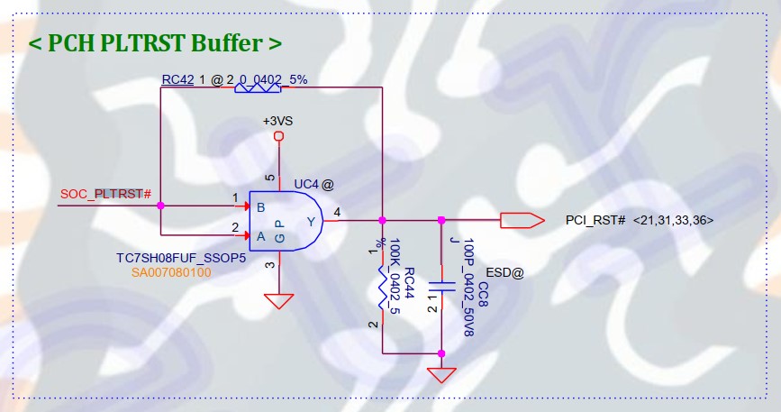

      DRAMRST# is low all the time, about 76mV. PLTRST# is 3.3V. I hope I've found the right place to measure it (picture).

        Yeah, that's fine but also check at Y-Pin for sanity. DRAMRST# staying low is actually a bad thing. Please double-check.

          Y-pin is also 3.3v. RAM is onboard. But there is one DIMM slot. I used good RAM but no effect.
          I've checked DRAMRST# with oscilloscope. It stays low all the time.

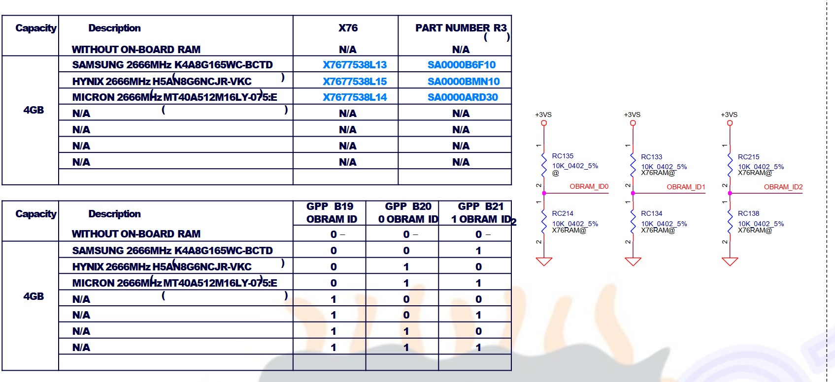

                  I'll bet for a faulty onboard ram here. If you have access to schematic and boardview, disbale the onboard ram and put up a known good ram stick. Lenovo and asus are notorious for onbaord ram issues.

                    ah sure, there is soldered ram. this is the best advice! the amps read are a big clue for ram issue.

                      Hi, sorry for the absence. There is only schematic available, so finding those resistors is imposible for me.

                        Yes, no point trying to disable ram under darkness. Its impossible to do without boardview.
