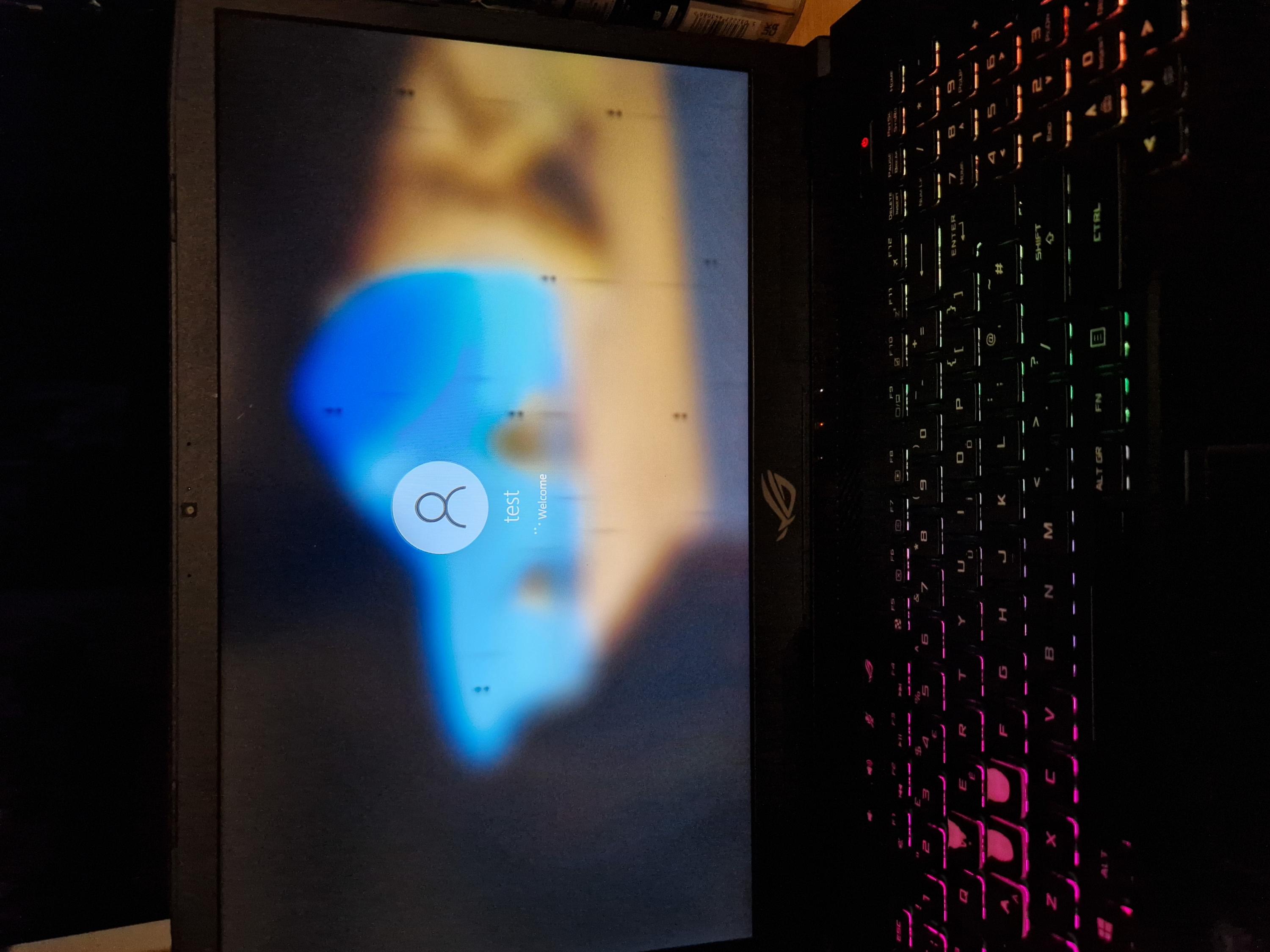

                After my hour and a half long safe mode fun, I booted normally and was greeted with the attached image. I believe this means it's officially a GPU issue and is in fact fucked.
                I did decide to go ahead and try the resistor removal anyway, found it was still 20v on the IC side.
                BUT
                I also found one of the DCin mosfets was shorted to all pins. I'm almost 100% sure I checked this the other day so no idea what that was about. Pulled a fet from a parts board and fitted it, confirmed no more shorts, powered up and got 26v. A small, insignificant win as by this point, every time I load windows and the screen dims, it shuts off. The GPU I think is almost dead.
                If anyone has any other thoughts I'm all ears but I don't think there's much hope for this laptop now. Unless I'm ok to run it in safe mode forever.

                  Yeh, I'd concur with that. I see a lot of cooked GPU's in these gaming systems and tell them just go out and buy a tower. They just don't have adequate cooling when they get a bit of dust in them.
