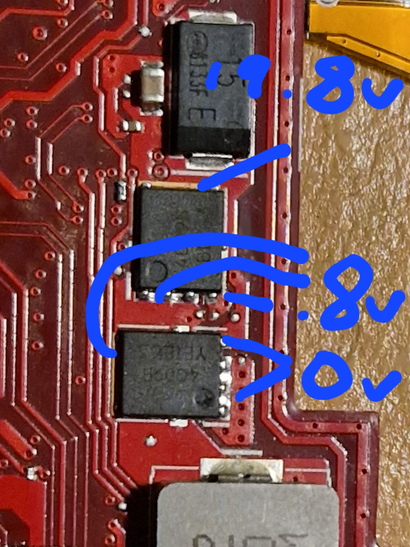

    Just adding pics to make it easier to understand what I mean.

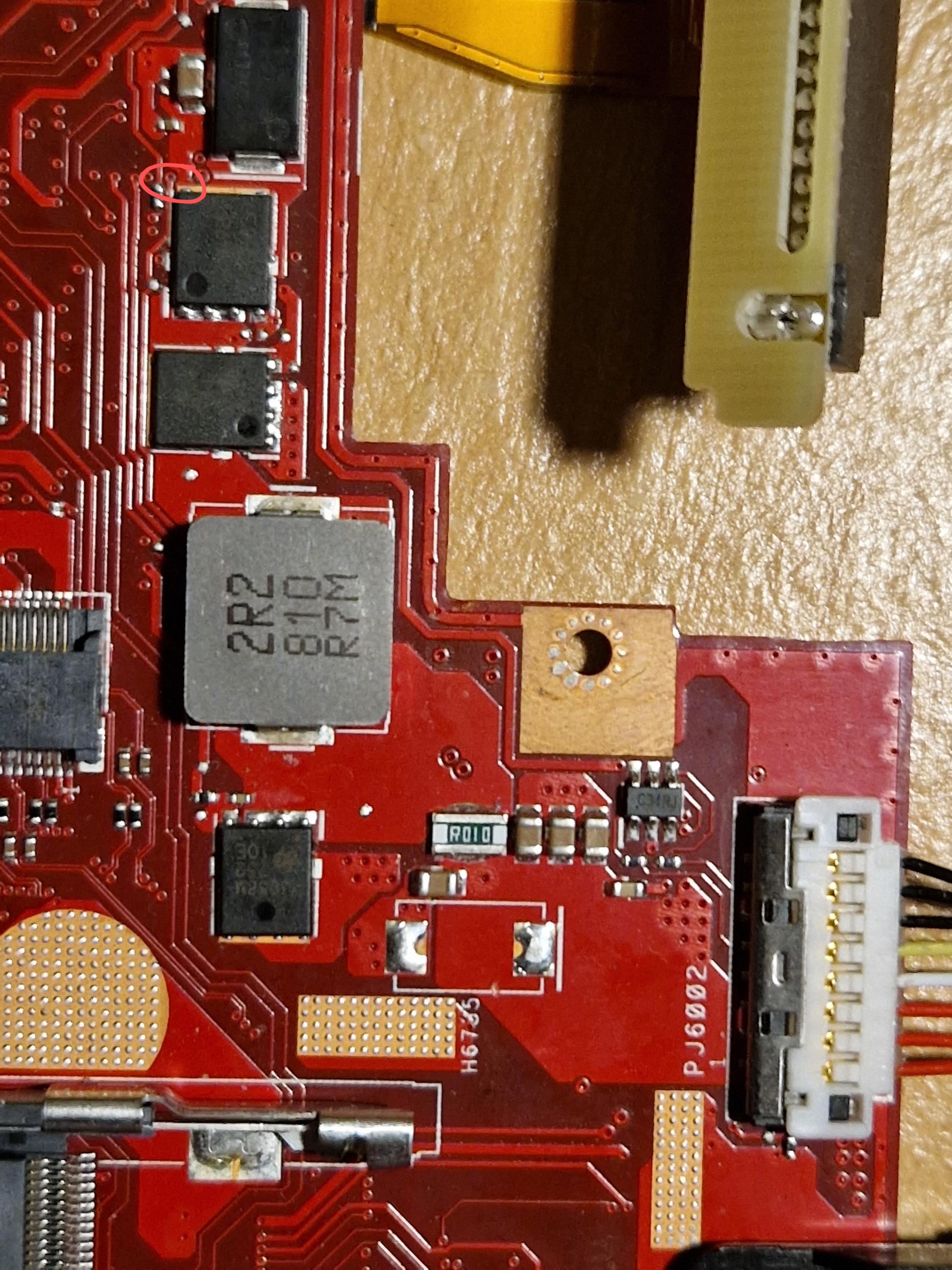

      Only one showed up so here's the other

        Re: Asus GL703GM short
        if all components are working there may be a communication problem between the host and the bq24780s

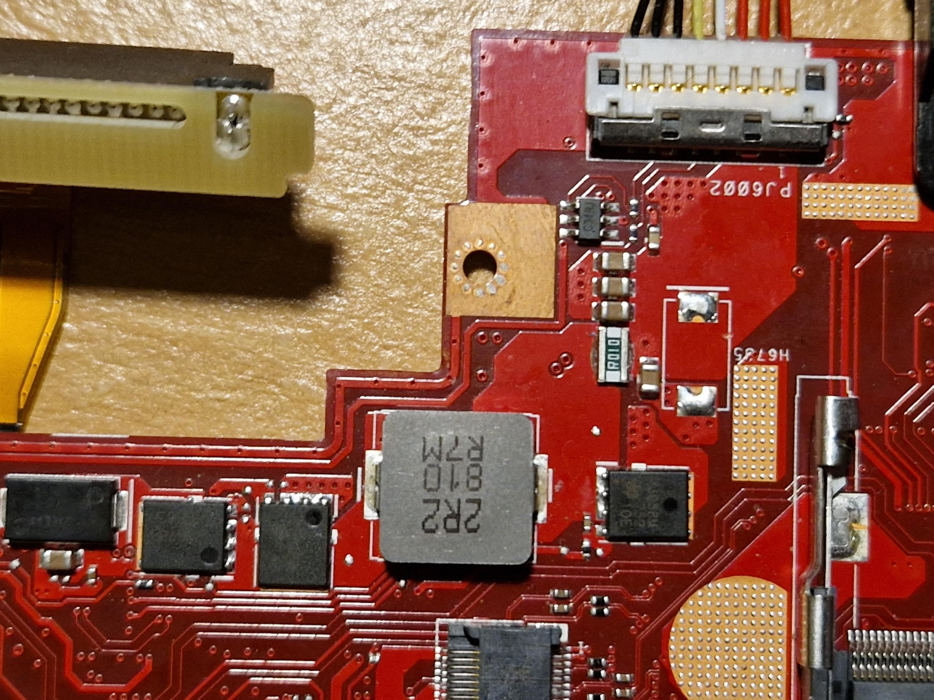

          I will check the schematic. I think maybe the BQ just needs replacing though.
          New problem! I fucked up and bridged the drain of the first battery mosfet with the 5v side of the small resistor that sits under it as in the picture. Now the fans run full blast, all the time. I assume whatever controls the fans is now dead too.
          I'll be throwing this things in the bin by the end of the week due to me making more of a mess than actually fixing it I'm sure

            Just to respond to this, I don't think they are from the readings I posted. ACDRV is only 20v and CMPIN is only 0.6v.

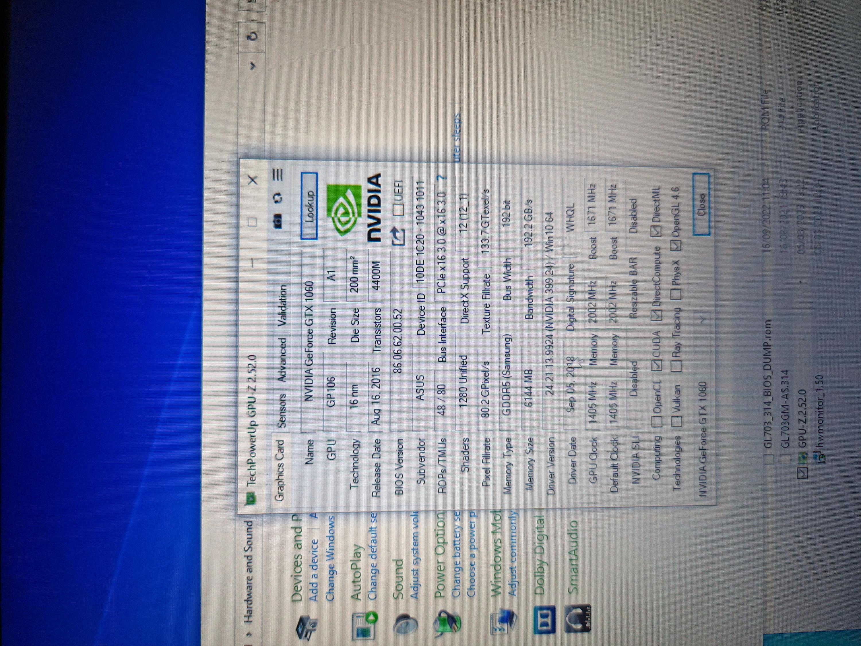

                        I put the readings on post 19: https://www.badcaps.net/forum/showpo...7&postcount=19

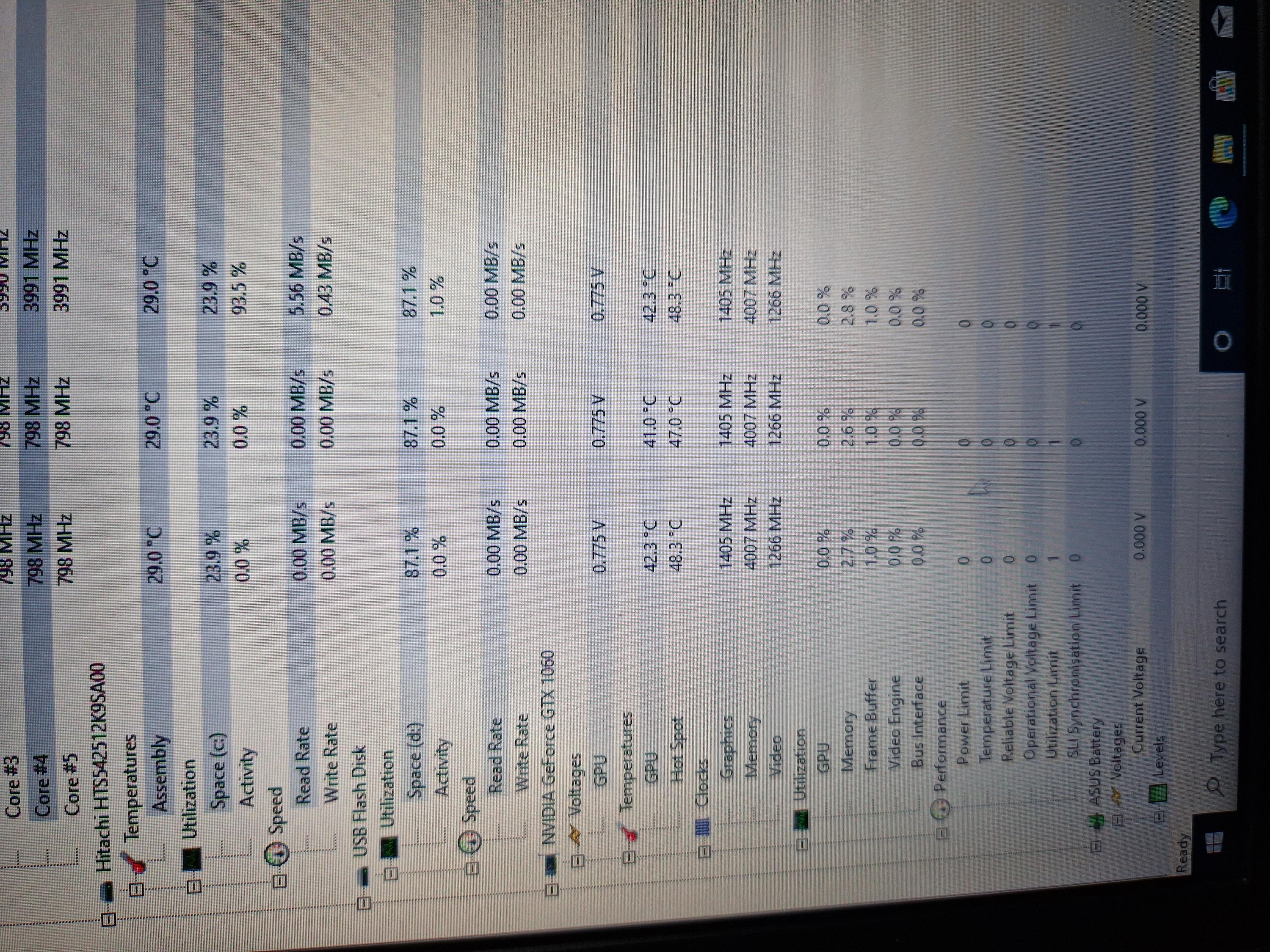

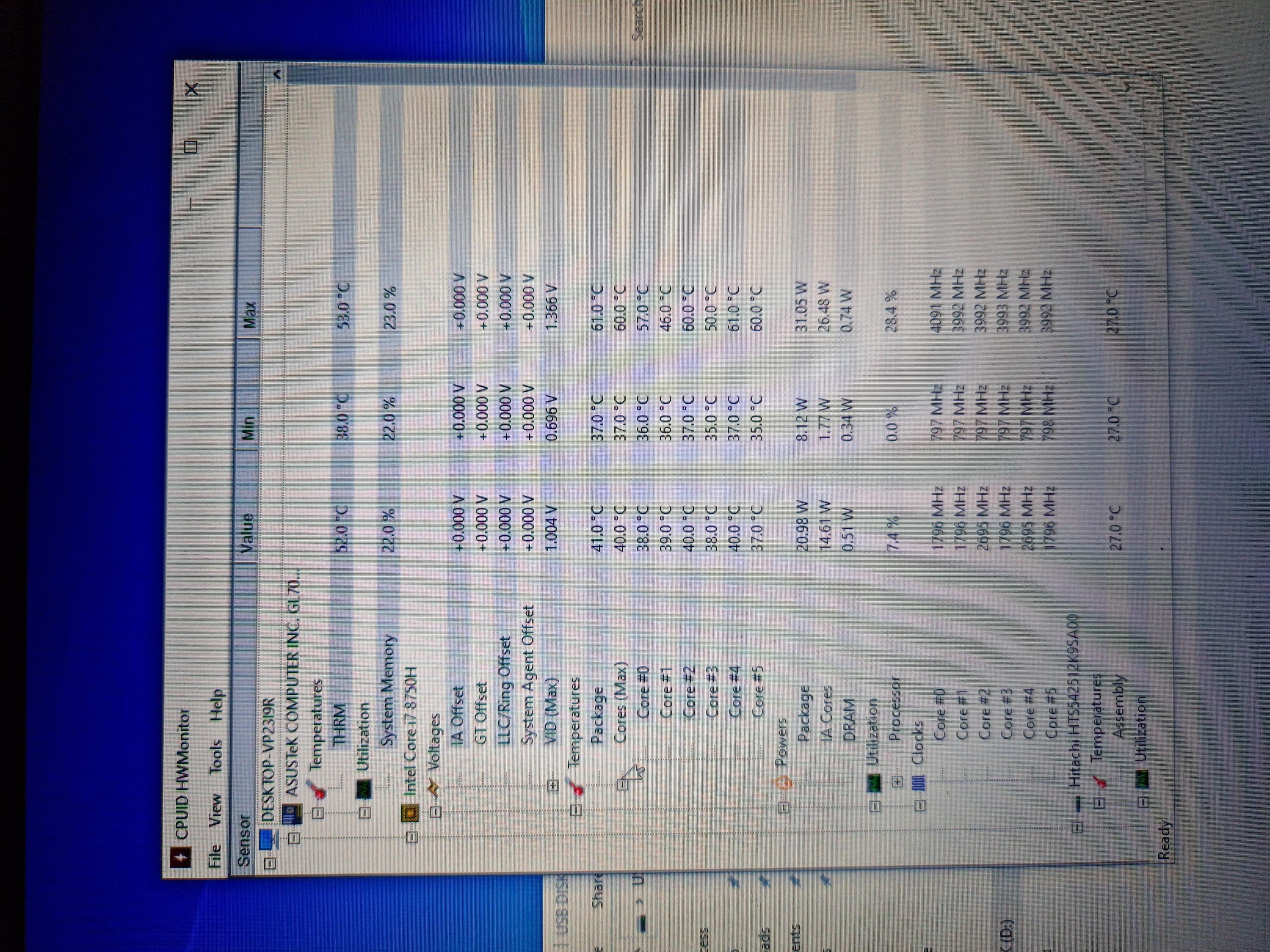

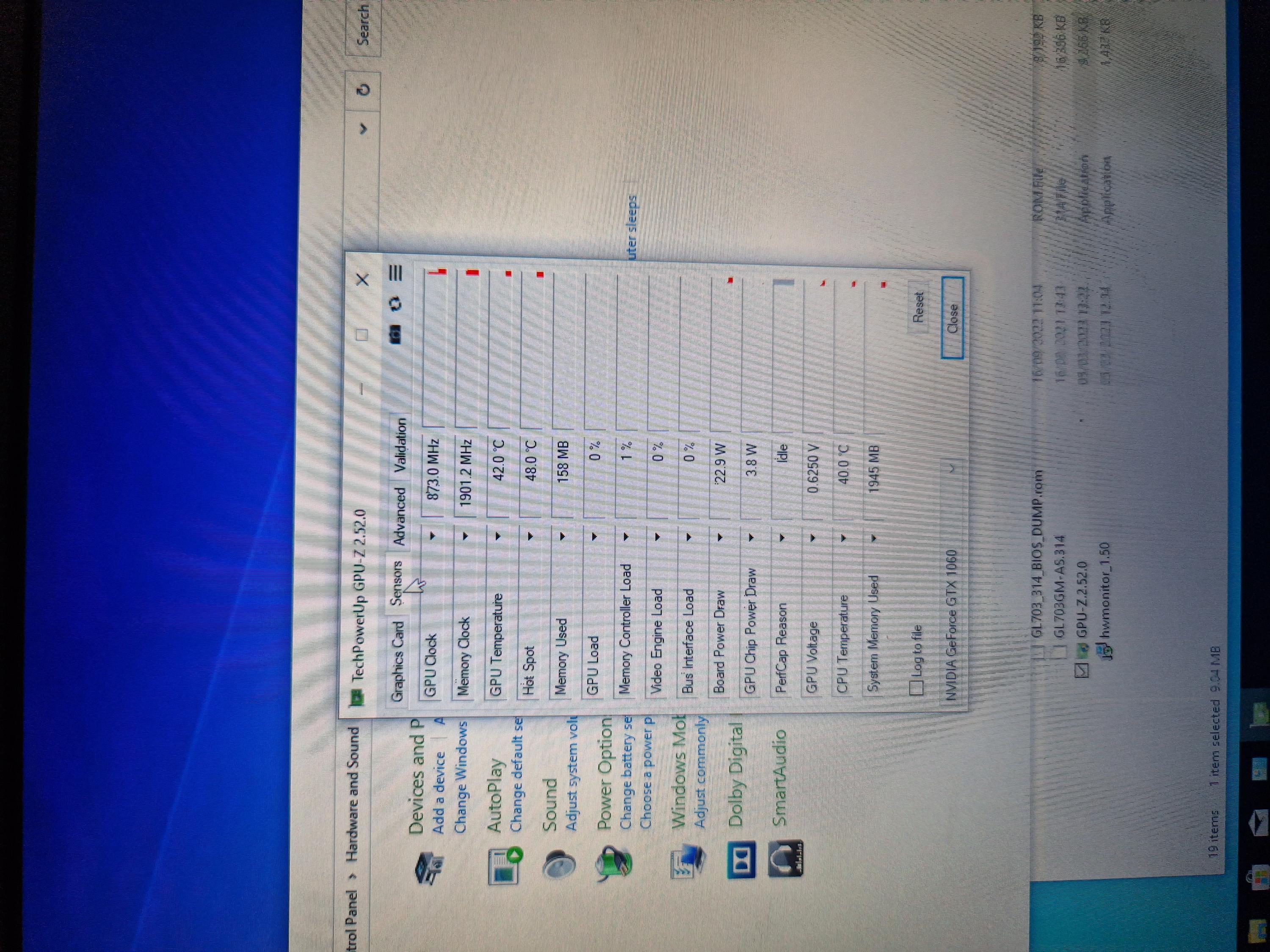

                        I'm probably more interested in the shitting off issue at the moment though. I installed windows 10 on another laptop and then put it in the Asus. Drivers install, all seems fine, then just randomly shuts off (lights on keyboard etc stay on for a moment then all lights go out invluding power). Power button turns it back on.
                        I've attached hwmonitor and gpu-z stats
                            Actually, the CPU package and IA cores do seem to be drawing excessive current considering it's not really doing anything

                                I can try but I doubt it, sometimes it turns off loading windows, other times it will stay on for 15 to 20 mins, there doesn't seem to be much of a pattern to it.

                                  #36
                                  I am booting in safe mode now. It did just turn off starting windows butbI noticed the charging light flash before it turned off. Could be a coincidence but maybe it is in fact related to the charger IC? I can't see any shorts on it though..

                                    ACDRV at the 4k resistor 20v on the mosfet side, 2.7v on the IC side?
                                    The ACDRV is too low to enable the DCin mosfets with the power adapter.
                                    Locate the 4k resistor and remove it. Do not lose this part.
                                    Power up again and check the ACDRV voltage at the charger IC pin.
                                    Is it now ~25 volts ? That is the proper voltage to enable the N-channel DCin mosfets.
                                    ACDRV (should be) = adapter voltage (19v) + REGN (6v) = ~25 volts to enable.

                                        No not a failed resistor but a failed DCin mosfet can cause the ACDRV voltage to be lower than it should be.
                                        This is from the battery charger sticky article above by @Piernov.
                                        The 2 x DCin mosfets are the usual suspects. Specifically the 2nd DCin mosfet.
                                        By removing the series ~4k resistor, we will know if the charger IC is attempting to supply the boosted voltage or not.
