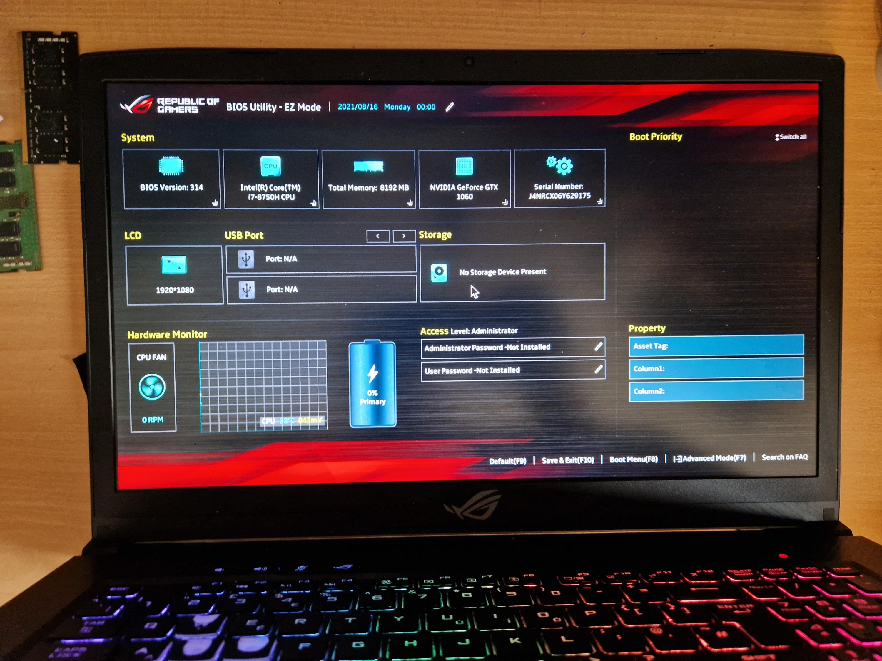

      So I chanced it and installed some new RAM, it actually booted up! I'm shocked to be honest, but this does give me hope now.
      The new mosfet was dispatched today so we will see what happens when that's installed.

        Ok so feeling frustrated, I thought sod it, let's just try installing windows and see what happens. Well, it got almost all the way through then shut off. It did however turn back on and turns on reliably.
        That mosfet is obviously still missing, I believe it's related to the video vcc. It should hopefully arrive tomorrow so we will see what happens then.
        I dunno, I really don't see how this thing can have 3ohms on the video vcc to gnd and 1ohm on the cpu vcc. It makes no sense to me but then it seems to work pretty well and nothing seems to get overly hot.
