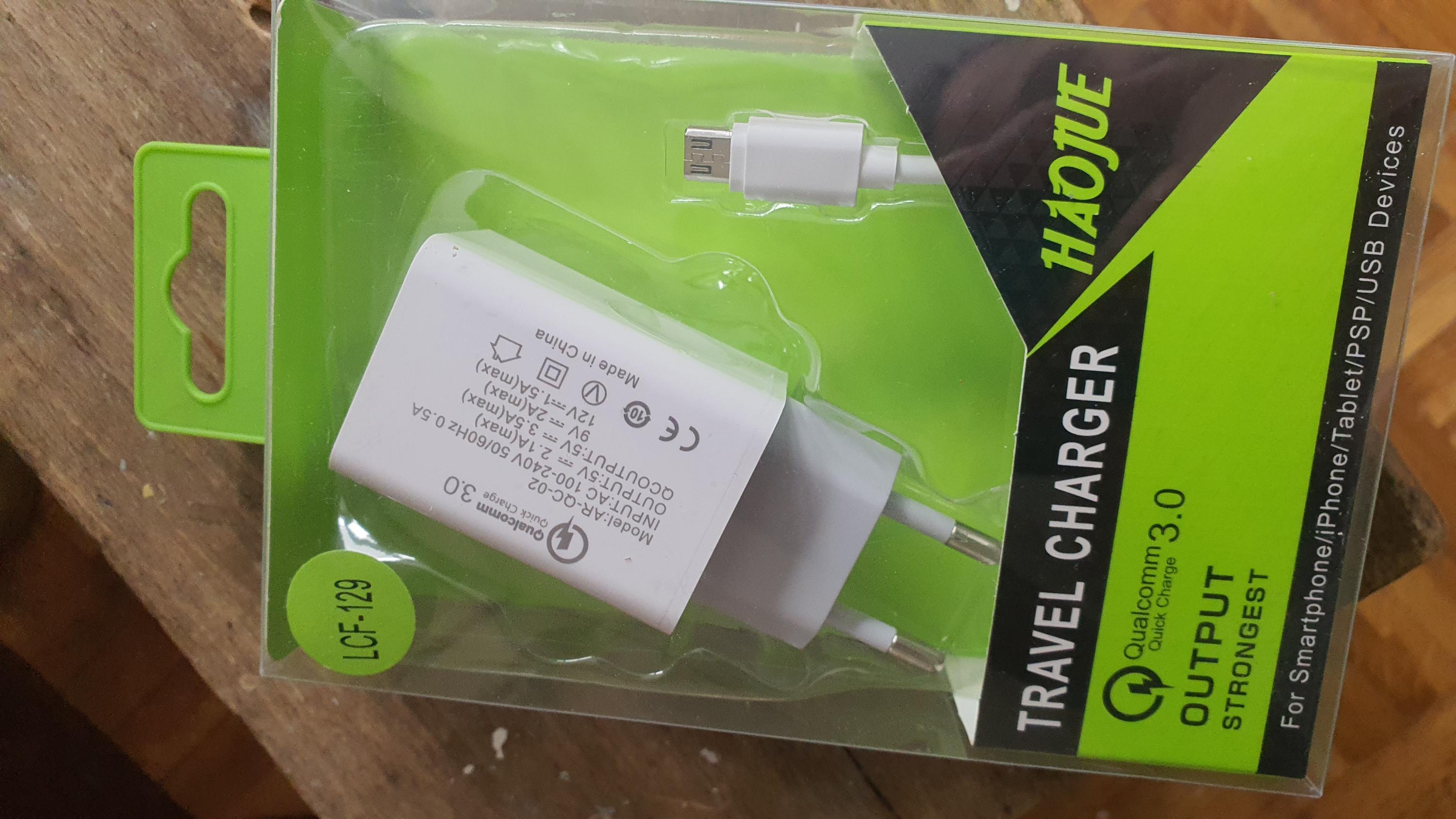

                In local food store I was able to get only this one but probably fake QC 3.0 since it costed 6 euros.
                Should I use it?
                It has 2 output USB ports.
                    Should I use it?
                    Take it back and get a refund, those cheap shitty chargers can cause a lot of damage, they`re just not made very well.
                    https://www.youtube.com/watch?v=yyNzA4Upip8

                      The posted pic of the power adapter claims to support the QC3.0 spec. It may work ok but ask the vendor for feedback of this brand and proceed as you wish. Many offshore manufacturers support the QC3.0 spec. The key concern is if the small sized adapter can deliver the current.
                      The GAN based designs are allowing for the adapters to be small in size yet still powerful. We were scouting for vendors of GAN adapters about 4 years ago in HK during my last travel to Asia. It was relatively new then. Now it is quite common. You can now purchase 200W power delivery adapters in small footprints.
                      Chicony is a big name and they started their business in making high end keyboards.

                          The one thay seller provider is from Chicony 5.2V and 2A and charges tablet to 100% normally.
                          I am also not a fan of cheap Samsung replica chargers and aint risking damaging tablet cuz of 6 eu charger.
                          But then again they all are from China.
                          So which brands are safe to buy, Anker...?
