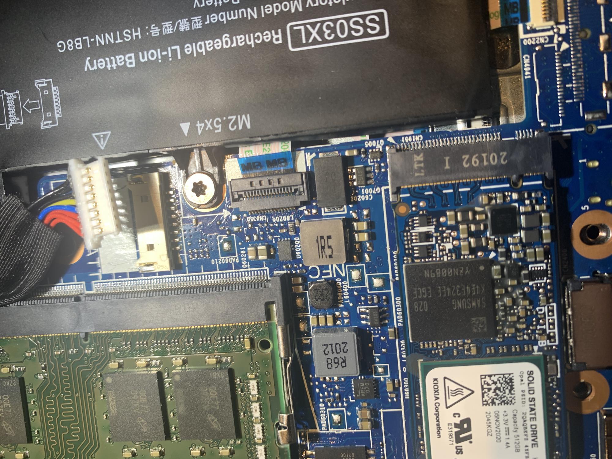

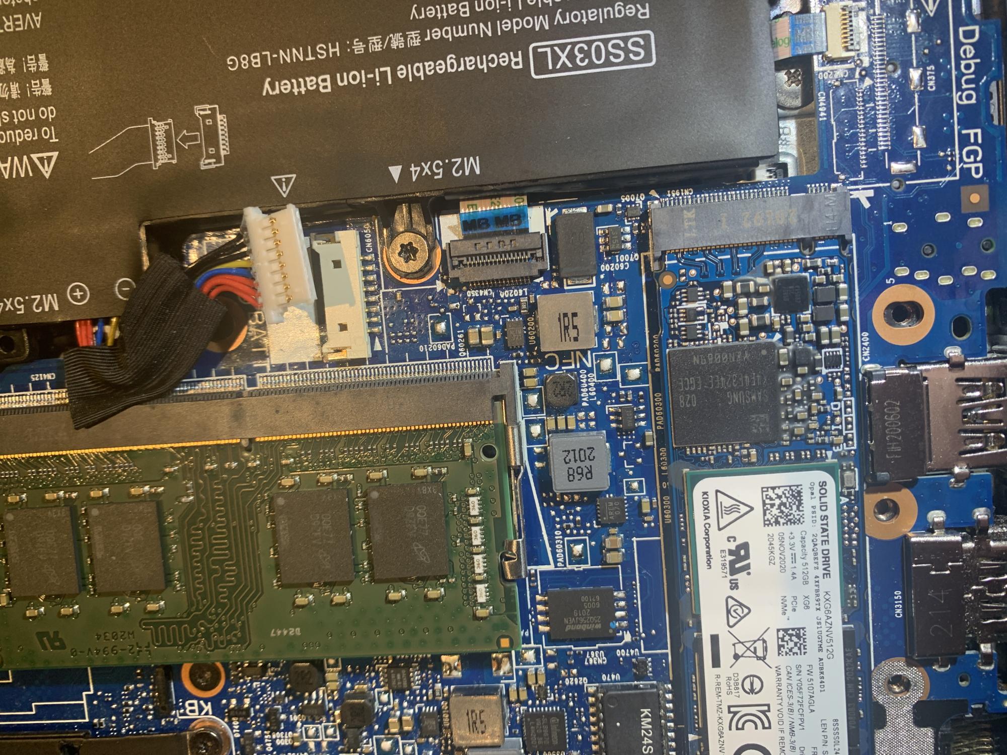

HP EliteBook 840 G5 charging issue
  • bembeno
    • Feb 2016
    • 311
    • egypt
    this laptop was not poweron when i check i found no volt on the gate of the mosfet after the charger port i use a diod to move the 19 v from drain to the source of the mosfet and it power on and work good but no battarey charging and i found only 3.3 volt on batt socket so i replaced the charging ic with the same and putba mosfet after the charger port insteadof the diod when i checked i found about 11 v on the gate of the mosfet and the laptop work good i checked the batt socket and found 13v -3.3 -3.3
    and the batt charged to 1% and not Increase i want to know can if abattaery issue or charging circuite

    Re: HP EliteBook 840 G5 charging issue
    Are these modifications the same as the factory design?
    If not, do not use other bypass tricks.
    Remain to use only what is onboard.
    The charger IC will measure the current draw on each power rail and will throttle the current / voltage based on the feedback circuits. This is based on the original factory design and components expected to be onboard
    Can you link or post the schematic of this unit?
    If not available, which charger IC is onboard?
    Which mosfets are present for the 2*DCin? Battery mosfet? High side / low side mosfet?
    Often the battery not charging is due to a leaky mosfet.

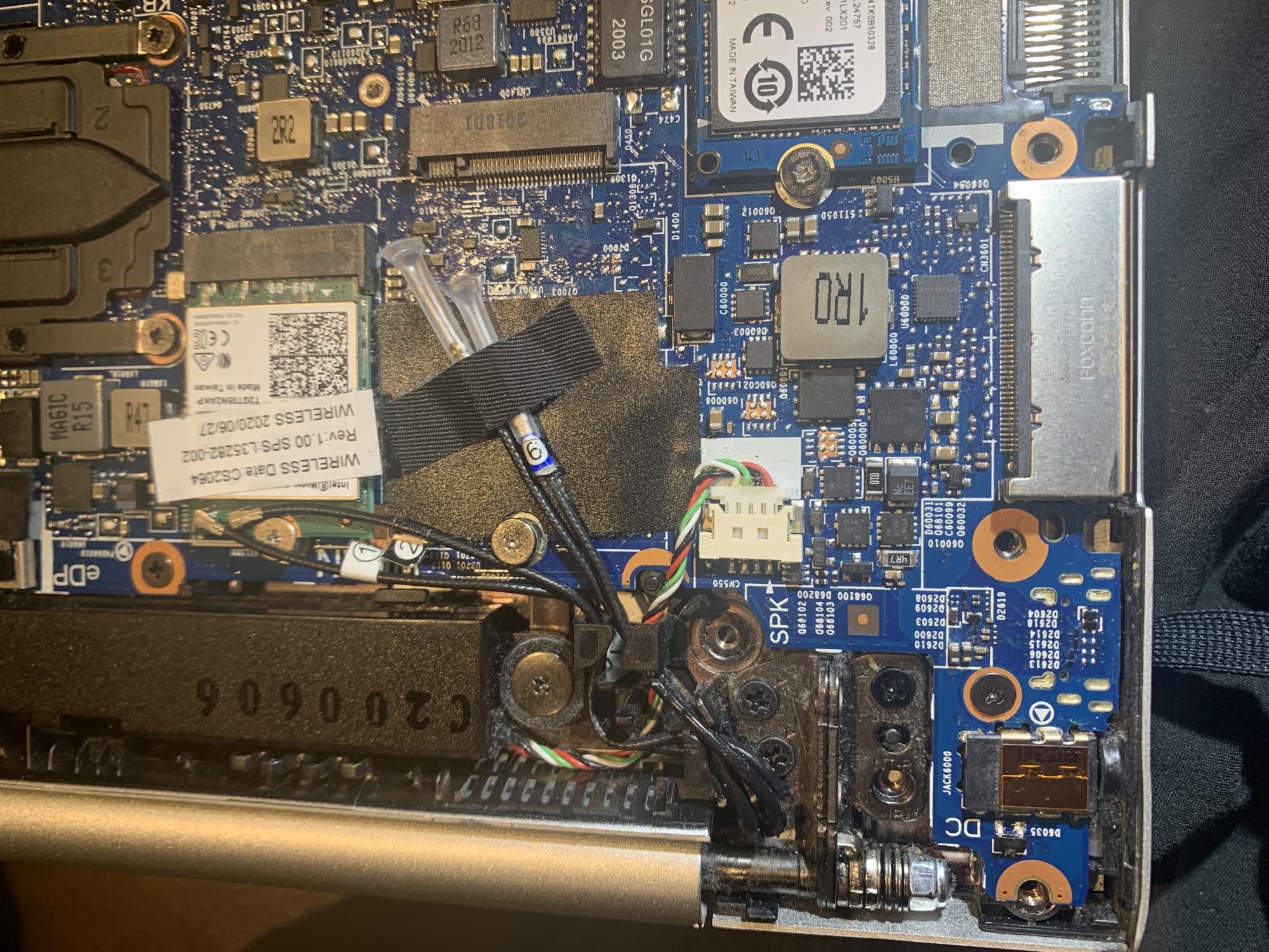

        Again my hp elitebook 840 g4 charging problem bring up your name
        I can not appreciate enough all the help you’ve given on these subjects
        Now I think it’s my time to plead with you for your guidance
        I have similar issues as to many
        Presently I have swapped to a new battery and am still getting an orange charge light
        Absolutely nothing on screen,keyboard,fans or diagnostic leds
        Checked original charger to find 19.5V on the inner ring and the centre pin
        At the doc in transient voltage suppressor I get pin 1=2v approx and pin 2=19.4V and pin 3 is =0V
        No components show obvious stresses
        Being an electrical design engineer I posses fair rework skills and measuring equipment
        Problem….no schematics! No real laptop experience. This is making debugging far more difficult
        First question….do those suppressor checks seem right?
        Second question….if they are fine where can I locate the mosfets you often recommend to check next?
        As always thanks in advance for all you are able to offer
            Locate the silkscreen markings and post the details or picture here. There may be a schematic in the schematics forum.
            Otherwise, what is the charger IC onboard?
            Trace the dcin connector and there will usually be 2*dcin mosfets (usually N-channel) and the charger IC is often the TI BQ series.
            Start with reviewing the voltage to ground of the charger IC.
            We need to know the topside markings of this component.
            Then, voltage of:
            VCC
            REGN
            ACDRV
            ACOK
            ACDET
            For now, remove the battery.
            Post your measurements and list of pin numbers.

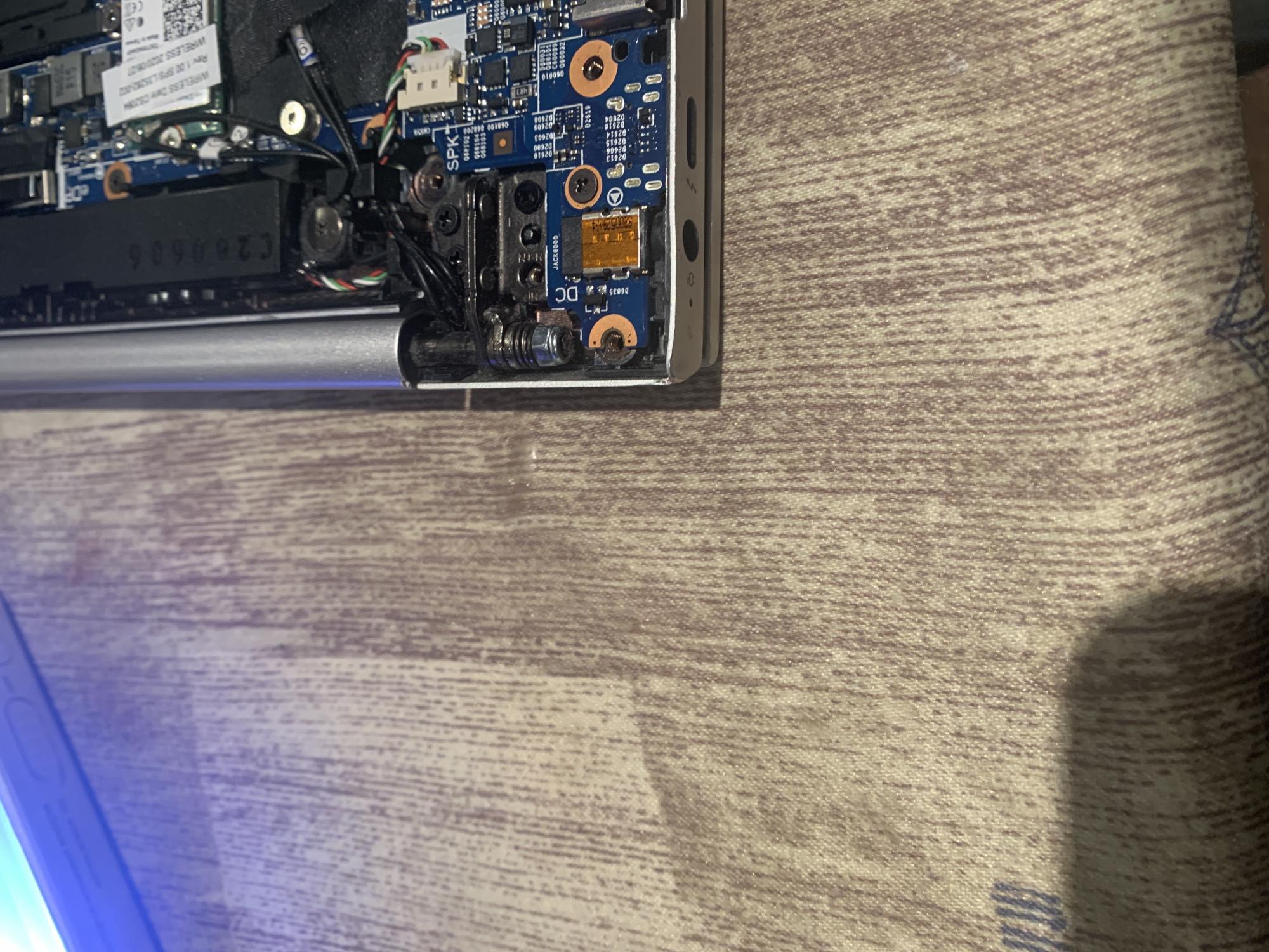

              Wow…..really need the schematic
              Find only DC marking…….looks to be dcin near voltage suppressor
              No markings for
              VCC
              REGN
              ACDRV
              ACOK
              ACDET
              Posted board pics from charger connectors to battery connector
              Checking as per your advice the schematic depository
