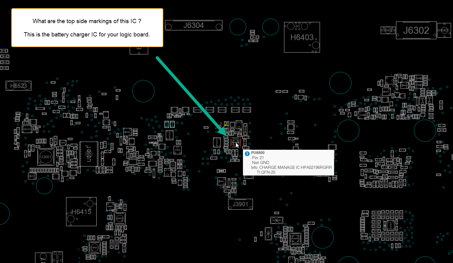

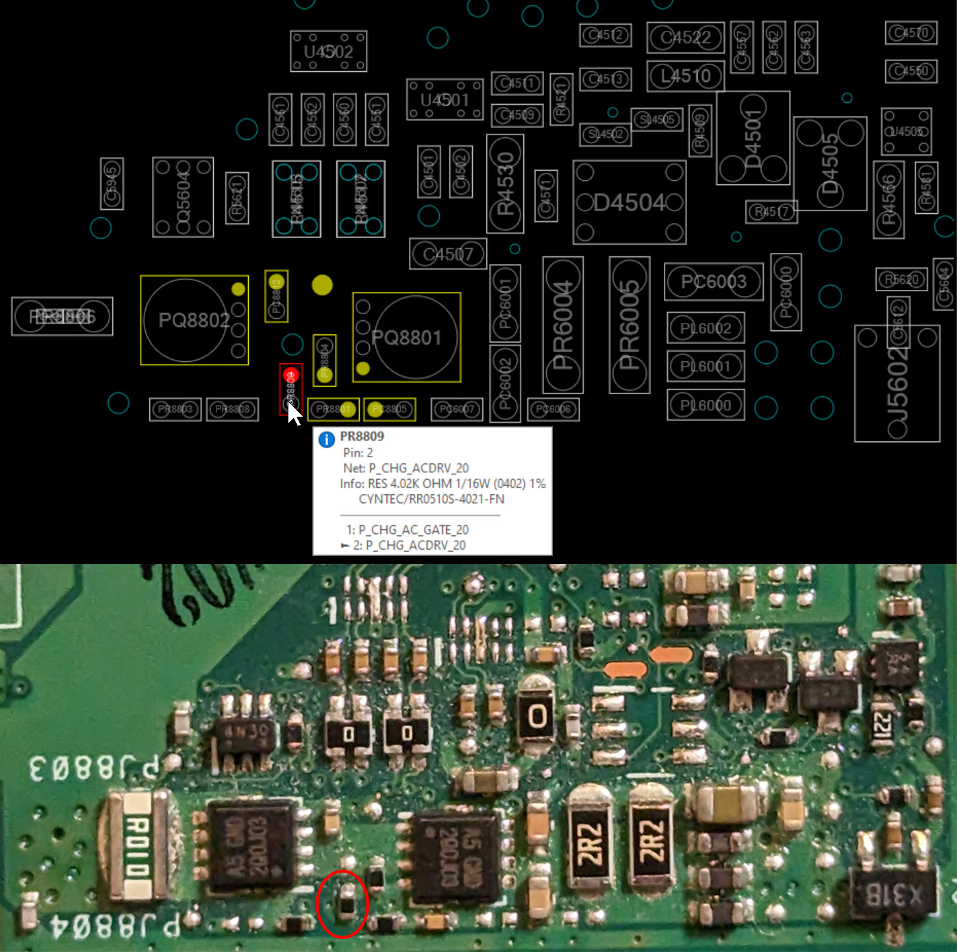

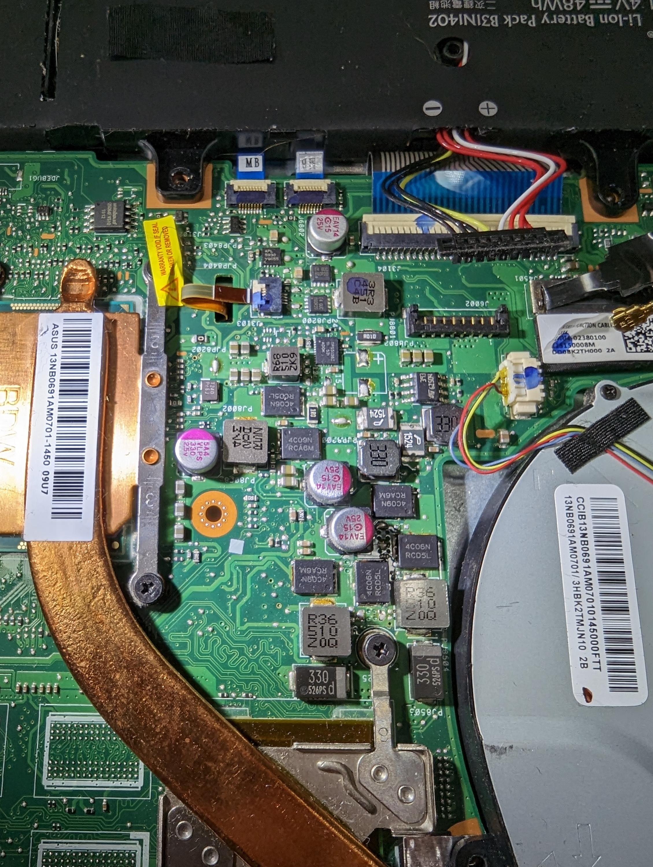

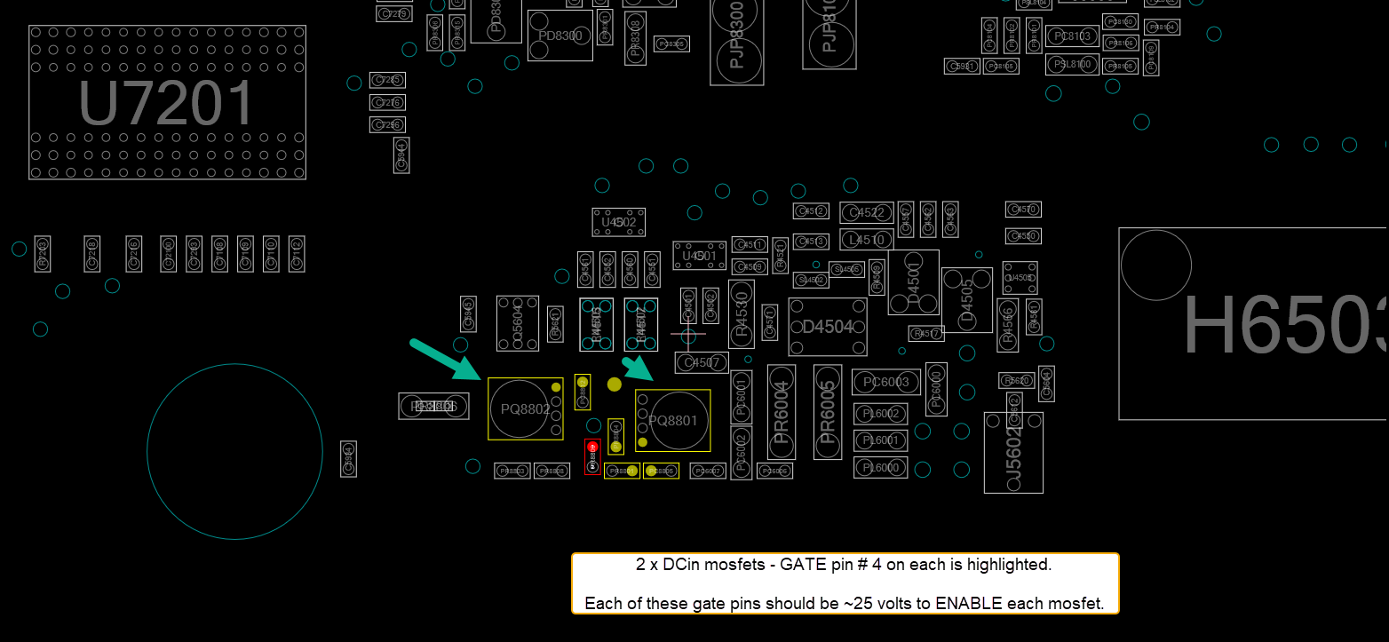

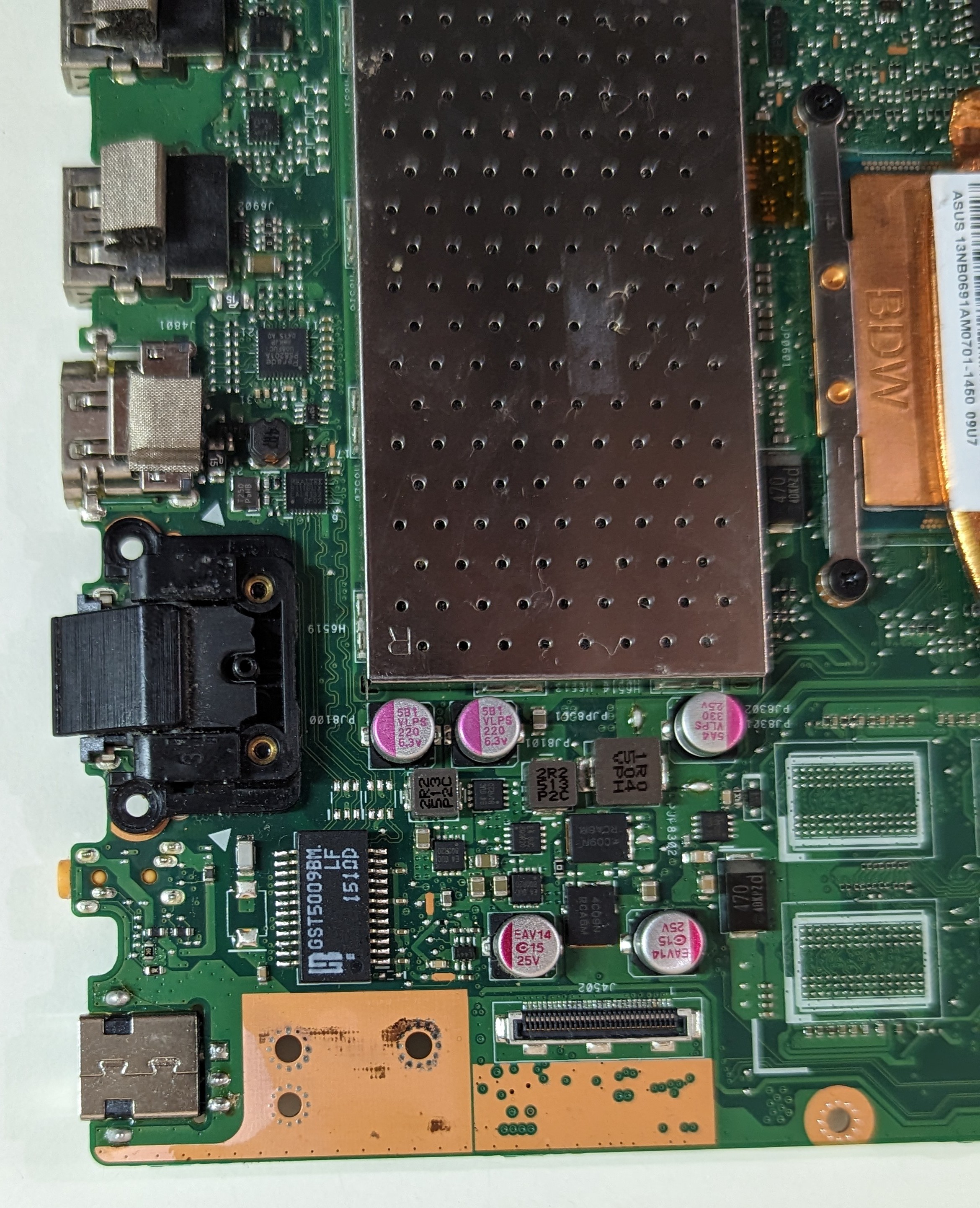

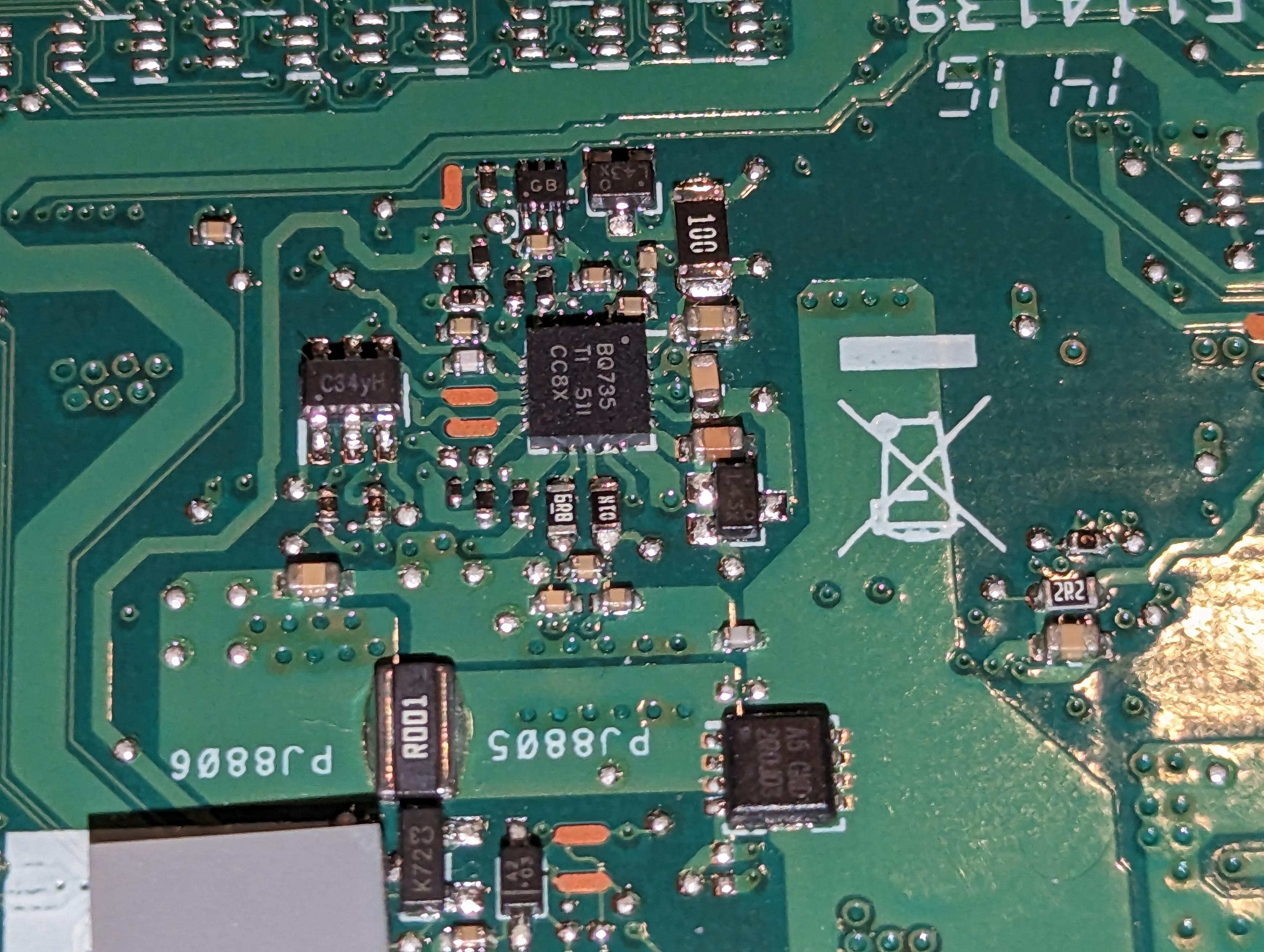

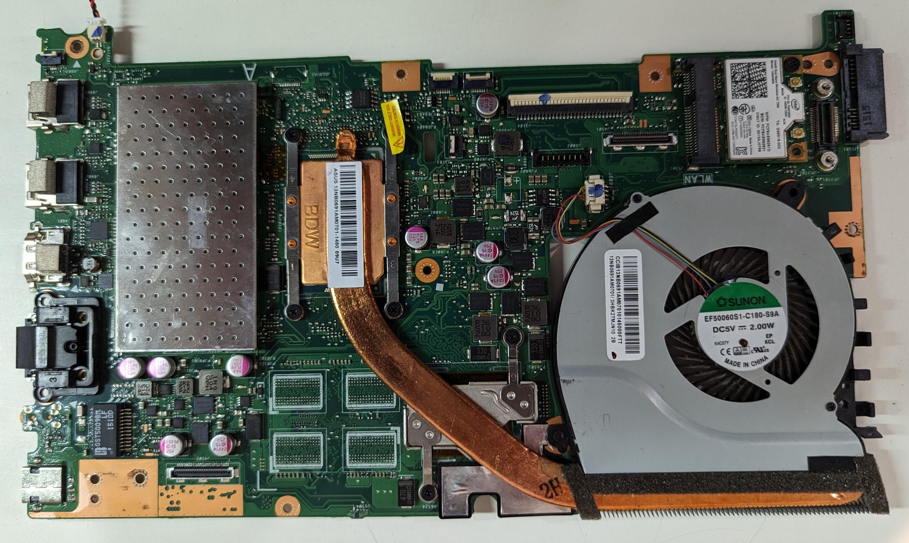

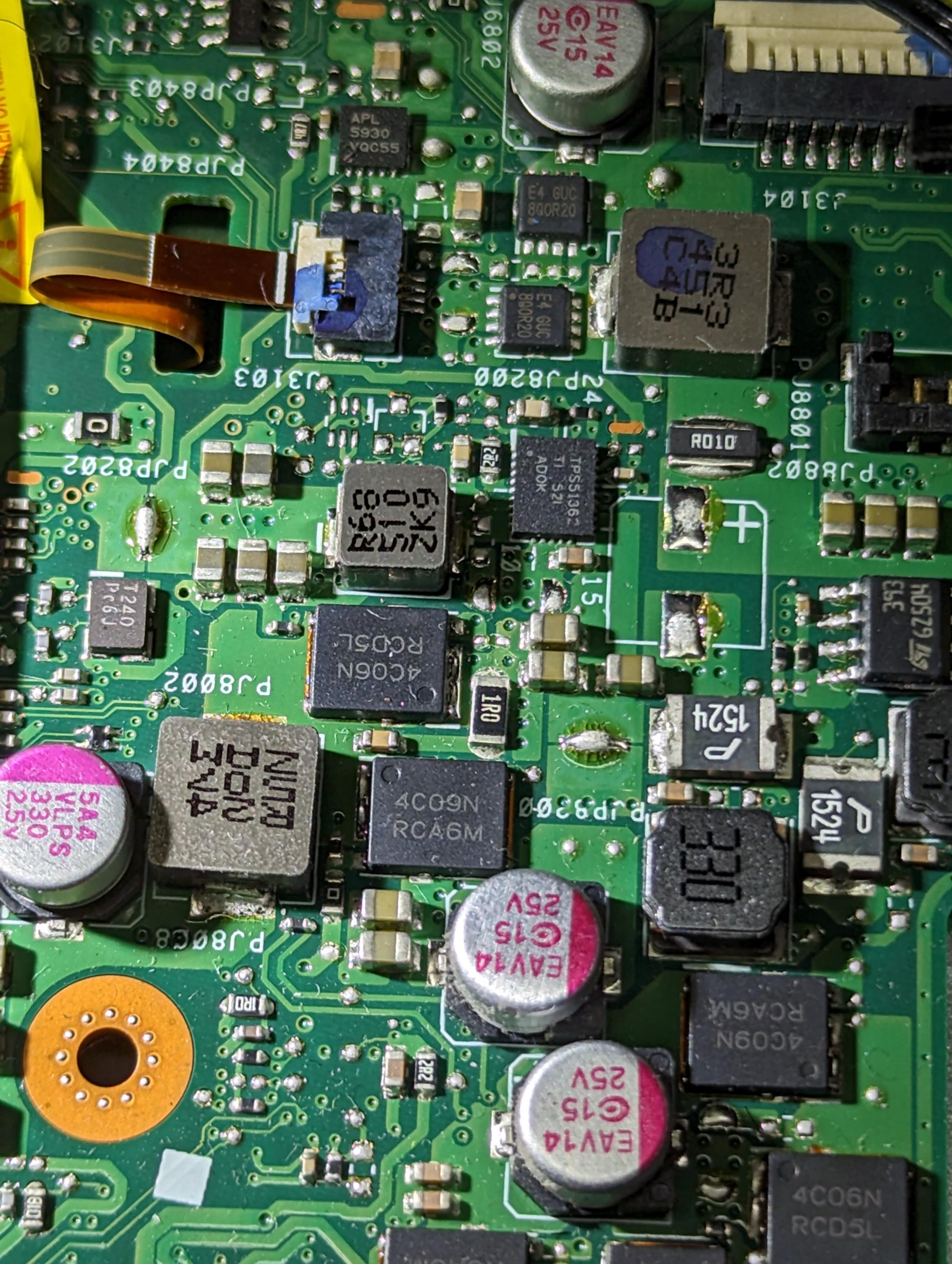

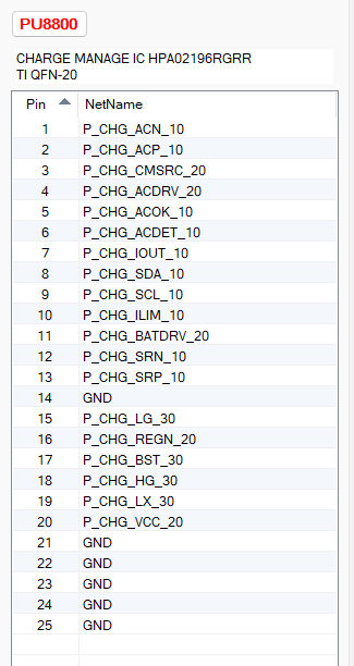

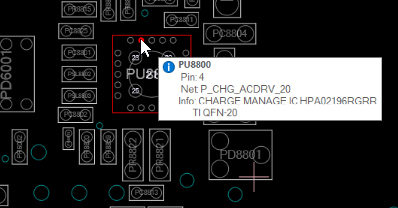

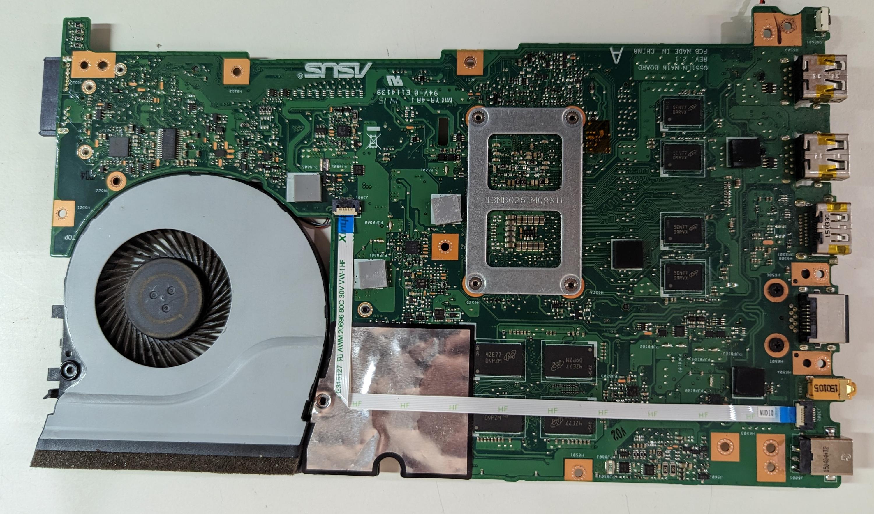

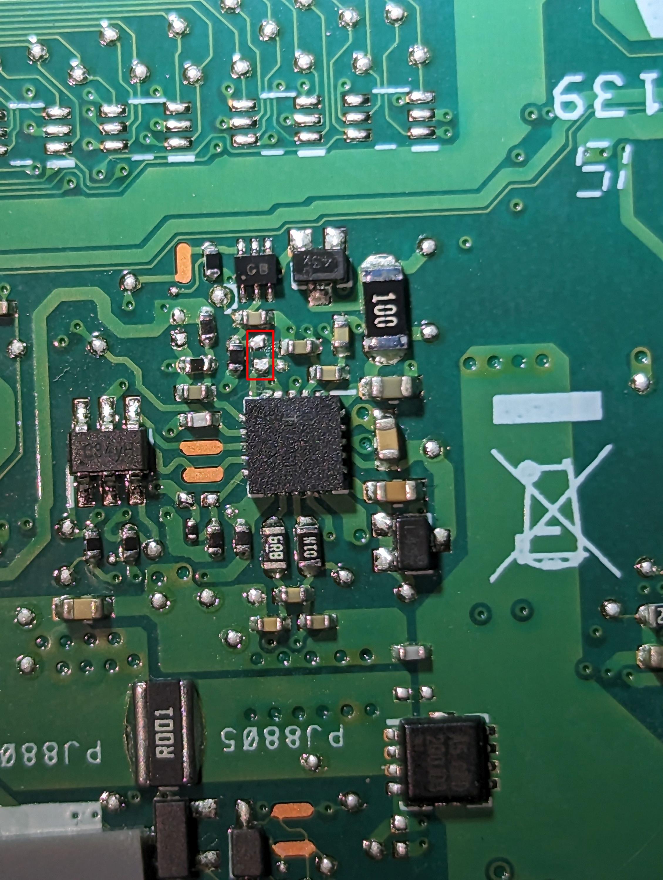

Asus Q551L Not Charging
  • mgrharry
    • Sep 2016
    • 211
    • usa
    Asus Q551L Not Charging
    Working on an Asus Q551L. The DC jack center pin had broken loose from the socket, and the only way to charge it was to push and hold the charger in. I repaired the center pin and reflowed the other pins as well. Meter now reads a steady 19v on center pin and ground pins have continuity. But the system does not detect the charger. It will power on from the battery which still has partial charge.
    Where to start troubleshooting next?
    Photos are attached.
  • mgrharry
    • Sep 2016
    • 211
    • usa
    Re: Asus Q551L Not Charging
    Maybe there's a blown resistor?
    • mon2
      • Dec 2019
      • 13880
      Re: Asus Q551L Not Charging
      Locate and share the topside markings of the battery charger IC. Follow the dc connector and you should see 2*DCin mosfets. These mosfets act like solid state switches. We need to know the charger IC so we can compare the details with other reference designs to learn about your board.
      It is possible that your charger IC will be the common 'BQ' type from Texas Instruments.
      This charger IC will have an ACDET pin that is used to detect the presence of the adapter. Often, a resistor based voltage divider.
      • mgrharry
        • Sep 2016
        • 211
        • usa
        Re: Asus Q551L Not Charging
        TPS51362
        https://pdf1.alldatasheet.com/datash.../TPS51362.html
        Pics attached
          • 20433
          Re: Asus Q551L Not Charging
          Originally posted by mgrharry
          Q551LN Boardview https://www.badcaps.net/forum/showthread.php?p=1199602
          • mon2
            • Dec 2019
            • 13880
            Re: Asus Q551L Not Charging
            See attached. If your board layout is similar, we need to know the markings of this IC = charger IC.
            Last edited by mon2; 01-18-2023, 06:41 AM.
            • mgrharry
              • Sep 2016
              • 211
              • usa
              Re: Asus Q551L Not Charging
              Ahh, there it is, thank you! It's BQ735.
              • mon2
                • Dec 2019
                • 13880
                Re: Asus Q551L Not Charging
                Good stuff. Measure the voltage to ground of pin #4 of the charger IC = ACDRV. Do so with care. Ok to measure at the 4k resistor that is on the same pin.
                • mgrharry
                  • Sep 2016
                  • 211
                  • usa
                  Re: Asus Q551L Not Charging
                  Measured pin 4: 0v nada
                  • mon2
                    • Dec 2019
                    • 13880
                    Re: Asus Q551L Not Charging
                    Locate and remove the 4k resistor on this ACDRV pin. Do not lose the resistor.
                    Power up and test again the voltage to ground of ACDRV pin.
                    • mgrharry
                      • Sep 2016
                      • 211
                      • usa
                      Re: Asus Q551L Not Charging
                      voltage with resistor removed is .06
                      • mon2
                        • Dec 2019
                        • 13880
                        Re: Asus Q551L Not Charging
                        Check voltage to ground of REGN pin #16. Also VCC at pin #20 on the charger IC. This ic is powered through pin #20.
                        • mgrharry
                          • Sep 2016
                          • 211
                          • usa
                          Re: Asus Q551L Not Charging
                          pin 16 = 6.11v
                          pin 20 = 19v
                          these are with the resistor for ACDRV removed.
                          • mgrharry
                            • Sep 2016
                            • 211
                            • usa
                            Re: Asus Q551L Not Charging
                            One other odd thing-- if it's sitting plugged in for a long period of time, 1hr plus, the system will power on and the fan will run. It's only happened with the bare board connected to power so I don't know if it's posting but seems worth mentioning.
                            Last edited by mgrharry; 01-23-2023, 08:37 PM.
                            • mon2
                              • Dec 2019
                              • 13880
                              Re: Asus Q551L Not Charging
                              With the ACDRV resistor removed, what is the voltage on the ACDRV pin on the charger IC? Measure with the adapter connected.
                              • mgrharry
                                • Sep 2016
                                • 211
                                • usa
                                Re: Asus Q551L Not Charging
                                Hmm, pin 4 is cycling between 0 and .38v
                                Just to be sure that I removed the correct resistor, I've attached a photo. The area where the removed resistor was is marked in red.
                                • mon2
                                  • Dec 2019
                                  • 13880
                                  Re: Asus Q551L Not Charging
                                  No. Place the removed resistor back onto the board.
                                  Review posts #5 and #6 of this thread.
                                  The boardview will offer the correct location for the 4k resistor being referenced.
                                  The yellow highlighted pins are the gate pins of the DCin mosfets.
                                  Using the boardview file, mouse click on the ACDRV pin #4 of the charger IC. The software will highlight all connected pins to the selected one.
                                  Now, review the backside of the board to locate the DCin mosfets and the highlighted 4k resistor will be visible.
                                  Select the other side of the resistor and pin #4 of the mosfets will be highlighted.
                                  This is the 4k series resistor to remove so we can confirm the gate voltage drive is ~25v (adapter voltage+REGN voltage=~25v).
                                  • mgrharry
                                    • Sep 2016
                                    • 211
                                    • usa
                                    Re: Asus Q551L Not Charging
                                    Ahh, shit, sorry about that. I missed your second board view screenshot where you pointed out the dc in mosfets and the resistor. I'm an idiot.
                                    However, we can mark this as a case closed-- I replaced PR8813, CHG_ACOK, resistor from a donor board, and was ready to proceed with retesting and then removing the CHG_ACDRV resistor but I figured I'd just double check the system and it is now charging correctly. Did a few charge up / down and power cycles and it's working fine.
                                    I did make a side by side image of the board view and actual board with the CHG_ACDRV resistor circled in red. I'll go ahead and post it in case it can help someone else in the future.
                                    Thanks for all the tips.
