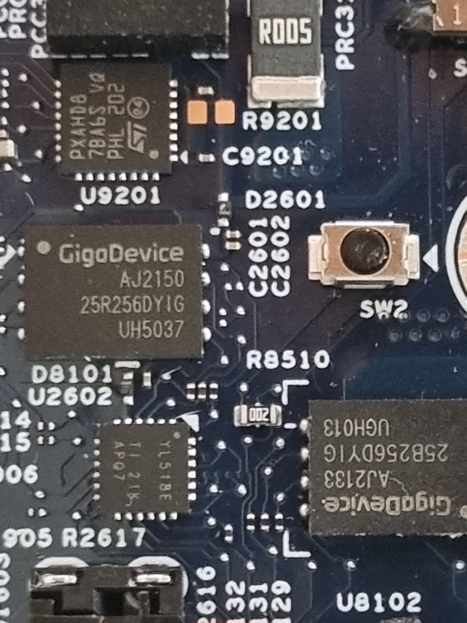

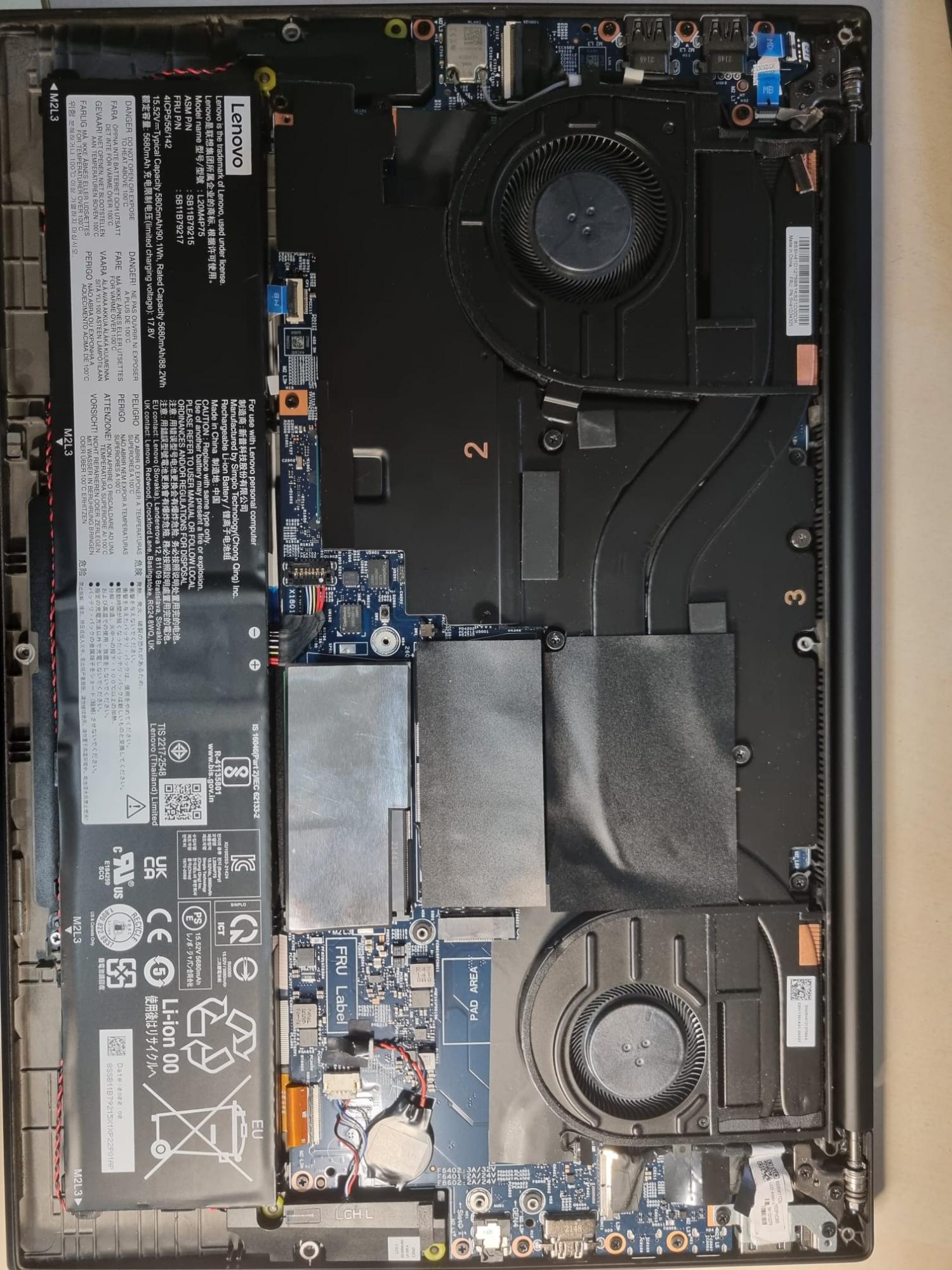

Where is BIOS Chip on Thinkpad Gen1 P4 - Model 20Y4S04W00
  • samstown
    • Mar 2021
    • 122
    • Switzerland
    I see two Gigadevice chip on motherboard but I am not sure if that could be the BIOS ROM.
    Sam
  • samstown
    • Mar 2021
    • 122
    • Switzerland

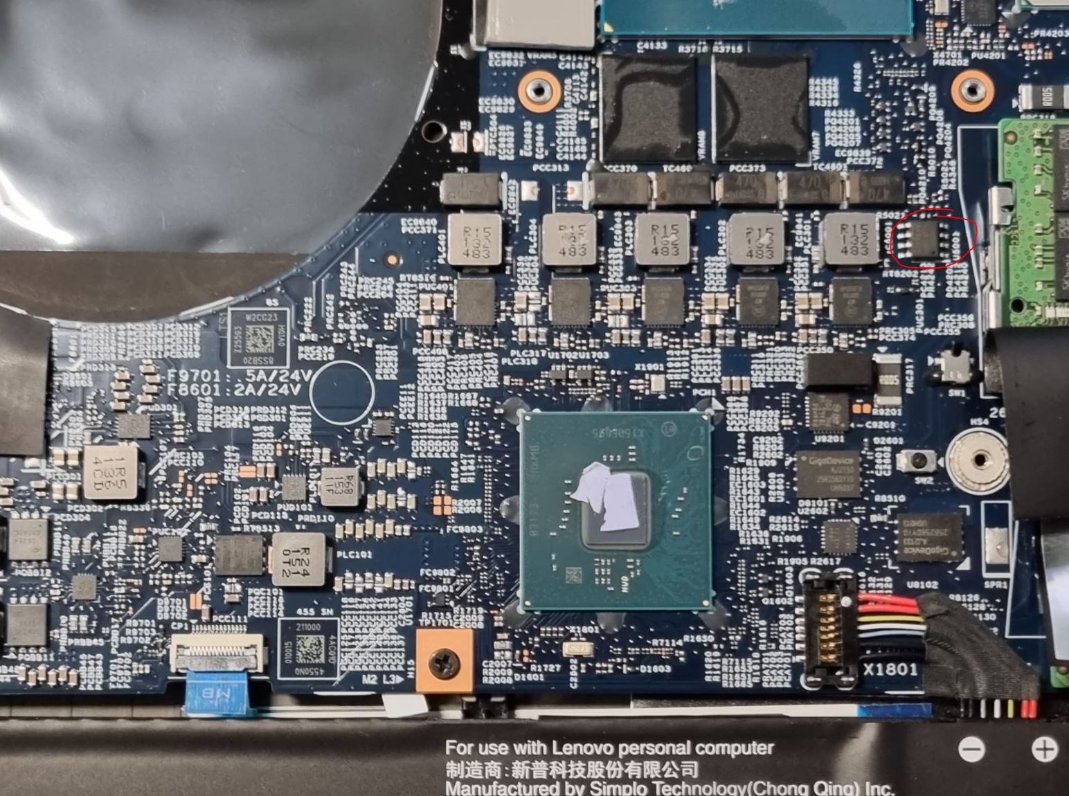

    Re: Where is BIOS Chip on Thinkpad Gen1 P4 - Model 20Y4S04W00
    Ok, I think found it.
    Winbond 25Q16JWNIQ.
    Following an update Laptop stopped booting. It start with black screen then stops, I guess it's BIOS issue.
      This flash chip is too low density to be the main bios chip.
      Perhaps the bios chip for the local EC controller or wifi / ethernet interface.
      The larger Gigadevice chips are probably the main bios flash ICs.
          Thank you. OK, then it will be more complicated to read.
            You read those with Pomona SOIC-Clip ? I 've tried a couple of time.. no communication. I have the chip in my reader DB so setup should be ok.
            • mon2
              • Dec 2019
              • 14667
              No, the pomona clips (most are clones) are useless for this package.
              From memory, believe this is the WSON-8 package. Please search for the datasheet for the device to confirm.
              Then, you will need a flash memory breakout / dip conversion board. There is someone in the UK that sells a PCB to support this package but China has clones that should be also ok. In a nutshell, you want to hot air off this flash device -> solder onto another PCB that should offer a DIP (through hole pins) conversion. Then you can R/W/E the flash device.
              Be sure to review all details before purchasing / proceeding. This and other forums should mention the full details of this bios device.
              • samstown
                • Mar 2021
                • 122
                • Switzerland
                Thank you for the details then I will give up. The PC still under warranty, customer should return it to Lenovo if there is no other option than heat gun to flash it.
