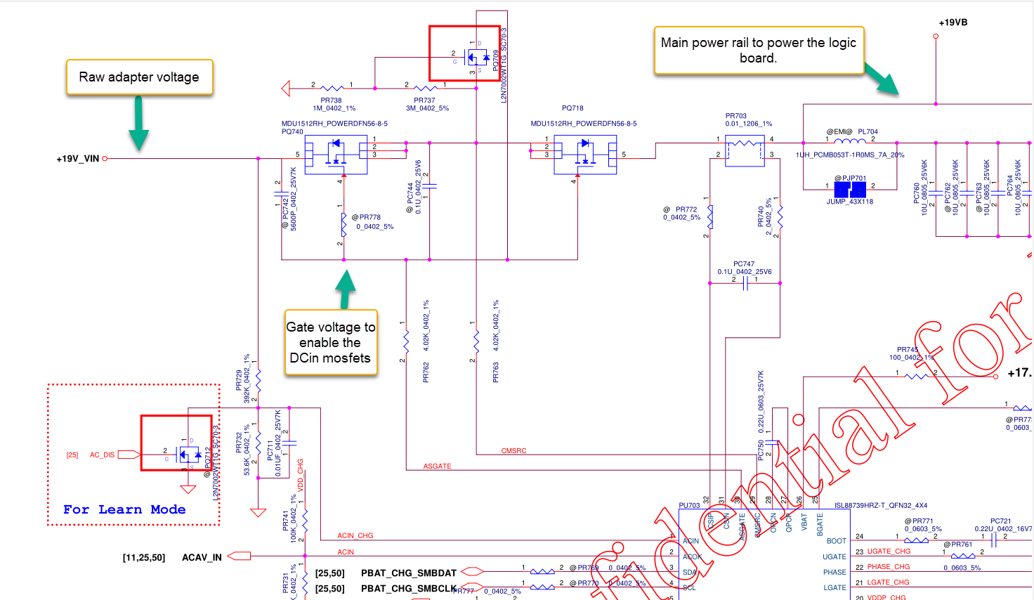

                    Re: Dell Vostro 15 no charge
                    Hi new user - could make a new thread - i opened my dell inspiron 5567 p66f001 to clean the fan, but now it wont turn on. Everything seems to be connected though - any thoughts on what I might try?
                    • mon2
                      • Dec 2019
                      • 14673
                      #30

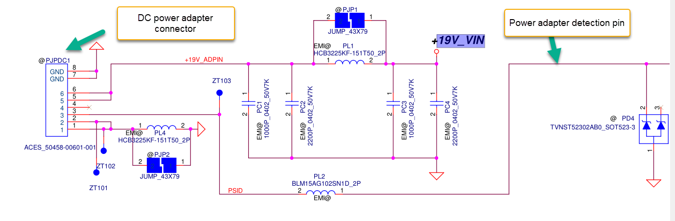

                      What are the silk screened markings on the logic board?
                      Is it 'LA-801P' ?
                      See attached. Based on this schematic for this model, measure the 3 points of interest.
                      Meter in DC volts scale (20V or higher). Red meter probe on point to test. Black meter probe to ground (shield is ok).
                      Interested in the:
                      a) power adapter raw voltage
                      b) GATE pin voltage common to drive the 2 x DCin mosfets. Mosfets are like solid state relays / switches.
                      c) the main power rail voltage
