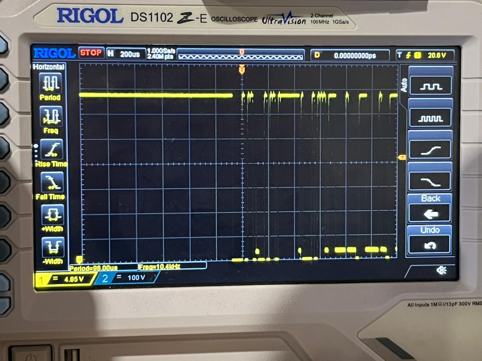

                  I don't have arduino but I have an oscilloscope and I can check if there is data exchange, but I think there is otherwise it wouldn't have seen the battery.. it's a strange defect

                    Yes, do check for pulses on the SCL and SDA pins.

                      I confirm that the data exchange on the 2 pins of the battery is there, perhaps it requires the original battery..

                          I also tried with its original battery and it has exactly the same problem, data exchange present but it does not charge ... I try to order the new original one and I will let you know

                            Which line did you probe with the scope? SCL or SDA ?
                            Check to see if there are similar pulses on the other SMBUS interface line.
                            • dclass-pro
                              • Dec 2022
                              • 157
                              • Italy
                              Re: Dell Vostro 15 no charge
                              I probed both lines

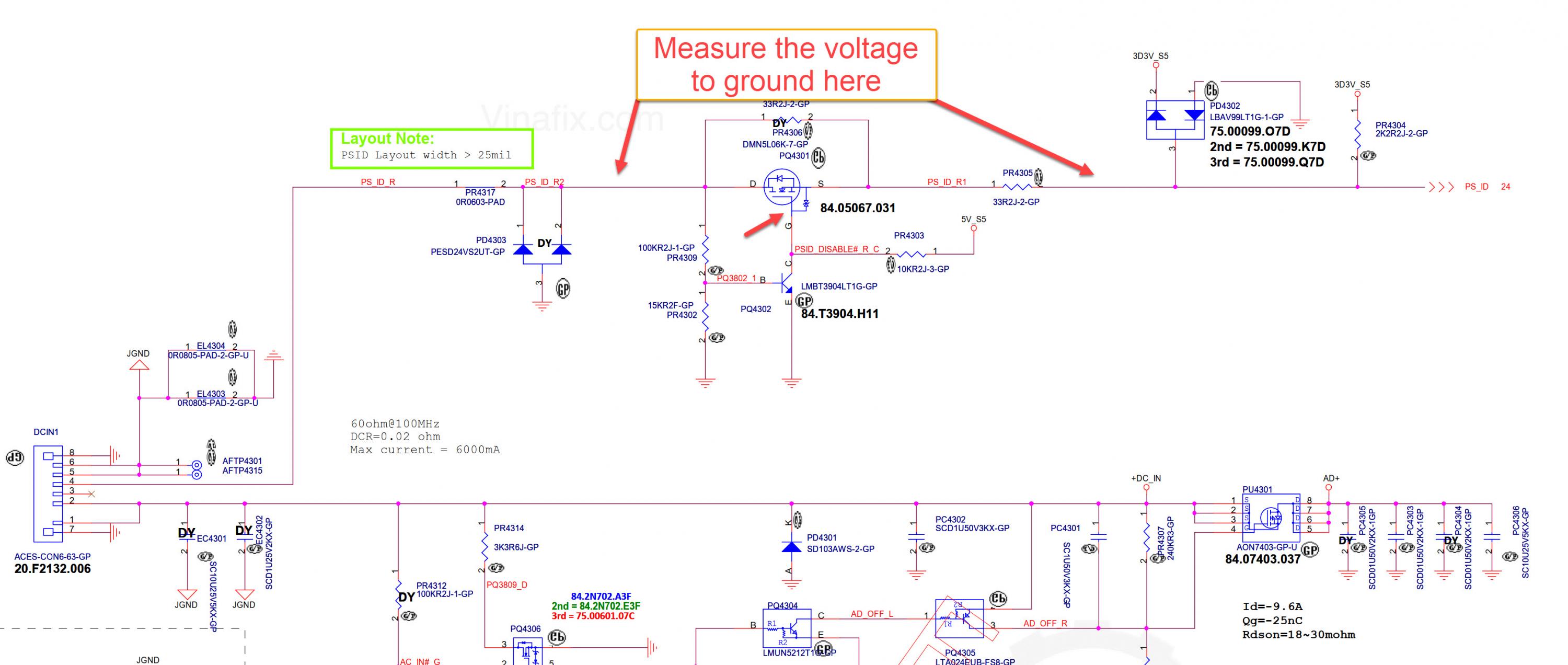

                                Should have asked earlier, are you using the recommended and official power adapter for this unit ?
                                The logic board does ping the power adapter for the power rating using the PS_ID single wire interface.
                                If the PS_ID line is defective (??) or the wrong adapter is used, the battery will not charge.
                                Can you measure the voltage to ground of the PS_ID line for the power adapter?
                                  See attached for test points of interest.
                                  If the host logic board is unable to properly detect the power adapter, the battery will fail to charge.

                                    I use the original charger and I also tried another original charger, same result.
                                    On the 2 points you ask, I have 3.2V
