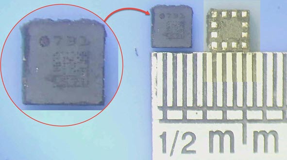

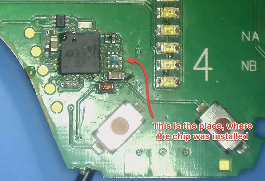

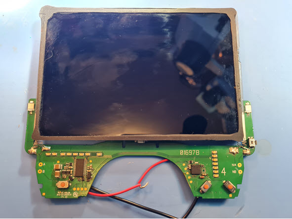

    I have a self-darkening visor/shield from a 3m Speedglas 9100XX Adflo Welding Helmet with 1 component reporting short on the circuit board. I can't find any data on this component - see the picture.
    Can anybody kick me in the right direction? PLEASE!

    This device is extremely difficult to repair in the past I have tried to repair them if it is not an issue with the solar panel wiring or a capacitor being bad or something similar like a resistor open
    The ic devices a lot times are very difficult to find a data sheet for this has been my personal experience I wish I could be more help than this
    The basic primary function of these devices is that they take a LCD display and make it blank the screen to black when it see inferred wave link and have a sensitive adjustment that the user can adjust
    The testing that I can recommend is to check the solar panel the wiring from the solar panel to the board and the capacitors and resistors and transistors that they are functioning correctly
    The ic chip that you are referring to is probably the LCD controller that is used to make the screen go blank the screen black so if you can find data sheet has this function in it description this would point you in the right direction
    It is also possible that the LCD is bad because the the normal failure is that the screen will not go black it just allows all the light to go through if you point the solar panel to the sun it should depending on the adjustment should turn the screen blank to black if the screen is always black and you have the solar panel completely shielded from the sun it should turn clear ( if it is black then the failure is probably the LCD screen ) and you should be able to see through it

      so whats printed on the chip?
