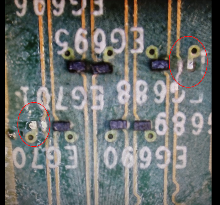

    Xbox series x - Anyone know where I can send this out to for repair?
    The trouble with it is that it's missing 2(I have one) of the (I think they're filters?) which are the super small black pieces just upstream of the hdmi port.
    Thanks!

    Re: Xbox series x - Anyone know where I can send this out to for repair?
    https://northridgefix.com/
    Check out his many youtube videos on such repairs. Give Alex a call to discuss.
      If you join this facebook group they have a list of trusted repairers in all areas
      https://www.facebook.com/groups/console.repair.legion
        Thanks!
        This is ESD TVS Diodes.
          • 31285
          why do some look black on the ends?
          are they all burned?
              thank you I was wondering what they were.
                  You have been answered on the site i linked these are 0402ESDB-MLP7 DIODES. Not sure if available though so maybe a donor board would be best bet if fixing it yourself.
