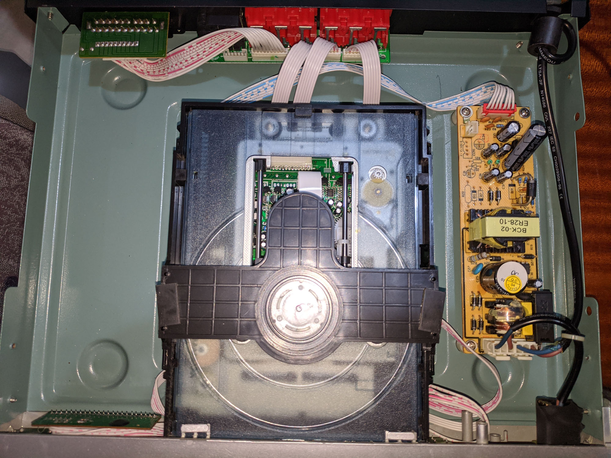

    Got this for free. Opened metal case and found one bad 2200uF 16V cap.
    Replaced it with Capxon KM 3300uF 16V that was removed from a Jou Jye psu.
    Instead of being very tall, it fitted without touching the cover.
    DVD player works without any issues, the question is for how long, before the Capxon bulges. Do you think the low temperature and low stress of this application will save a cap with so bad reputation?

    Maybe but I would not count on it if it was not used for a switching power supply you might have a better chance of getting away with it if I was doing this repair I would go ahead and replace the low value capacitors except the main filtering capacitor as long as it does not show signs of leaking or bulging on the top or bottom of the capacitor
        Maybe, maybe not.
        PSU appears to use discontinuous (flyback) topology and is always On, so long as it's plugged in. Thus, it will just depend on how much ripple current that flyback SMPS puts out for the filter caps. If not much, I suspect the CapXon KM you put should last. Also, CapXon KM tend to be hit-or-miss in my experience - sometimes they last a very very long time and don't seem to go bad, while other times they go bad quite quickly. In any case, this is much better than their KF or GF series, which tend to go bad with or without use (unstable electrolyte.) KM has fairly stable electrolyte and won't go bad in low-stress applications usually (like in audio gear that doesn't run hot/warm.)
        So I'm crossing my fingers for you/it that it lasts.

          Edit: Those "clone" DVD players typically have a main +5V supply, and both +/- 12V.
          Yours also looks like this.
          The big diode for +5; and two small diodes for +/-12.
          The one with the cathode towards the transformer is for -12...
