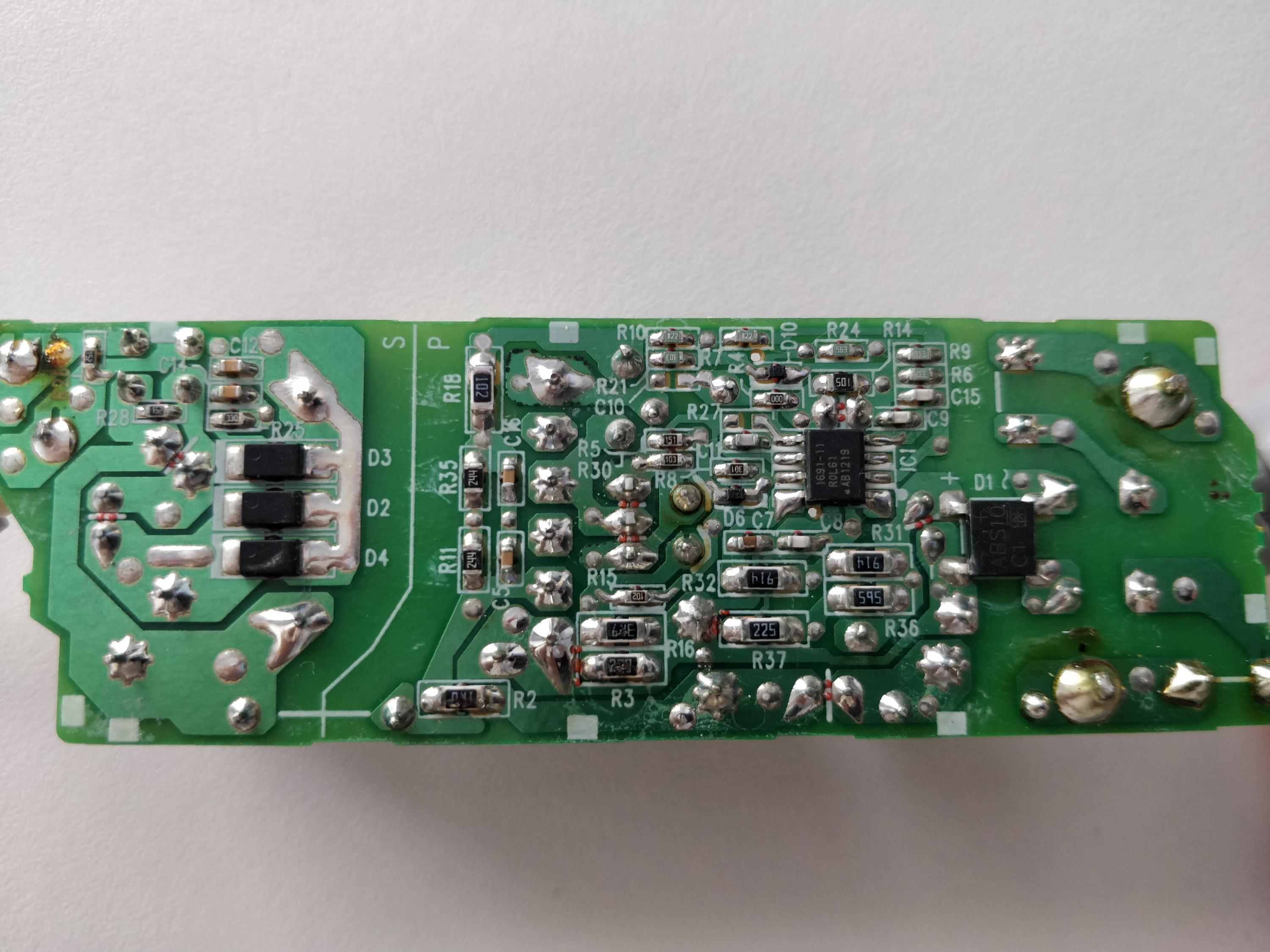

    So I'm trying to learn my way through fixing electronics by practice.
    This power adapter was given to me by my friend, instead of throwing away, because in reality you can get a replacement for €15.
    The fault is: no power output

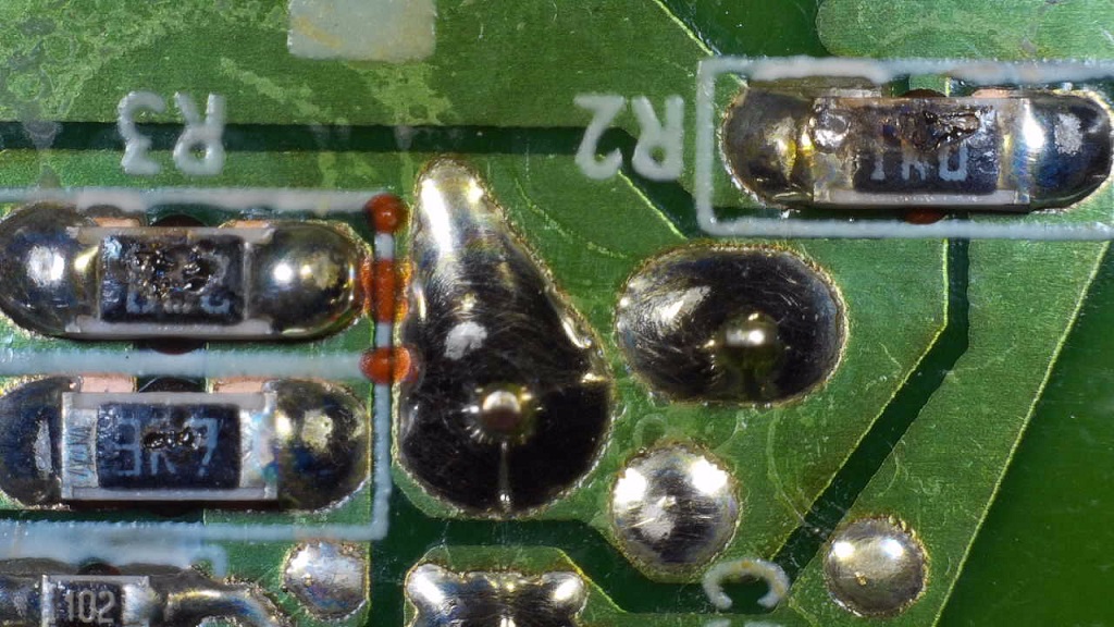

    My findings: easy... at least 3 blown SMD resistors. At least that's what I can visually see.
    Root cause: unknown
    I'm going to post some photos of the PCB. The main goal of this post is to simply understand what could have caused them to blow up.
    My way of thinking is this: as far as I know resistors don't blow on their own, and blowing up means that a large amount of voltage was sent to them, right?

    check the mosfet that has the temperature sensor leaning against it.
    it's probably shorted and blown the resistors

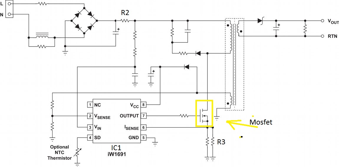

          Re: Wii Power Adapter... for fun
          R2 is acting like a fuse for the circuit, it is between the transformer primary and the main DC supply.
          R3 (and the one next to it) are between the source pin of the mosfet and hot ground of the primary circuit.
          When the mosfet shorts it will blow these resistors. When the mosfet does short it may also damage the mosfet gate circuit including the drive ic.
              The drive ic seems to be a IW1691 The mosfet is switched at around 130kHz It is not acting like a simple on/off switch.
              It takes the raw Dc from the main filter cap and switches that voltage at 130kHz across the primary of the transformer, this then (basically) produces the lower voltage on the secondary which is the adaptors output
                  Yes the mosfet is bad, it should check open circuit drain to source. I do suspect the ic will be bad as well, When the mosfet shorts and the source resistors (R3) go open, full 300vdc is applied to the CS pin of the ic via R15.
