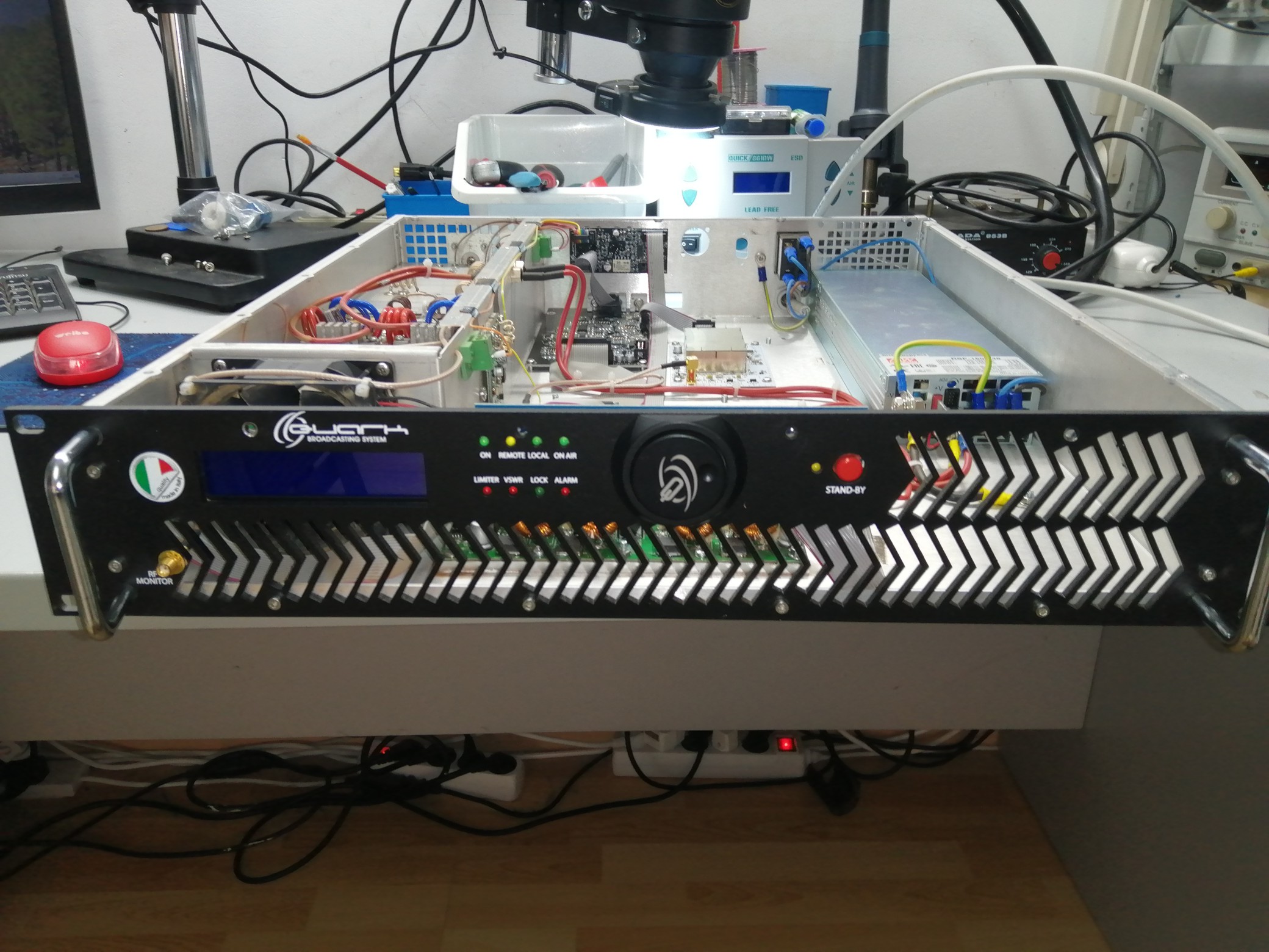

    Hi Guys
    Here is an unusual one (for me anyway)
    It s Quark 1KW FM radio exciter/transmitter
    I think it is the Falcon 1000 but there is actually no model number on it, I just went by the pictures on http://www.quarkelectronics.it and the fact the radio station who own it, tell me it is 1KW
    The Alarm LED is illuminating, apparently. I haven't powered it up on the bench and I don't know if I can as I don't have a load to connect to the RF output.

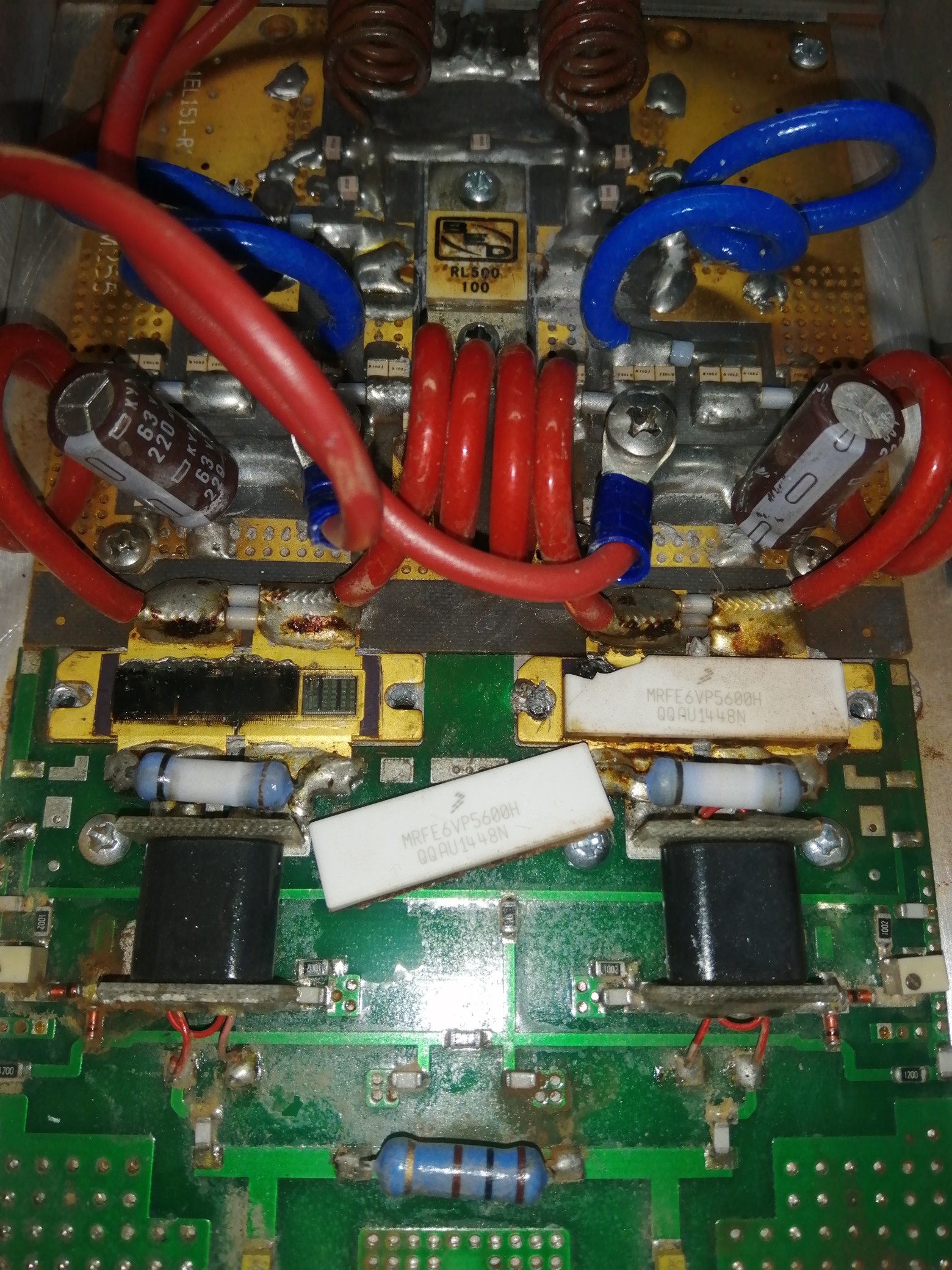

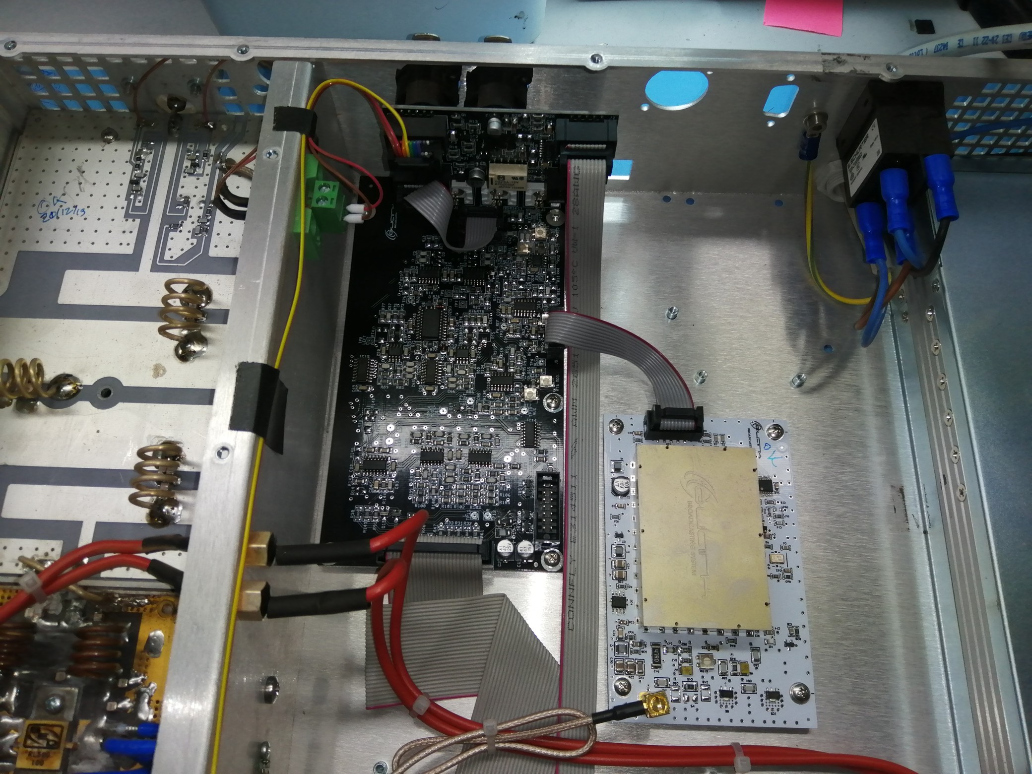

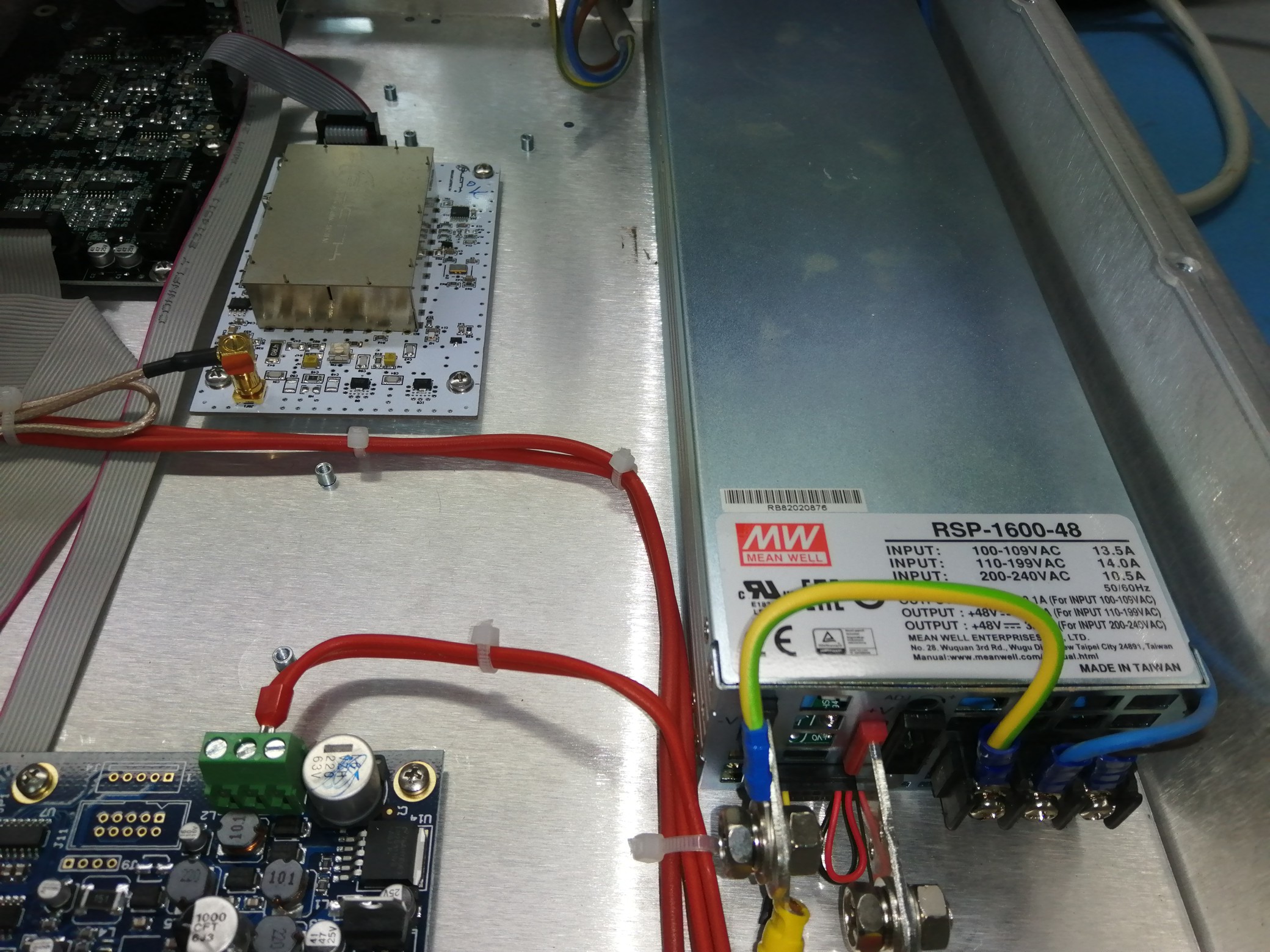

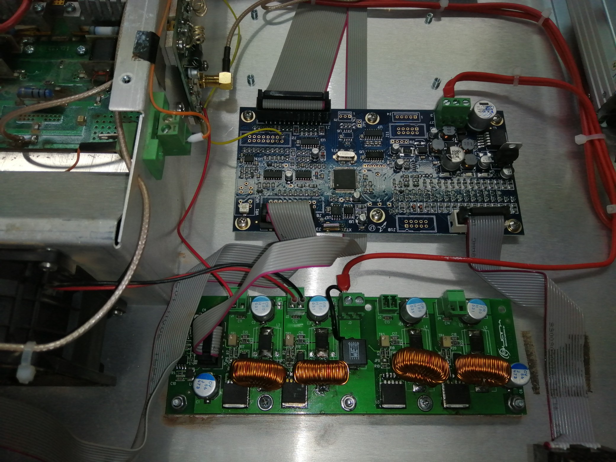

    Originally they brought me just the green PCB with the four buck regulators (see pics) They asked me to change the LM2576HVS-ADJ voltage regulators which I did, they supplied new parts. However after doing that I tested the PCB stand-alone on my bench PSU and found there is an open circuit track between the 48V input terminal and the inductor L1.
    You can see I bridged this open circuit track on the pics, and then the regulator board seemed to work OK, I have two outputs of 14V, one of 28V and the other read 30V, but my bench PSU only goes up to 31.5V and the input should be 48V so the last regulator is probably somewhere above 30V if I had the correct input voltage.
    I checked the resistance from LM2576 pin 4 to Vcc and Ground for each regulator, and the resistances I see are suggestive that I should have 2 channels equal (I have 2 x 14V), one channel higher (I have 28V) and one higher again - which is the one reading 30V
    So I am pretty convinced that regulator board is working now.

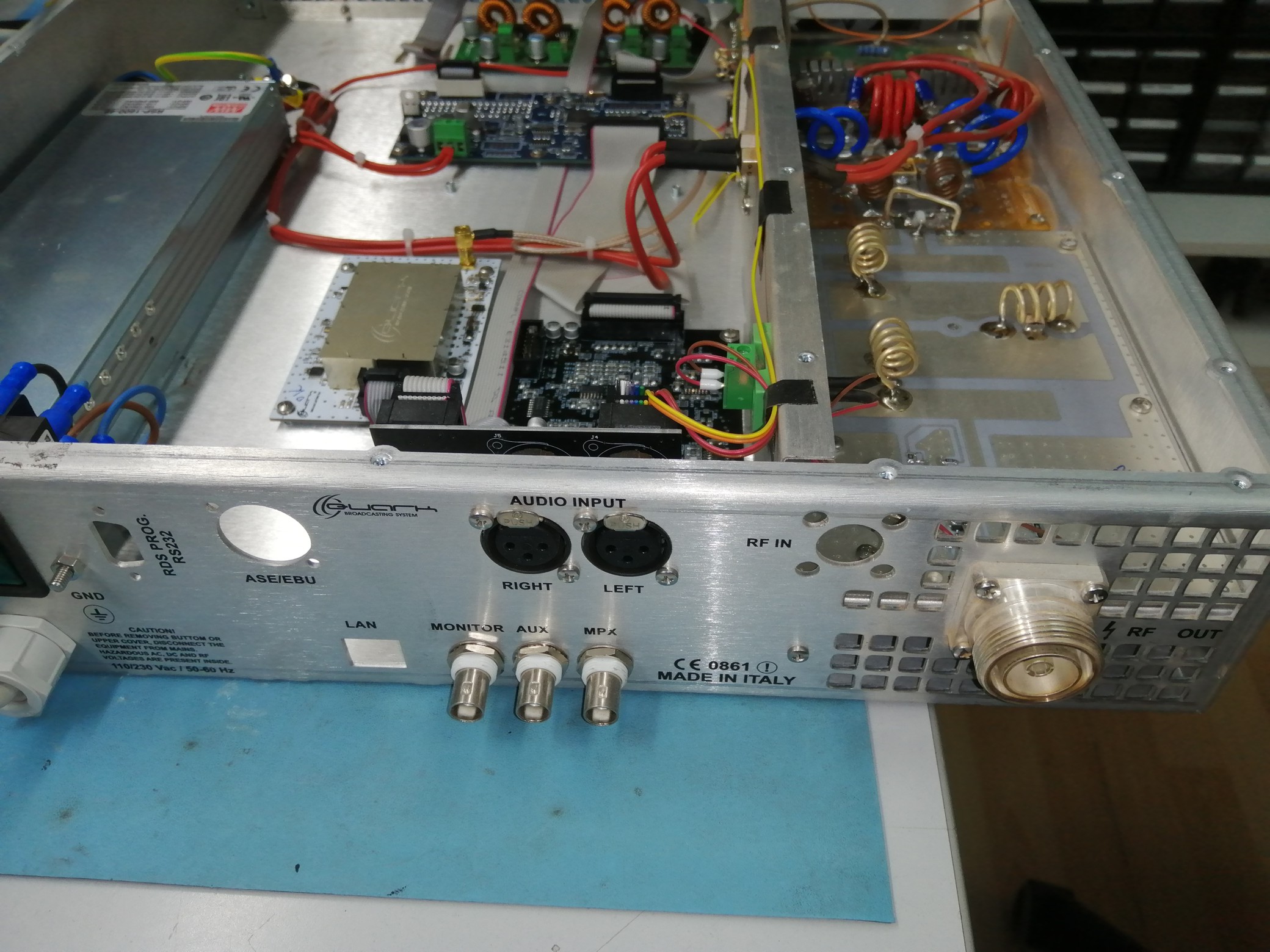

    Anyway a couple days later they brought me the whole transmitter and say it still doesn't work and the ALARM LED is lit.

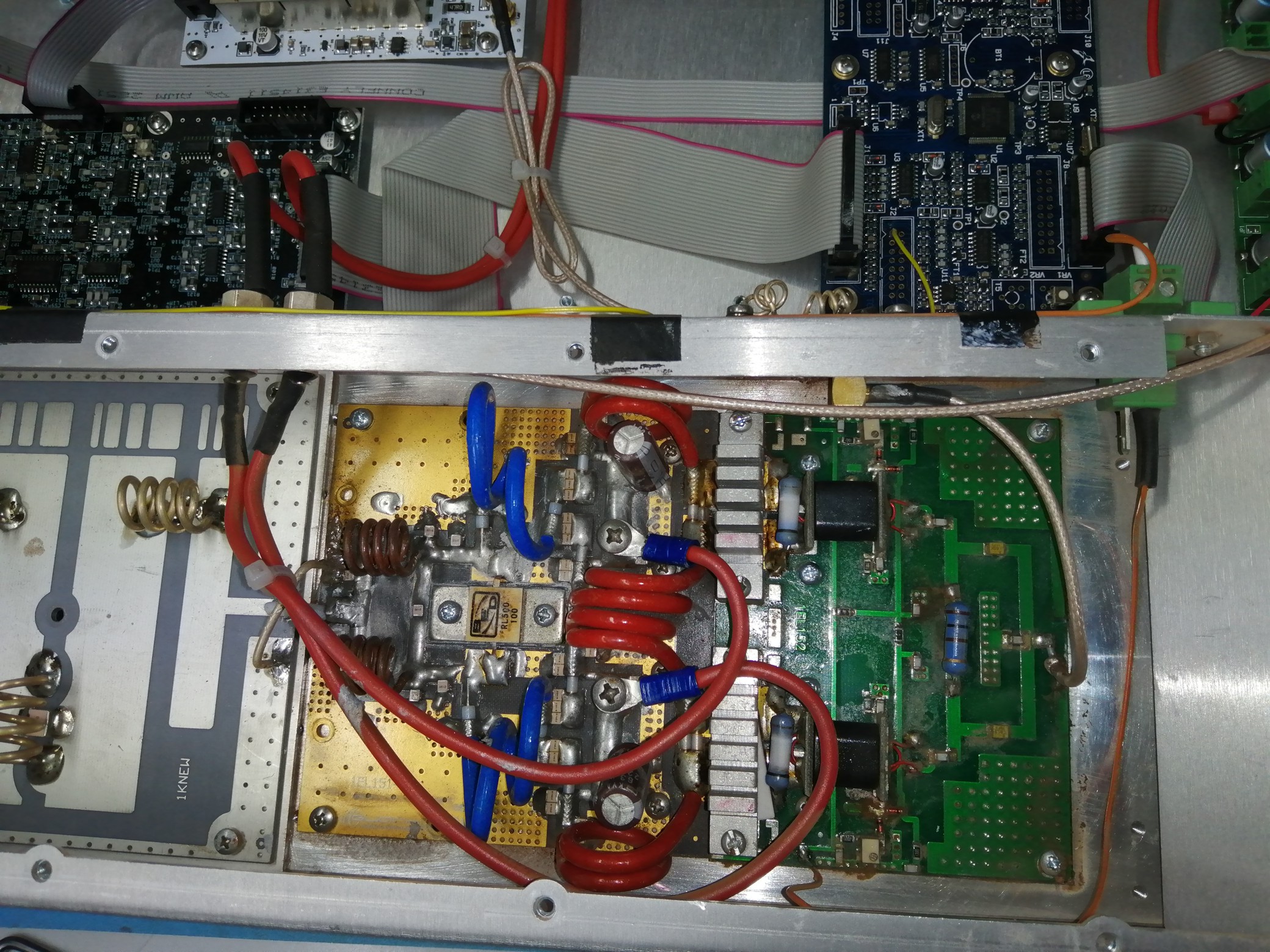

    There are two resistors near the front of the Power Output PCB that look like they run so hot I can't even read the markings. They both read 0R6
    There is this device marked RL500 100 that I assumed was the output transistor but the datasheet says it is a Flanged Microwave Resistor
    https://broadcastconcepts.com/500W-100ohm-resistor.html
    Anyway it reads very low resistance
    Any ideas how I can proceed with this repair? It's outside of my knowledge zone. I only know I should need a dummy load as I used to repair CB radios back in the 80s

    The output transistors are likely under the two heatsinks next to the heated resistors. A dummy load would be required to check it, you should be able to turn the power output down in the menu so you don't need a 1000watt dummy load, the station should have one. It could be that the alarm signal is due to a antenna/transmission line problem and not the transmitter.
    I don't have access to any manuals so I don't know what the alarm would be for.

      disconnect the PA stage and check how much rf power you get at the pre driver, then the driver stage. broadcast transmitters go off the air if there is an alarm on the front panel and stay off until someone clears it. probably lightning killed the PA. The radio station owner / engineer should have software + manual to program the transmitter and you are going to need that.

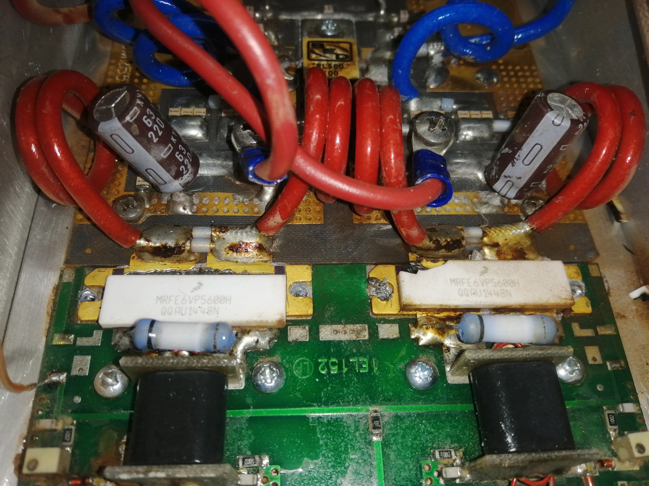

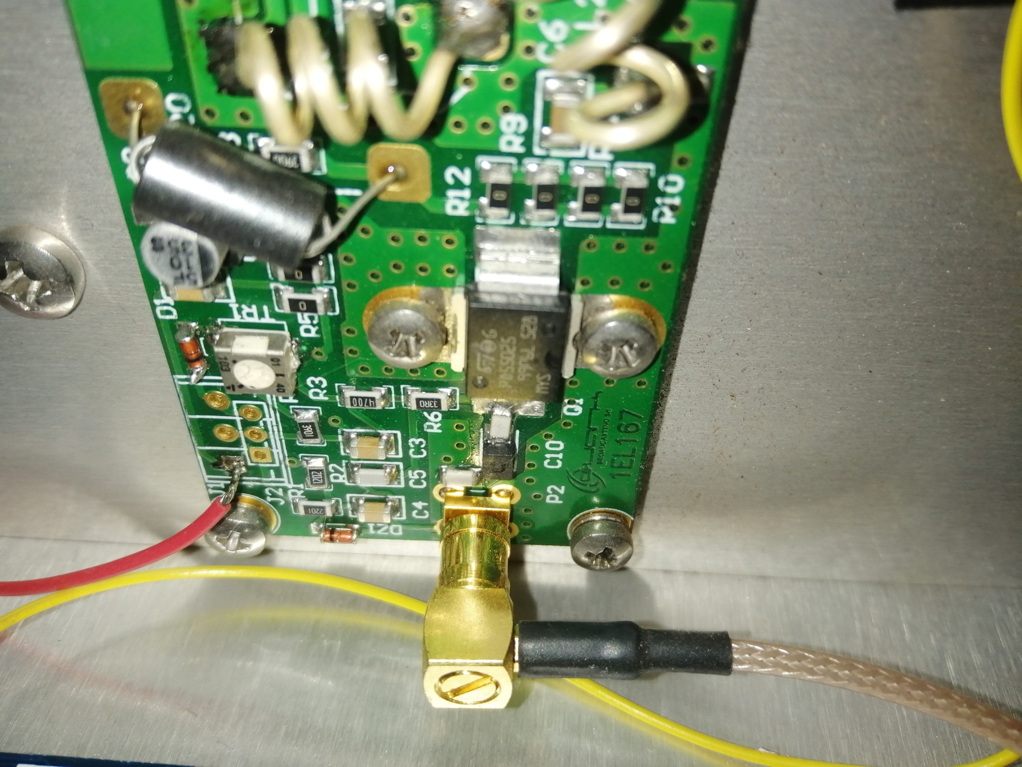

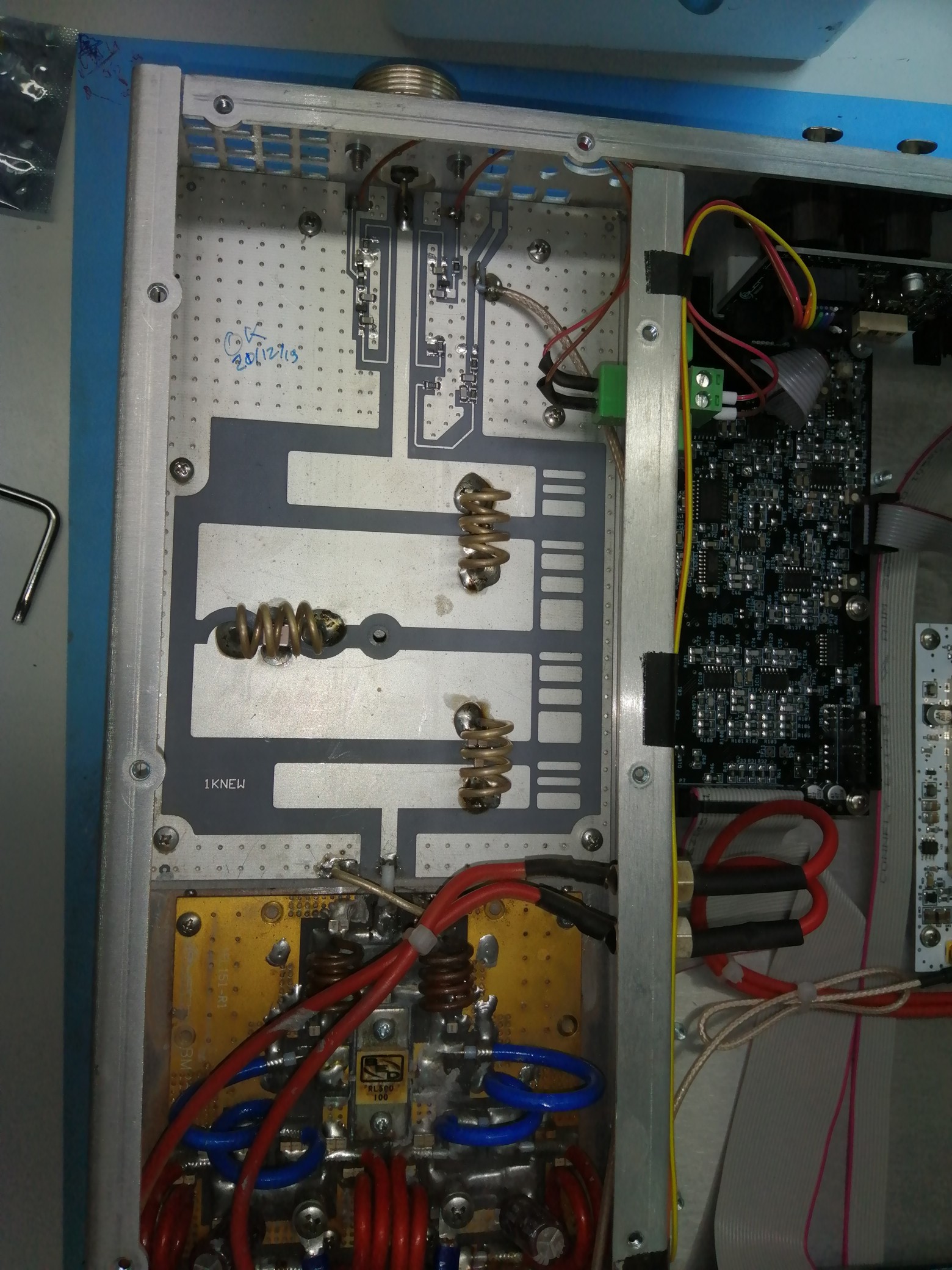

                      Yeah - the driver stage output FET PD55025 looks OK, or at least it isn't reading short
                      One of the PA output devices looks rather like it has seen better days!
                      mrfe6vp5600hr6
                      Pics...

                        Oh!! The other one doesnt look too clever either!

                          well, i guess you found the problem! these are about CAD$ 180 each! mouser has em. Did you try to take these rf transistors out, or did someone else monkey around with it before you got it? post 1, pic 5.

                            No I didn't try to desolder them and the self tapping screws through the top heatsinks into the bottom heatsink were quite tight and I don't think they have been removed before, but really, who knows the history of this thing???
                            Yeah I have seen the price of those output devices, though I suspect that is only 10% or less than the cost of a scrapped 1KW FM radio transmitter, even with my repair charge on top.
                            Having said that, two things worry me about taking this repair further:
                            1. those things don't look easy to rework/replace because of the amount of heat I would need to get into them with my hot/air and T12 - plus it looks like there are these two coax type cable coming off the arse end of them and I worry they may melt? But I suspect the advice/expertise is here on this forum to get around that problem
                            2. Even if I can rework them - why did they self destruct in the first place? Also I would like to know the correct value for those two overheated 2Watt-ish resistors next to the output devices.

                              I think you need more power than a t12. you could cut the main transistor out, just leaving the legs. Then unsolder one remaining leg after the other.
                              Here is a critical part / advice: When you do put the new RF transistors in, you have to mount them down with screws FIRST before you solder them. If you do solder them first, then mount them to the heatsink, you run a high chance of splitting the new RF transistors, popping the white cap off.
                              Why they distructed first place? Lightning, high swr, running too hot, bad coax, etc.
