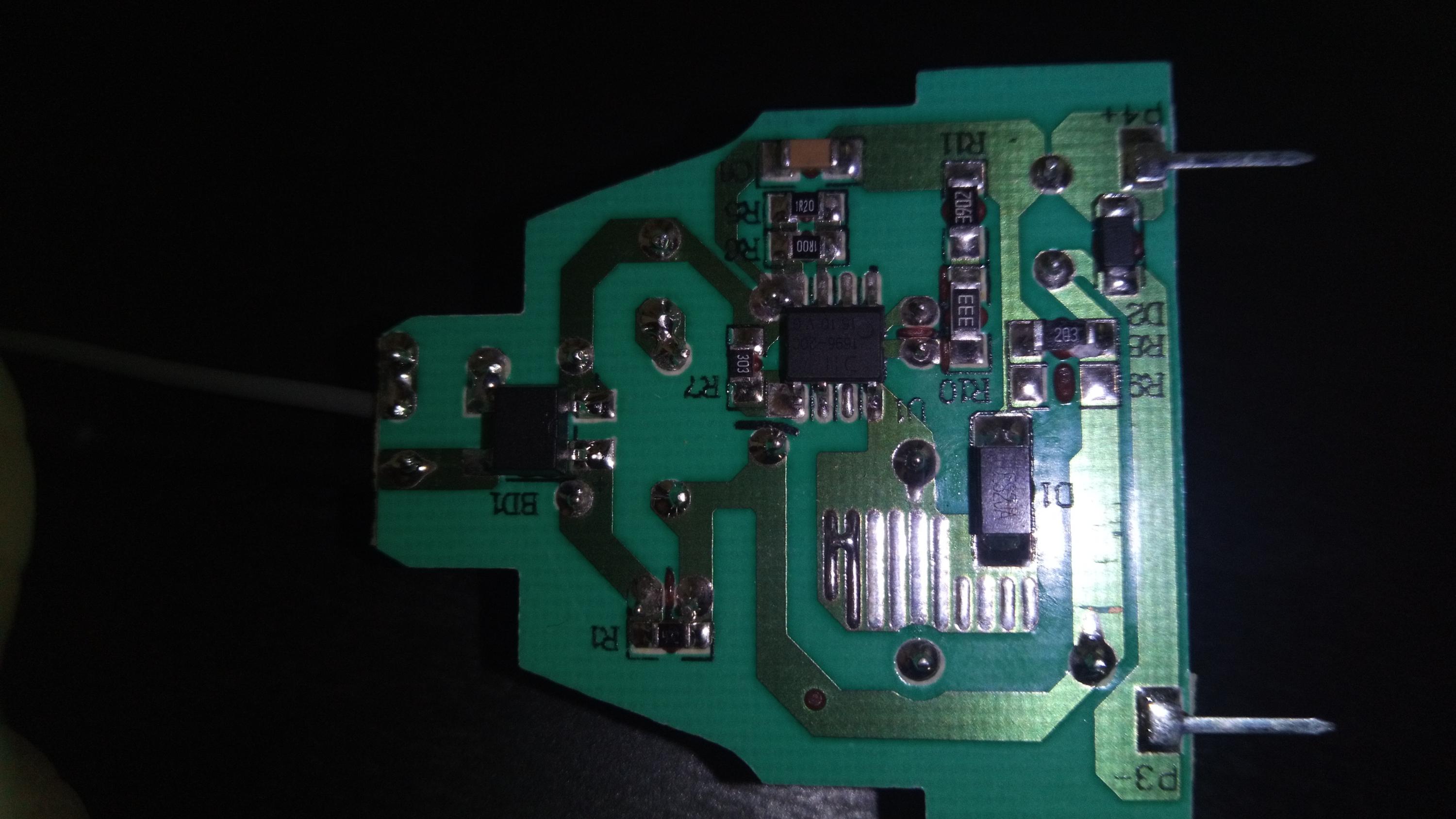

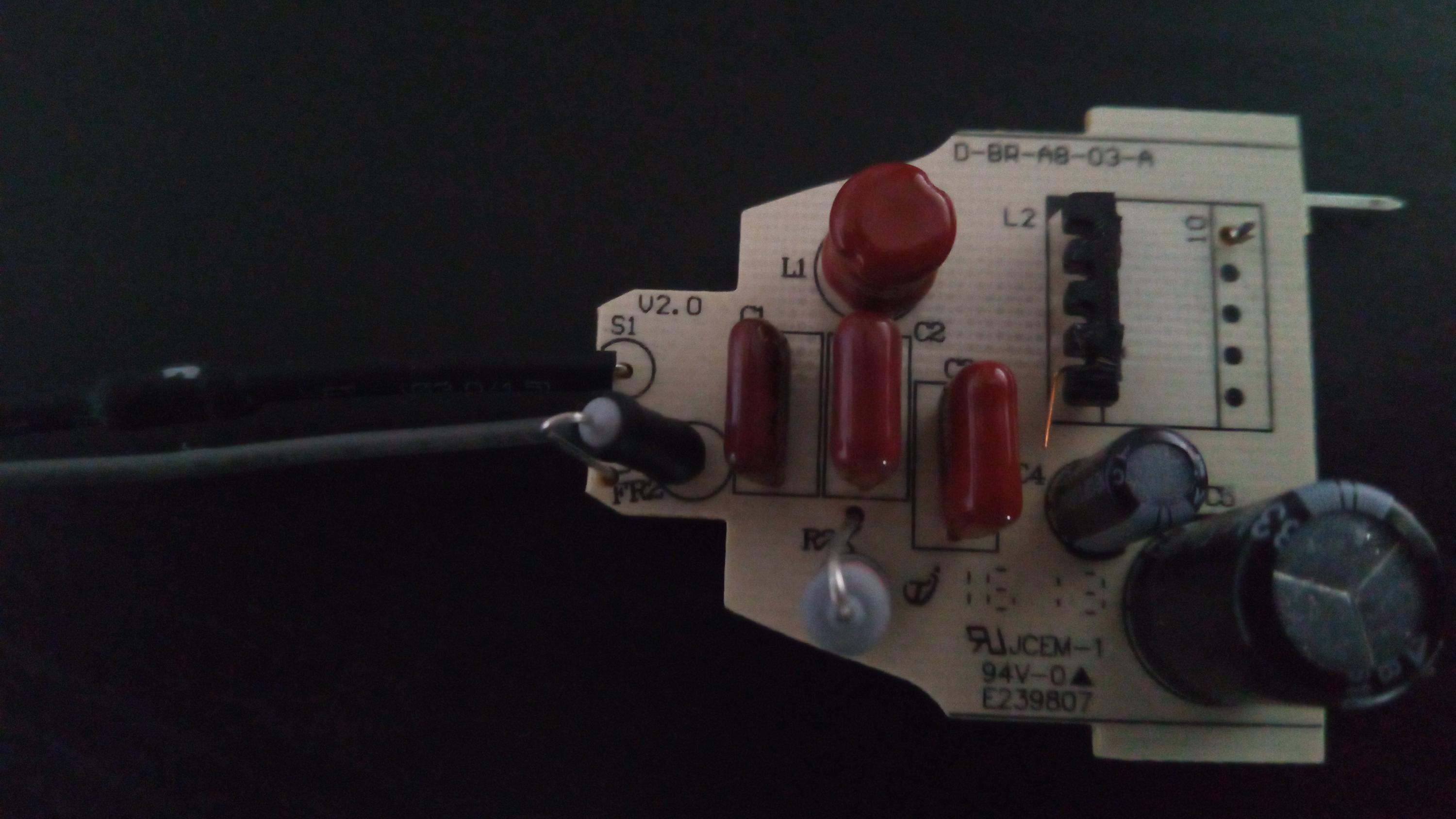

                          Anyways, I tested the LEDs on the board of the lamp, they're 6V LEDs! So two chips per I assume? I put 7v across one and it went to full brightness immediately (by this, I mean the chip was absolutely blindingly bright.)
                          So x6 chips equals about 32V that this would've been running at. None of the LEDs drew excessive current going through my meter, so I'm going to rule that out.
                          Also, as you said before, the LEDs could've been shorting causing the resistor to go bad, the only problem I have here is the resistor is the size of a quarter watt SMD resistor, and it's on the + side of the rectifier, going straight to the capacitor, and then to the output. I think that's probably wayyyy too small for a job like that. I keep forgetting to upload pics, therefor right after I post this I am going to upload some.
                          Edit: added pics

                            • 31218
                            #33
                            Re: EcoSmart 5csbr650stq1d03 LED light
                            R1 is burned, interesting the board can take a parallel pair.
                            i wonder how many franctions of a cent they saved by only fitting one!!!
                            • jazzie366
                              • May 2016
                              • 304
                              #34
                              R1 is what failed. If there were two, they probably wouldn't have had this problem.
                                I know I've done that mistake too when I first got into electronics, so I'll try not to be too harsh here but........ seriously, you don't connect LEDs to a voltage source with unlimited current capability. Period.
                                If you don't have a variable current source, use a resistor with a voltage source. It takes all of 20 seconds to run through a simple Ohm's law calculation to determine what resistor you need. Otherwise, you risk burning your LEDs or severely shortening their life. Depending on the current capability of your source, sometimes even a split second is enough to nuke the anode's wire bond on the die.
                                Interesting design. That resistor is NOT what is providing power to the LEDs. Inductor L2 does, which is connected in parallel with R1. Most likely they placed R1 there to limit inductive kickback spikes from L2 as the PSU switches. But that's a very poor design. Should have used a diode or a snubber network for that.
