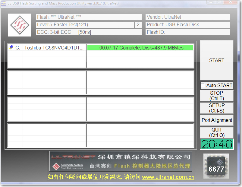

                      It can be tested from the software on post #9...currently doing....in progress...
                      I'll post the result..
                        Re: USB flash drive question ?
                        result :
                          Fixed already, can be formatted to FAT32 now ...thanks a lot

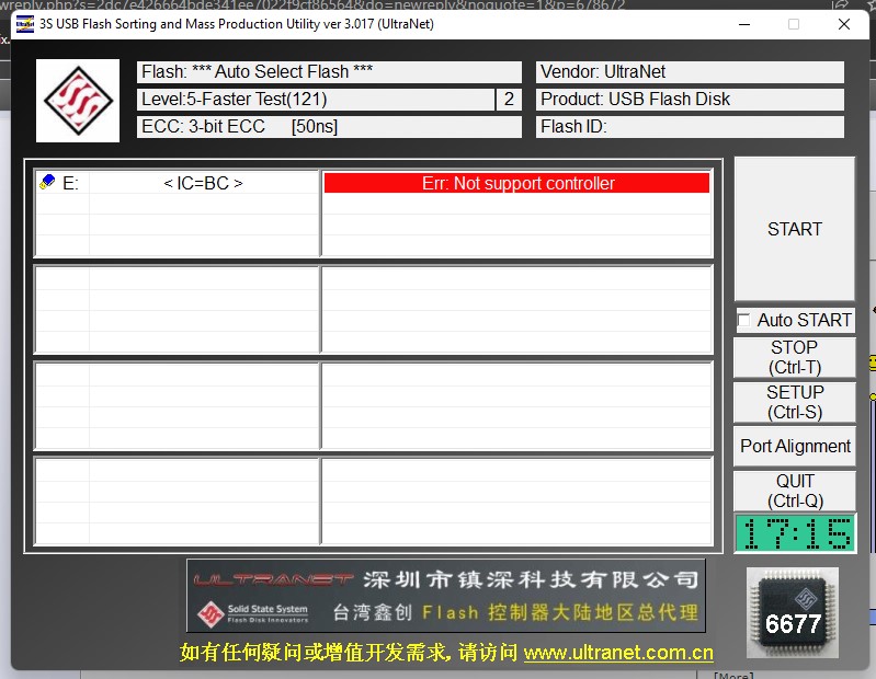

                                TC58NC6625G6F
                                NNP892-100BA
                                1446TT
                                TOSHIBA F J6108
                                TAIWAN 1438 9 A E
                                TC58TEG7TDKTA03
                                USB Device ID: VID = 0C76 PID = 0005
                                Device Vendor: GENERIC
                                Device Name: USB Mass Storage
                                Device Revision: 0100
                                Manufacturer: GENERIC
                                Product Model: USB Mass Storage
                                Product Revision: 1.00
                                Controller Vendor: Solid State Systems
                                Controller Part-Number: Unknown - 0xBC
                                Flash ID code: 983AA8927650 - KIOXIA TC58TEG7TDKTA00 - 1CE/Single Channel [TLC-8K] -> Total Capacity = 16GB
                                PLZ PROVIDE INI FILE FOR THIS
