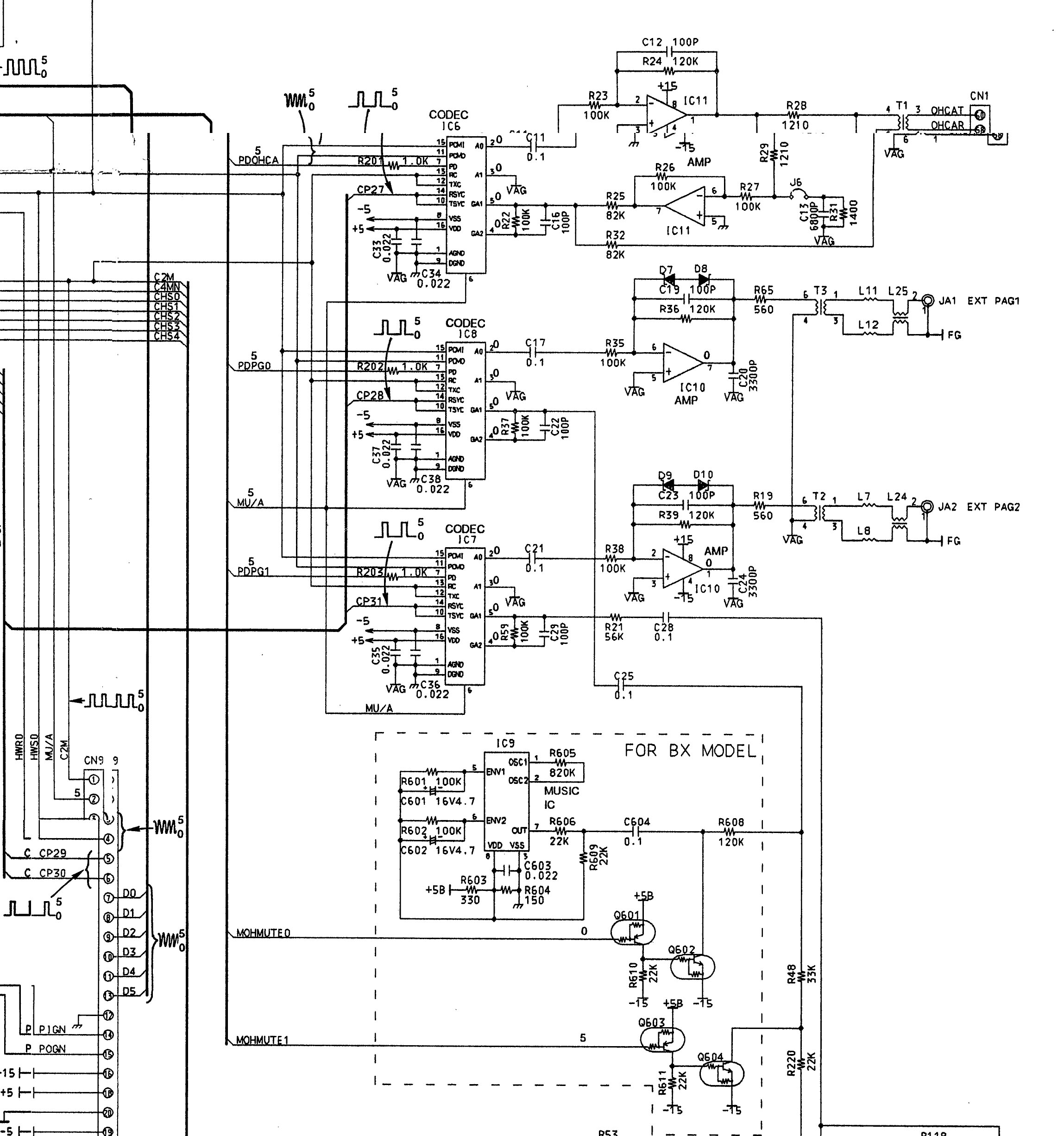

      Just replace ic 6,7 and 8 on CPU.
      Nose goes out.

          I confirm solution with noise that emiliovilla suggested fixes the problem.
          Part number for ICs is MC145503P.

            Thank you, Emiliovilla. Looking a bit closer, it looks like these IC's are codecs which interface the CPU with the "outside world". Here is a data sheet on the IC's:
            I noted the warning in the data sheet to keep i/o pins from swinging beyond the power supply rails. Operating as interfaces, the chips are likely to be vulnerable to external disturbances. I wonder if adding some TVS diodes or gas tubes near the transformers would protect the codecs?
            It would also be interesting to know if all 3 chips failed, or if the symptom can come up if any one of them fails?

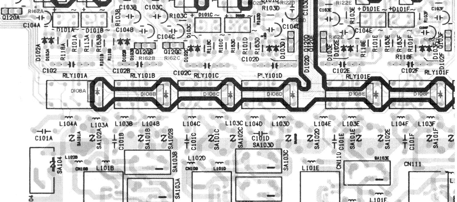

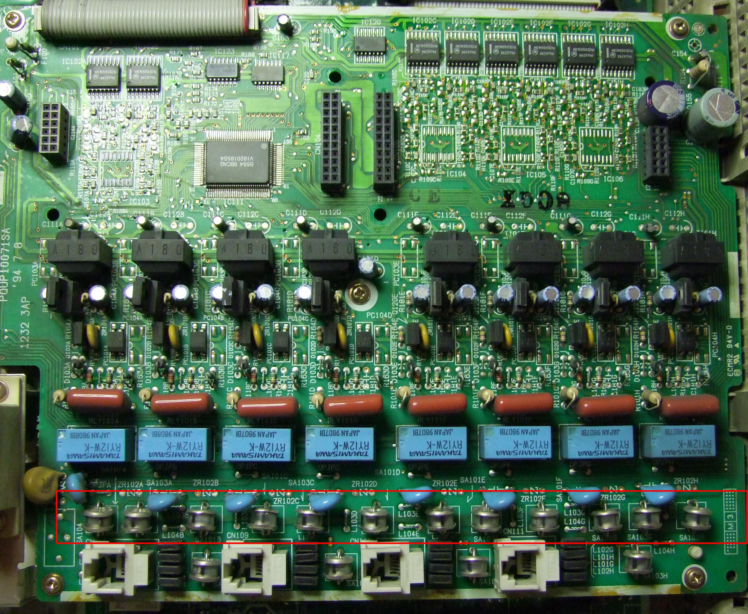

              The very first problem with the PBX appeared after some water from an A/C dripped on the PBX and all 8 CO stop working and appeared busy. However at that time there was no other problem.
              The noise problem was definitely evolving as first set of 8 EXT had the problem, after some time all other extensions had the same noise problem and in "hold on" music.

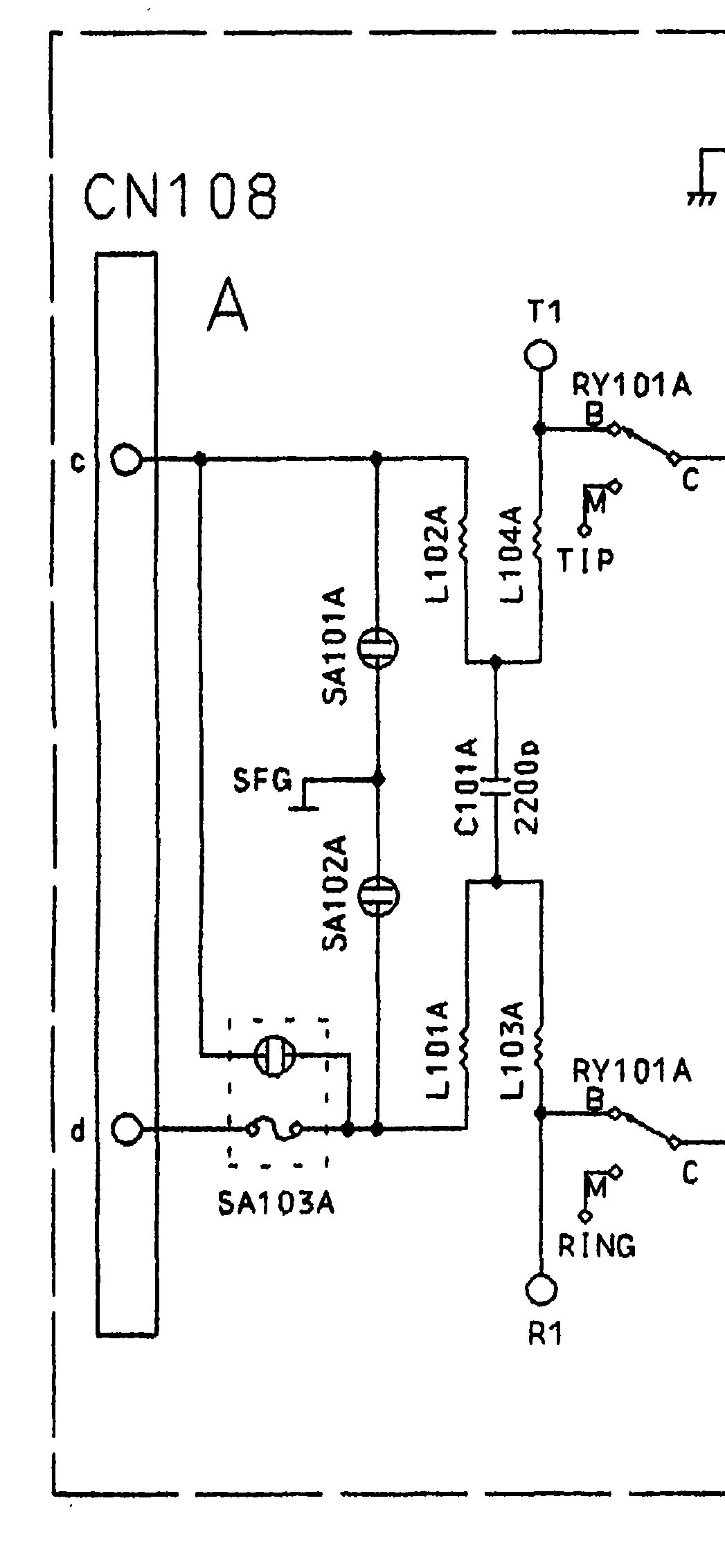

              Now about the protection, there are some tube like components which i cannot recognize only on CO card. But these do not exist in EXT cards.
                Re: PANASONIC KX-TD1232 CE - PBX hybrid - Dial tone problem
                Those are Gas discharge tubes.
                I.E.
                http://www.littelfuse.com/products/g...rge-tubes.aspx

                  ...just chiming in with THANKS. Had this EXACT issue in double KXTD1232 cabinets. Replaced U6, U7, and U8 (MC145503P) - actually removed the chips, and put in sockets, THEN put in the chips - and the system is as clear as a bell.
                  Thanks to Sententia for posting the sound file, and thanks to Emiliovilla for the excellent solution!
